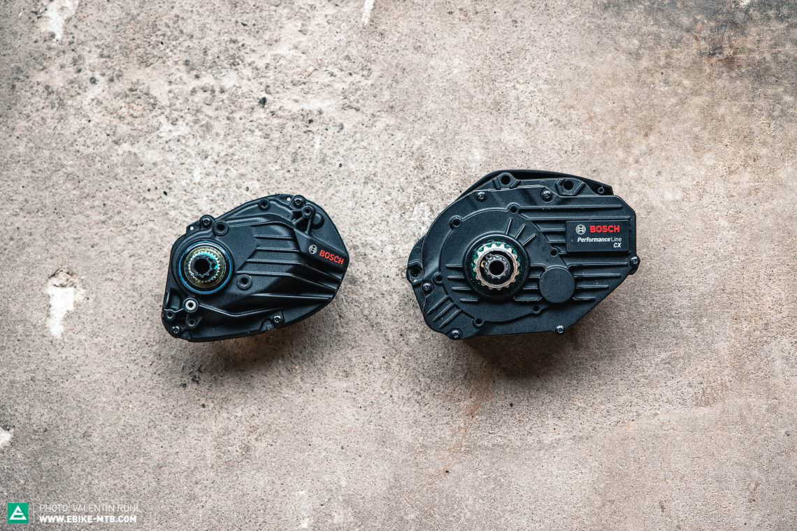

Good question. They call it the Gen 4 series and it is SMALLER than the previous ones but if you cannot tell by looking you should ask the dealer to show you the paperwork .View attachment 42901
First time poster here. I just ordered a Nevo GT Rohloff HS as a commuter bike. I've fronted the purchase price, it's being built for me and should arrive in May. I'm a big guy and will be near the weight limit for my short (five mile) but hilly ride to work. From the RM website, the bike will be built with the older series motor. Should I be concerned about that? Should this affect the price? My plan is to use the bike to mostly replace my car so I really want to get this right—for both the ride and my wallet. I've been very happy with my local store, Wheel and Sprocket in Wisconsin, in guiding my purchase. I will check with them about this also but I would appreciate hearing the group's thoughts. Thanks in advance.

Hello! There are many riders on this site with lots of mileage on the the Gen 2 CX motors. This is a tried and true product. The only thing I would be concerned about is the front suspension. My suggestion would be to get the Aion Air fork or better if it is not too late to upgrade. The NCX on my Nevo was not up to the job.
