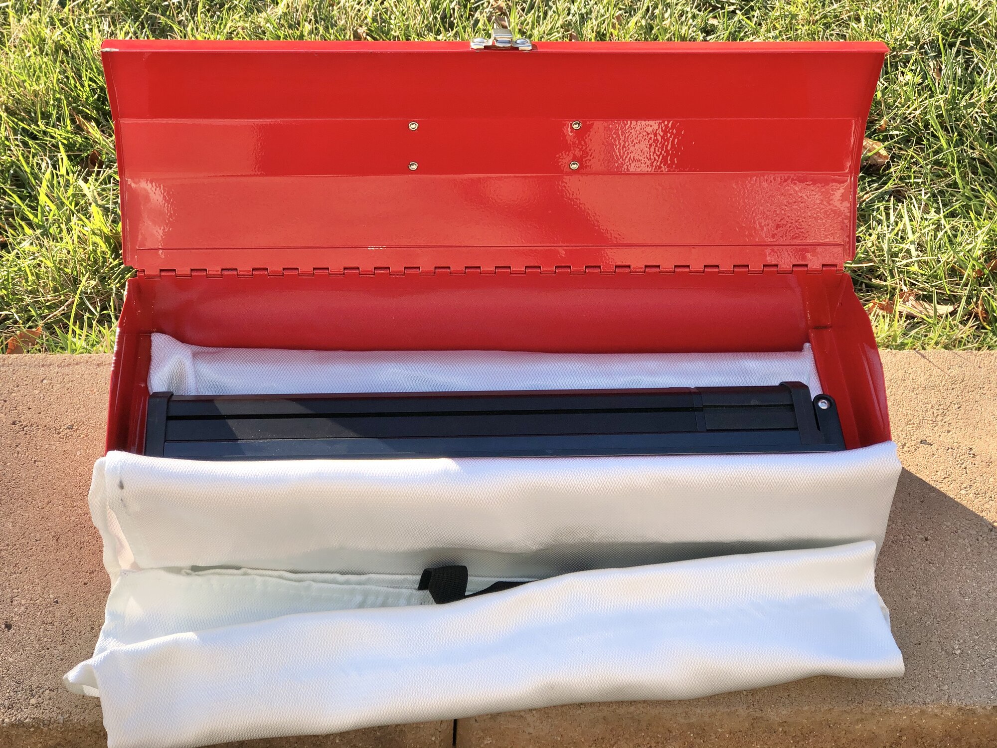

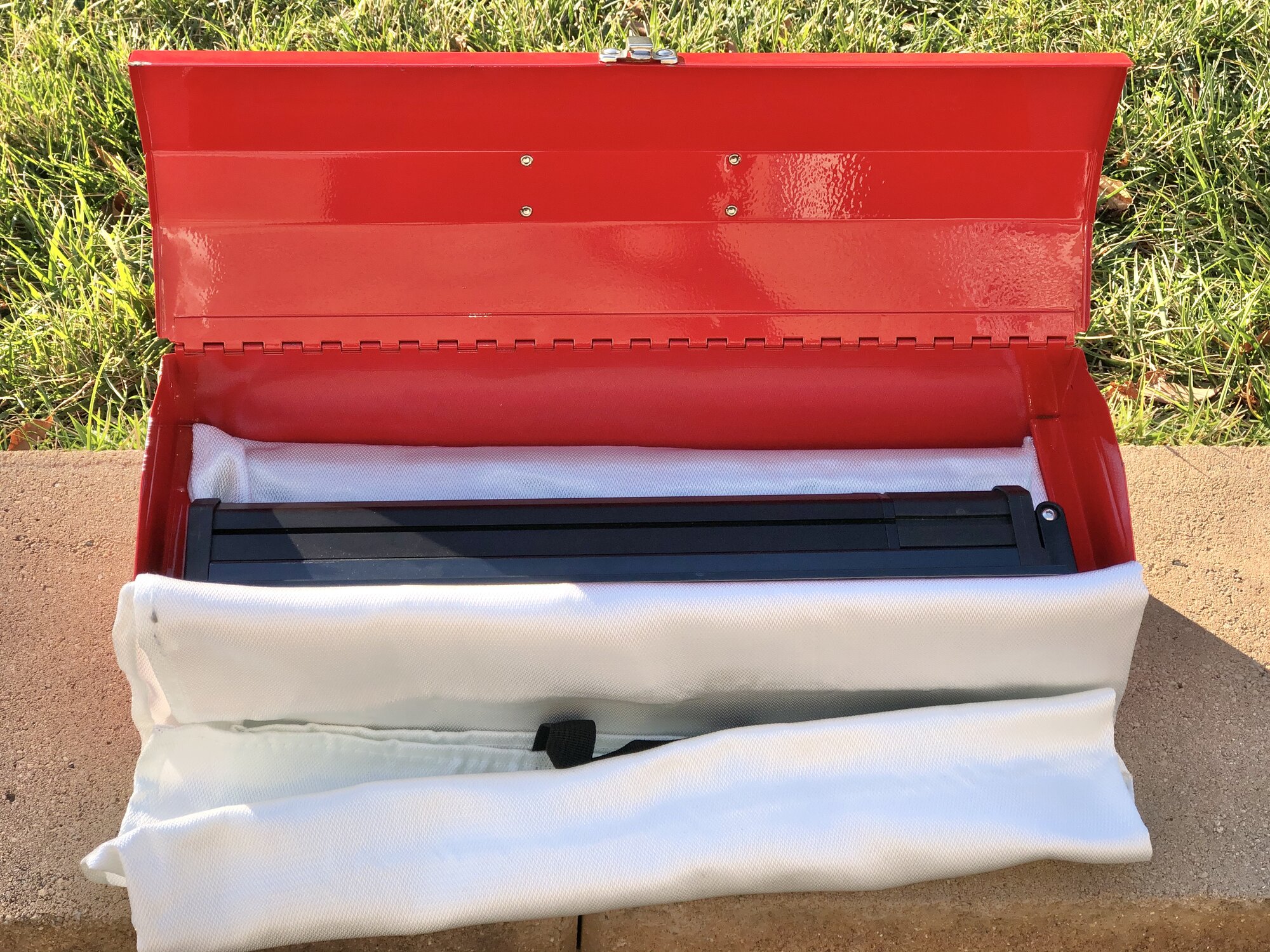

I have no idea about the bags but this is my method for transporting and sometimes charging. Two metal tool boxes with a fireproof fiberglass matting wrap for each. Holds two wrapped batteries each.

I have no idea about the bags but this is my method for transporting and sometimes charging. Two metal tool boxes with a fireproof fiberglass matting wrap for each. Holds two wrapped batteries each.View attachment 95589
Looks great for storage, but I don't think I'd charge in the box b/c of the insulation cutting off air flow that might cause overheating.
Needs vent holes to allow pressure to escape from an explosion otherwise you have created a pipe bomb. I am working on the same design now using that toolbox and a welders blanket with vent holes.
