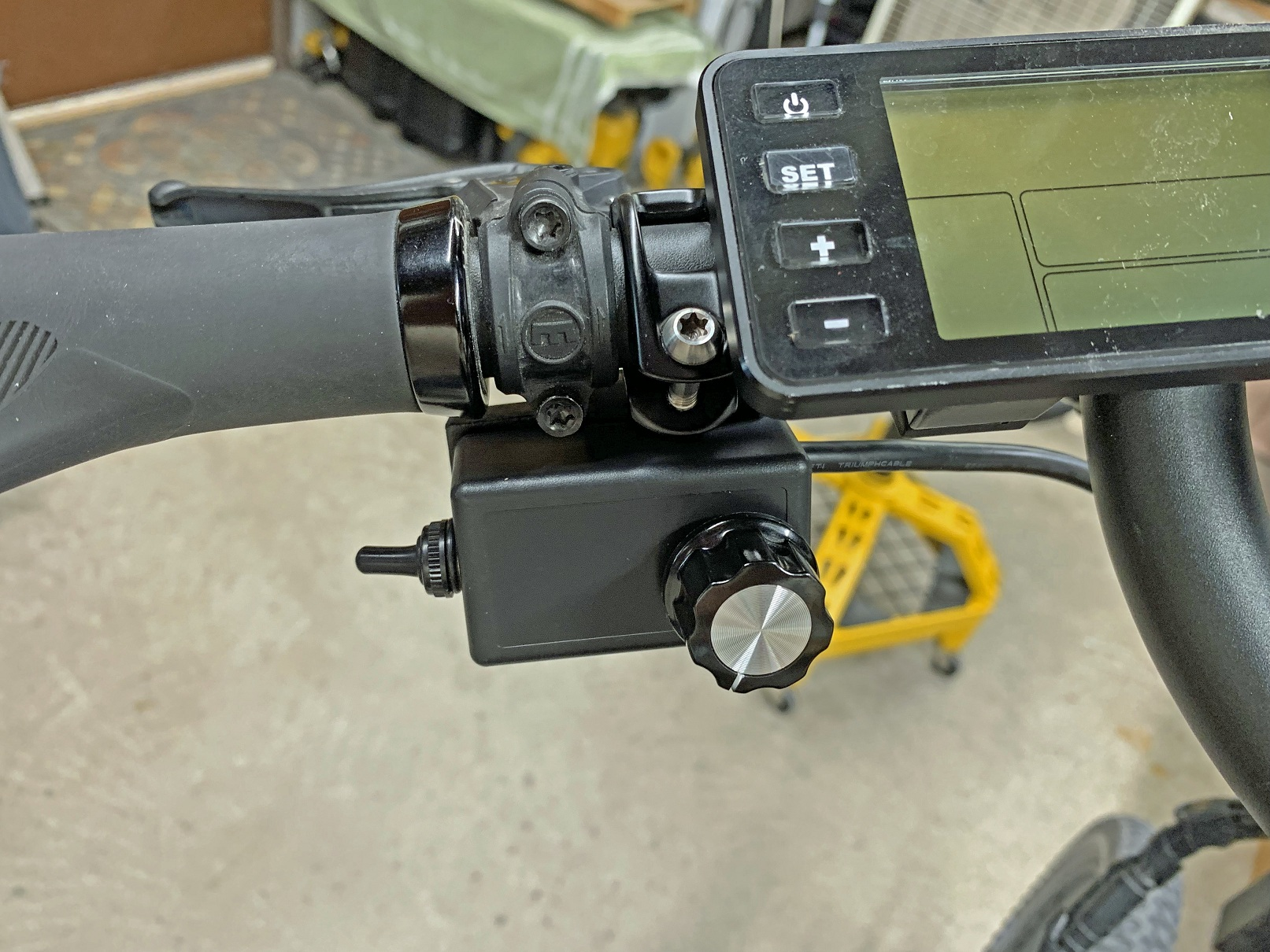

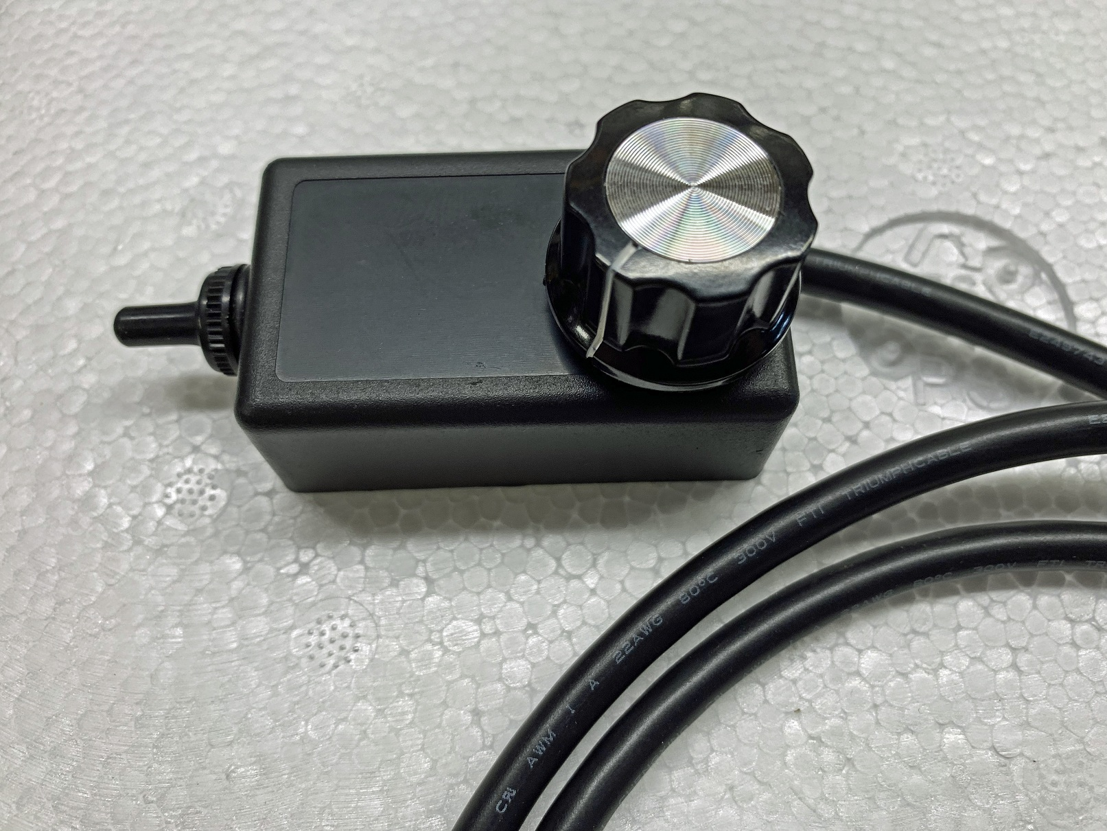

I understand and share your frustration with the throttle / PAS and torque / cadence sensor dilemma. I frequently ride with others and have a difficult time matching speeds. It seems every bike has different characteristics in this area, some good and some bad.
I'm a DIY'er and the fix for me was to build a control with a knob that lets you dial in any speed you want. I simply set the speed to match the others I'm riding with and apply the appropriate pedal pressure. In effect, I'm assisting the bike rather than it assisting me.
If you're handy with tools and soldering, you can make your own. Here's a link on how to build one:
