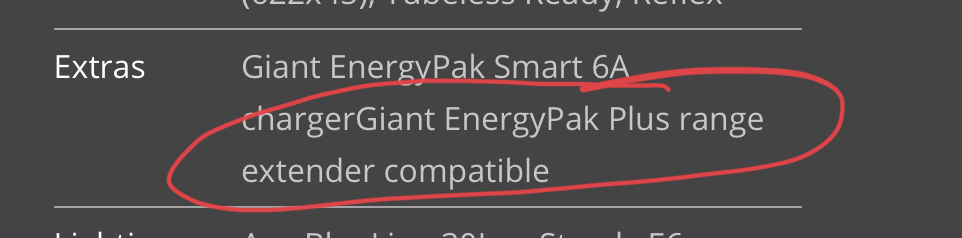

I am pretty sure the MY21 Explore (any model) doesn't support the "energy Pak Plus" Range Extender, if that's what you mean by "piggy back".
I reserve the right to be wrong, but I went down that road before and had to double check on the MY20.
The "EnergyPak Smart 500" is just the normal in-tube battery, which is an improvement from the MY20 375
I couldn’t say for sure but this is from the US and Canadian Explore e+2 and (for Canada) the Explore e+1 Pro specs.
Giant's Explore Pro 0+ was 500wh but it still had an optional add-on power pack. In 2021 Giant increased Explore Pro 1 + range by a huge increase to 625wh main and whatever add-on power pak.
