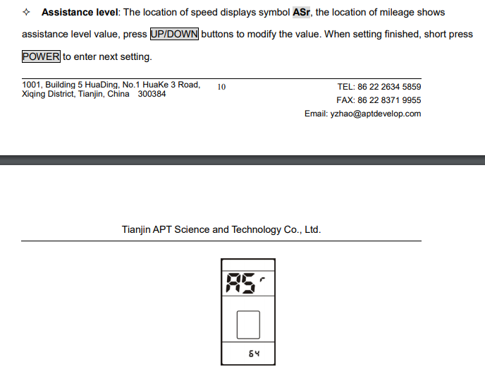

There is also a section to adjust the assist level but have no idea what it means because it only shows one screen:
Maybe that's how much assist each level will give after you reach the speed limit at that level? Maybe I'll play with it.

The description says:
"Assistant num represents the sensitivity of PAS settings. The sensitivity value is “5” to “24”.
And on KD218 display, is shows this in the manual:
It would appear to me that Espin is using more than 1 controller/display. That or I'm too stupid to figure out how to get to the screens shown above (post# 161). Our Flow has nothing like that, nor mention of anything like that in the supplied manual.
But what does "PAS Sensitivity" or "assist level" actually mean?
5 to 24 is also a strange range. I'll play with the setting if I can find it on the Espin and see what the range of the numbers are.
Such a weird name for a setting.

Assist level is about how much power is supplied to the motor for each PAS level. -Al
You could test the assistance level setting from one extreme to another (64?) and see if it looks like it's the same thing as "assistant number" on the other displays, which is PAS sensitivity (the KD218 shows it set to 48 in my screenshot above).
Is your display the same model as this one?
The display, when powered up, looks like that one. The difference, I believe, is illustrated best by the parameter flow chart on page 6 of that manual. The one I have starts at "Data Cleanup" but it ends at "Speed Limit Set". There's nothing beyond that. :mad:
Yeah, you may have to use the password to unlock it in order to get to all the different applications
