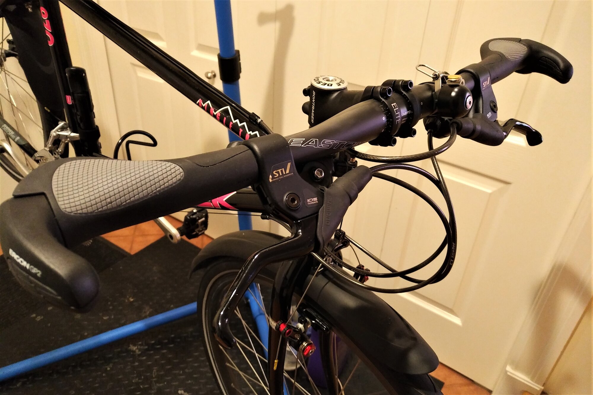

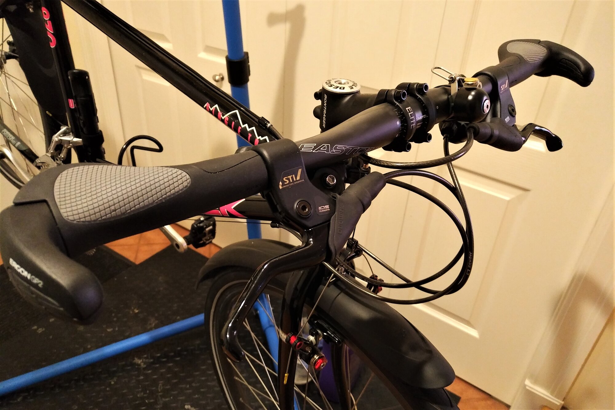

Thank you for your great tutorial and explanation on the Ergon grips it is quite useful. I have a pair on my bike And I really didn’t know the proper technique with three fingers as you explainedIn the self-styled way, I acclaim the Ergon GP3 the best bike grips ever made!Some tips will follow:
Proper Setup
First of all, the GP3 come in two sizes. Buy the Large variety only in case you have really large hands. The Ergons might be too wide to fit your gadget-crammed handlebars, and it is also better not to change the brake lever position. If you still see the yellow interior of the grip after you have slid it fully onto the handlebar, you need to shorten the grip. Use a very sharp knife to shorten the grip -- and be cautious to not cut your fingers! (You have been warned)No yellow part should be visible with the properly slid grip. The wrist supports should point slightly upwards. Add the bar-ends. The angle is your choice, with 30-45 degrees being the most reasonable. Tighten the screw at 5 Nm. Again: No yellow part should be visible inside!

The "steering-wheel" or "trail" hand position. That's what makes the Ergons so great. You delicately rest your three fingers on the bar-end, while your thumb and little finger ensure a proper hold. You steer your e-bike as you were operating your car's steering wheel. That hand position is proper for very long rides and ensures the best control over the bike even in very rough terrain. The benefits:
I just want to tell you that I ride over 90% my long trips in the "trail" hand position. Specifically, uphill ride is extremely easy with that hand position. Note: You can move your hands to the "safety" position instantly, as the bar-ends are small.
- The hand doesn't get tired or numb (people with carpal tunnel syndrome will be delighted)
- You exercise the perfect control over your bike, especially with wide handlebars
- In rough terrain, you just tighten your grip a little bit for even better steering control
- During "washboard" sections of gravel roads, ease the hand-grip. The bar-end will travel vertically among your fingers, providing rapid-vibration protection to your hands -- especially, owners of rigid-fork e-bikes will be happy!
The "Easy Rider" hand position. Use on a very long ride in safe environment when you are really tired. Rest your wrist and thumb on the wrist-support. The part of the palm near to the little finger shall rest where the bar-end-plug is normally located.

All modern flat handlebars have the tube diameter of 22.2 mm at the grip section (+/- machining tolerances). For this reason, Ergon doesn't even need to give the diameter info. Yes, these grips will fit and Mulezen has confirmed it for the Allant+.Ok so I decided I’m going to purchase the ergon gp3 bar ends. Just to confirm Stefan , these are compatible with my trek allant 8s?
Should I get the small ? Not sure how to measure my hand. My frame is size medium and I’m basically courts height and weight.All modern flat handlebars have the tube diameter of 22.2 mm at the grip section (+/- machining tolerances). For this reason, Ergon doesn't even need to give the diameter info. Yes, these grips will fit and Mulezen has confirmed it for the Allant+.
