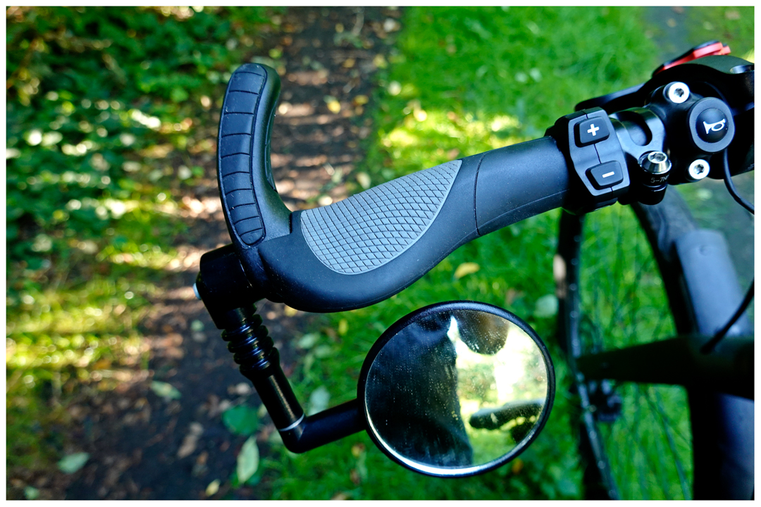

First of all, the GP3 come in two sizes. Buy the Large variety only in case you have really large hands. The Ergons might be too wide to fit your gadget-crammed handlebars, and it is also better not to change the brake lever position. If you still see the yellow interior of the grip after you have slid it fully onto the handlebar, you need to shorten the grip. Use a very sharp knife to shorten the grip -- and be cautious to not cut your fingers! (You have been warned) :) No yellow part should be visible with the properly slid grip. The wrist supports should point slightly upwards. Add the bar-ends. The angle is your choice, with 30-45 degrees being the most reasonable. Tighten the screw at 5 Nm. Again: No yellow part should be visible inside!

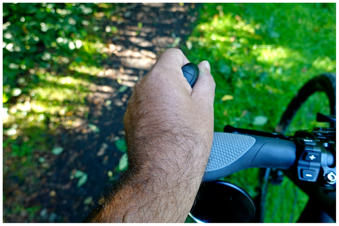

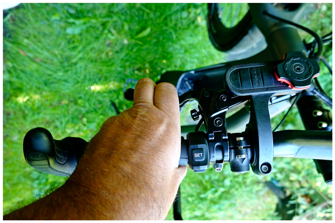

The "normal" or "safety" hand position. Use it while riding with traffic or on crowded bike or multiple-use paths.
Modern e-MTBs sport the "1-finger" brake levers; modern commuter e-bikes have the "2-finger" brake levers. Never place more fingers than necessary on the lever. While riding in a crowded area, rest your finger(s) on brake levers in a relaxed way; you don't want to make your fingers tired but you might want to brake rather fast.
The "steering-wheel" or "trail" hand position. That's what makes the Ergons so great. You delicately rest your three fingers on the bar-end, while your thumb and little finger ensure a proper hold. You steer your e-bike as you were operating your car's steering wheel. That hand position is proper for very long rides and ensures the best control over the bike even in very rough terrain. The benefits:
  • The hand doesn't get tired or numb (people with carpal tunnel syndrome will be delighted)
  • You exercise the perfect control over your bike, especially with wide handlebars
  • In rough terrain, you just tighten your grip a little bit for even better steering control
  • During "washboard" sections of gravel roads, ease the hand-grip. The bar-end will travel vertically among your fingers, providing rapid-vibration protection to your hands -- especially, owners of rigid-fork e-bikes will be happy!

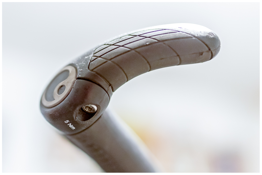

Can someone tell me how to adjust the grip part ( not the bar end). My grip on the left isn’t exactly on the same parallel axis as the right hand side grip so my left hand is angled a couple of mm lower than my right when riding.The grip on the right is exactly how I like it , parallel to the ground. Been meaning to adjust this lately and figured I’ll get it done now that rain is in the forecast for next few days.
Do I have to remove the bar end part first or simply loosen it and then adjust the grip? When I purchased these I had the LBS install them. Any help much appreciated.
There is only a single bolt per a grip serving both the grip and bar-end. Loosen delicately until you can rotate the grip itself. Re-tighten with feeling.

The bolt tightens the main grip clamp but also allows rotating the bar-end.
