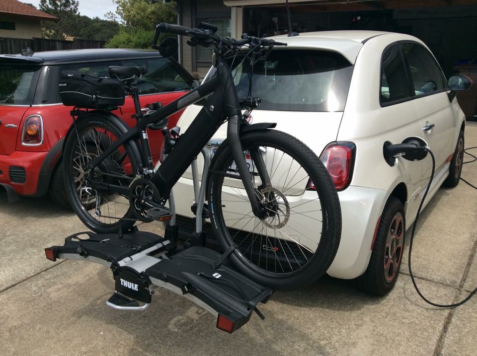

Just installed the Thule EasyFold 9032, a hitch mounted platform carrier rated to carry two 66 lb eBikes. It comes with a ramp to make it easier to get a heavy eBike onto the platform. Self locking clamps for the bike frame, ratchet straps for the wheels, and a self lock for the hitch mount.
The Thule runs $700 and will only carry 120 lbs.(2 bikes total) ....yet Brian says his Dash weighs 62 lbs.

Just installed the Thule EasyFold 9032, a hitch mounted platform carrier rated to carry two 66 lb eBikes. It comes with a ramp to make it easier to get a heavy eBike onto the platform. Self locking clamps for the bike frame, ratchet straps for the wheels, and a self lock for the hitch mount.View attachment 3068
It's very impressive, but I believe that would have to be 1 1/4 inch hitch receiver. My concern would be what they call the 'tongue weight'. The Thule is heavy, and the bike is heavy, so you may be around 130 pounds directly on the hitch. The tow weight is different from the hitch weight.
My guess is that two bikes would be a little iffy. Not sure what kind of car that is. Not sure if the hitch was 'factory', or what the tow rating, tongue rating are. Small cars often have no tow rating, but you can buy aftermarket hitches. It's not ideal, so I will assume you are going by the 'book' for your car.
There is an adapter to allow both size hitch receivers. I have a Curt hitch installed that is rated at 200 lbs tongue weight. The car is a Fiat 500e.
@Brian Lee ... How wide does the clamp that secures the bike frame open? Would it fit around the section with the battery? If you look at my avatar, you will see that I don't have a crosstube and not much space on my seatpost tube.

No, I don't think the clamp will open wide enough to accommodate the downtube carrying the battery. I clamp it to the top tube or the seatpost.
