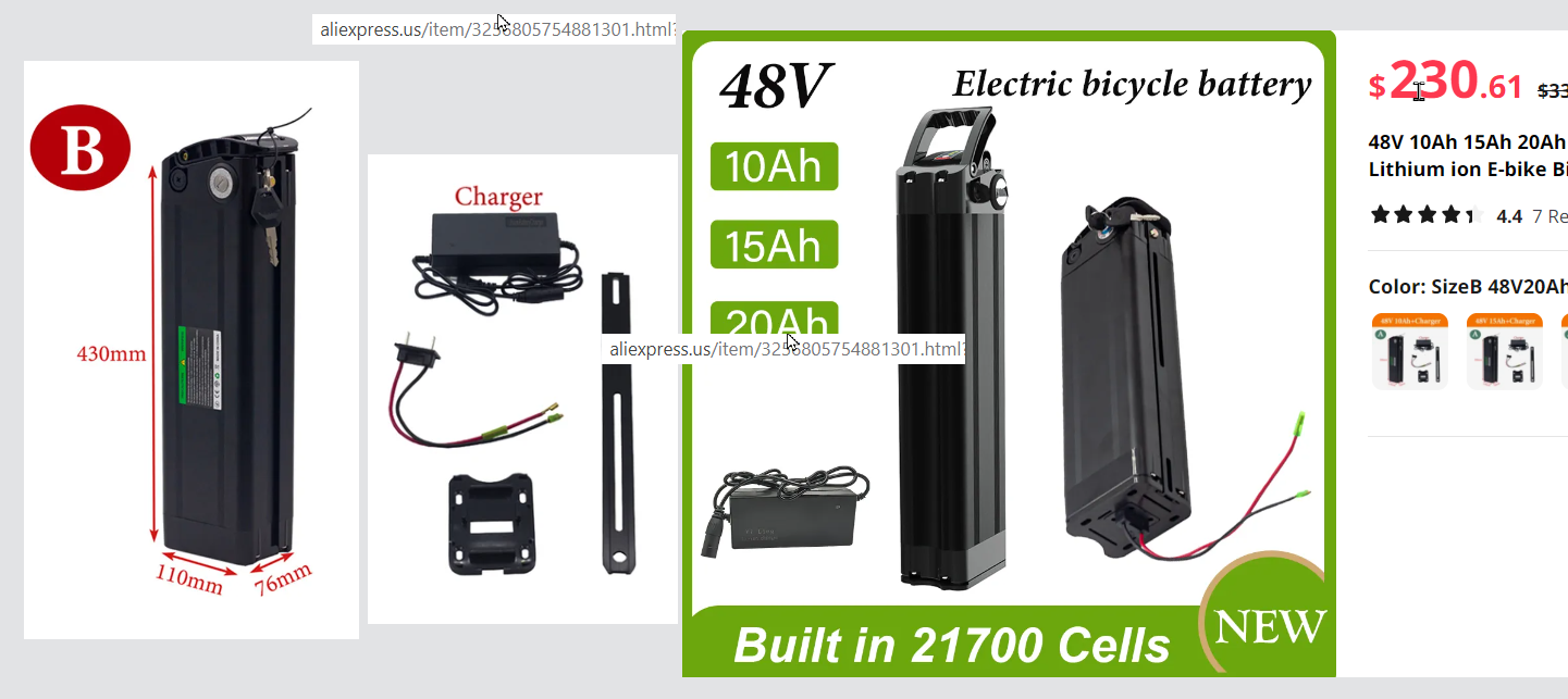

I am no electrician, nor mechanic and I am not giving advice but I appreciated this post and a few others on the upgrading of the battery for my Ecotric Hammer from a 12.5 Ah battery to a 20 Ah battery. I needed more range and Amp Hours seems to be the only way. I couldn't find anything but this: https://www.aliexpress.us/item/3256805754881301.html (the B (430mm) 48V 20Ah version). I took a chance and it arrived in less than a month. It came with a little different guide rail, base, and plug. After charging (needed a converter: https://www.amazon.com/dp/B08P2HT2N7) and after a little adjusting to get base, rail, lock pin, etc. aligned it worked. So far it looks very promising to add range. I can update my experience as I go if anyone is interested.
UPDATE : Well, it's winter so haven't ridden with the new battery much but I did make a long trip and it seems a little better than the stock battery and I have had no problems. It was pretty cheap and though I can't swap the batteries with the other ones quickly, all in all good so far. Hopefully when it gets warmer I will get more range. All in all, so far so good, just not all the extra range I was hoping for but my other battery was tired so it worked out well enough for me.
Well, it's warming up and the battery is holding up. Nowhere near the performance jump I was hoping for going from 12.5 Amp Hours to 20 Amp Hours but seems a pretty solid battery so far and better than the other two @ less than half the price. Now we'll see how long it lasts.
