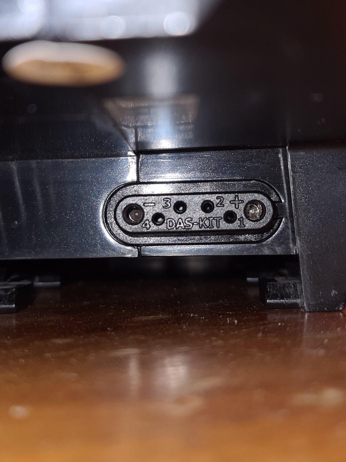

Has anyone had experience with changing the brake sensors on an Ncm bike? I have ncm prague and my engine is not getting steady power supply because of the ebrake cutting the power off. This started happening after I adjusted my rear cable brake

Hi, thanks for your reply. Yes, I meant the motor inhibitor in my initial question. But since 8ththen I found that there's a loose connection between my battery and the bike. I'm guessing the prongs on the battery are not aligning withthe bike. Do you have any idea how to tighten them?
Here's how it looks like
