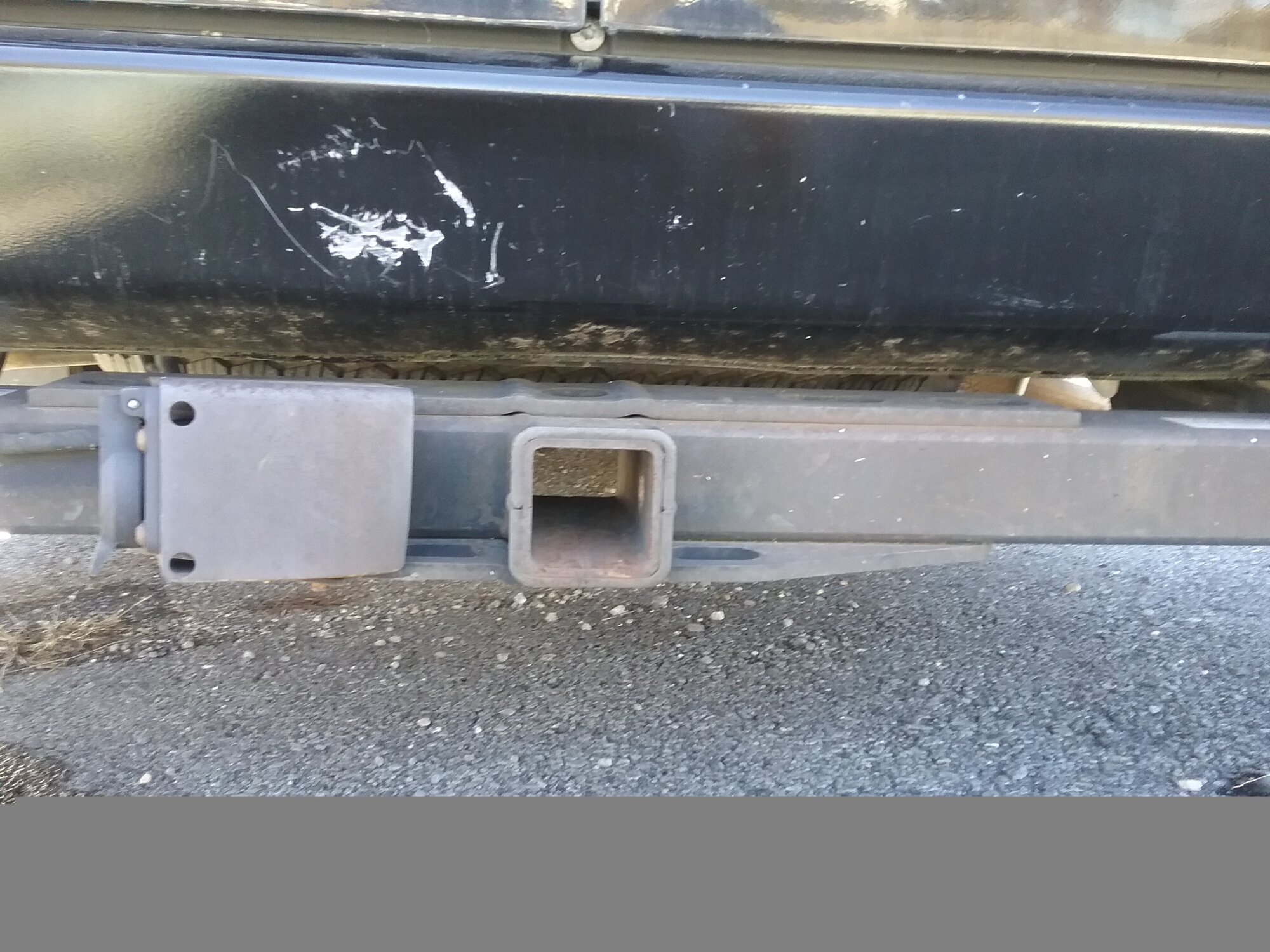

I have an older (2010) class b sprinter conversion (25 foot long) a Winnebago ERA 170,View attachment 80845View attachment 80846 .

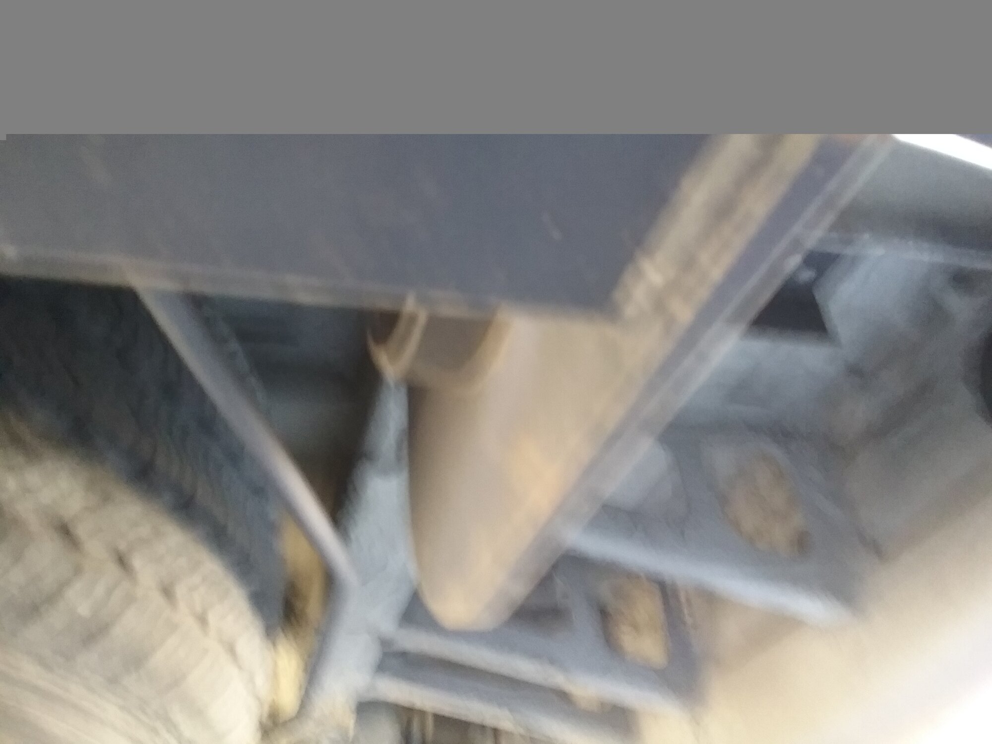

Pics of hitch and undercarriage with mount and spare tire.
I am concerned about hanging something heavy on the hitch. My 2 comos are only about 40lbs each w/o batteries, but this box is apparently 150 lbs. I won't be towing a car, that's what the bikes are for, but don't know how to tell if this is even safe at highway speed. Thoughts?
Art, the area of concern is not the rear bumper, or the hitch as shown in your first pic. The area of concern is what's holding the bumper to the coach. There's usually some sort of frame extension, maybe 6' long or so, that goes forward from the hitch, up into the area where Ford, or whoever, would have the rear bumper if the chassis were in use as a van.
I can't tell a thing from that second pic. Too blury, and nothing to reference to allow me to figure out what you are looking at. -Al
It appears that the hitch mount is part of the chassis... labeled as Dodge Ram but actually Mercedes Benz. Winnebago just did the interior AFAIK. The GAWR REAR is 5360, FRONT is 3970. There is a section of the manual that indicates that weight on the hitch shouldn't exceed 10 percent of the rear limit.

Thanks for trying but I doubt these pics are any better. Not much space to get a camera under there.
Nope, you've captured the area I'm talking about fine. The 2 beams leading forward from the bumper/hitch, SHOULD carry the weight placed on the hitch (that 350 lb spec.). My bet is, the rails actually support very little, leaving the lion's share of that task to the structure (floor, walls & roof). These rails, are way more about starting and stopping forces for a trailer for instance.
Point being, though the design will likely carry the weight of your bikes, it's something I would keep a close eye on. It's a really crappy design, but it's been in use for years. Every so often though, you'll hear about a failure that leaves the hitch/rear bumper dragging on the ground. That's because this design failed - again.
Thanks so much @AHicks . The rear bumper is 7 foot from the rear axle on my van. Seems that it is a Mercedes design, since my van has the "Barn Doors" in the rear, and no fiberglass box like the class c rigs I've seen.
I still suspect the big box on the back may be "an expensive pita" as @gtpharr mentioned above, and at 150 lbs to carry 85 lbs of bikes, I'm leary of it too.
So you understand, the issue is not on Mercedes. The issue is on the part of the MH manf as they're the ones that extend the frame from where the Mercedes frame stops. The MH manf. extends that frame back to wherever the rear bumper and hitch need to be.
The issue is, that section of frame the MH manf installs, is VERY poorly designed. They're all that way, with the exception of the diesel pushers. Those are built like tanks back in this area as they are generally carrying the weight of the engine and radiator - not something you want to see dragging on the ground! 😄 -Al
