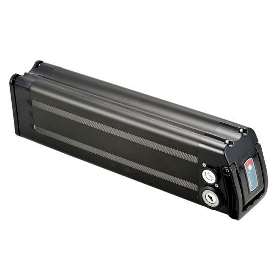

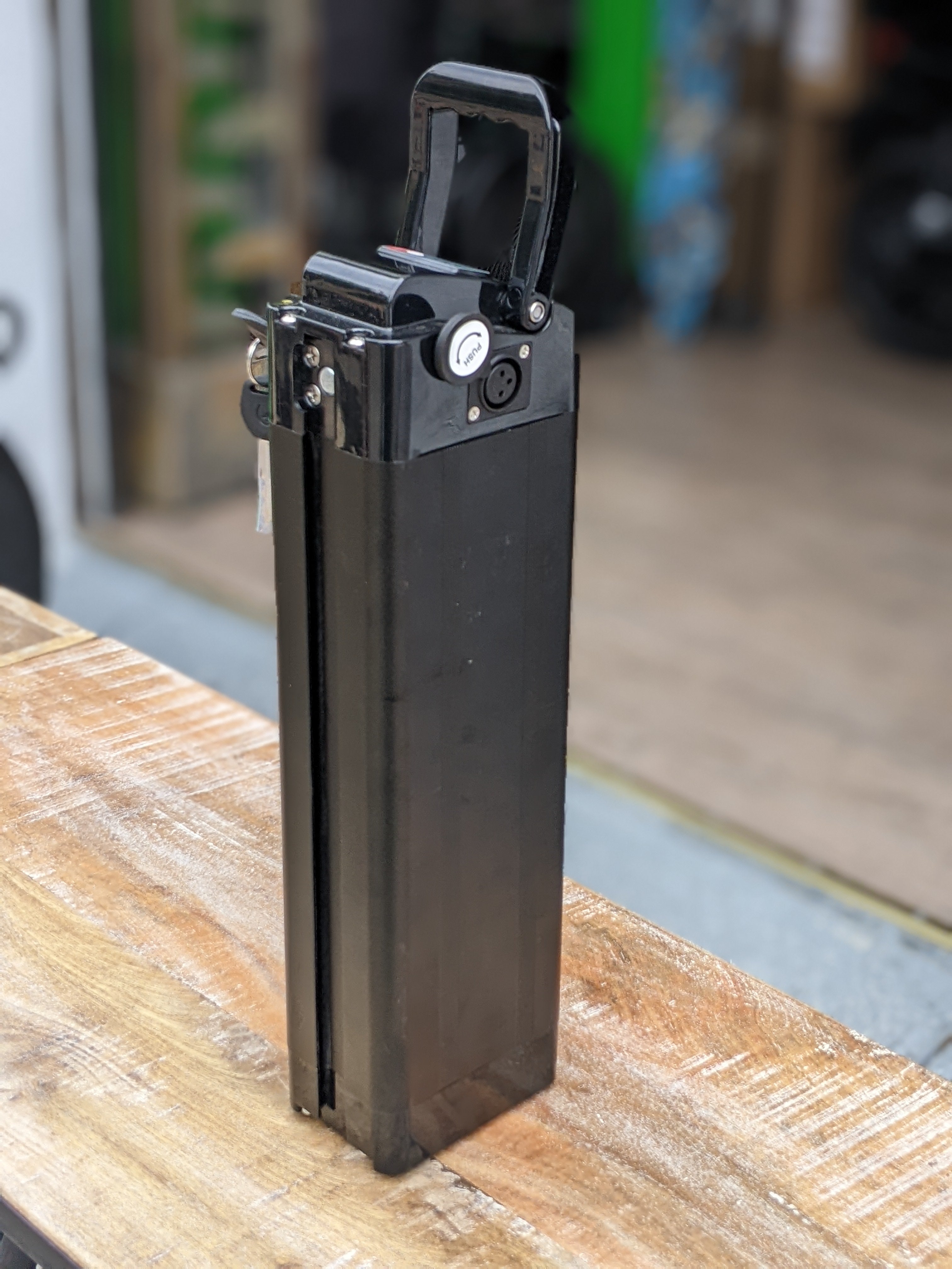

The picture doesn't show the battery clearly. I'm guessing it's the venerable SIlverfish case with 48V. They come apart if you're a dogged DIY person and there is a rectangular block of cells inside, but I don't think you can buy them pre-assembled. You might find a blue shrinkwrapped 48V battery that could fit, but those are often of dubioud quality.

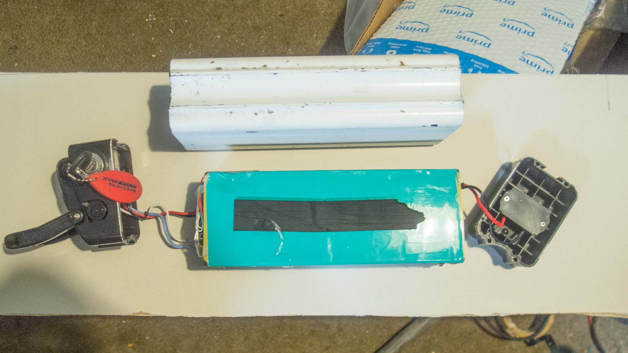

There's room though for 65 cells in that green wrapper. Mine only had 40 as it was a 36V battery so almost 1/5 of the space was just empy slots. , I was going to upgrade mine with new cells from 36V to 48V, but I gave the bike away.
