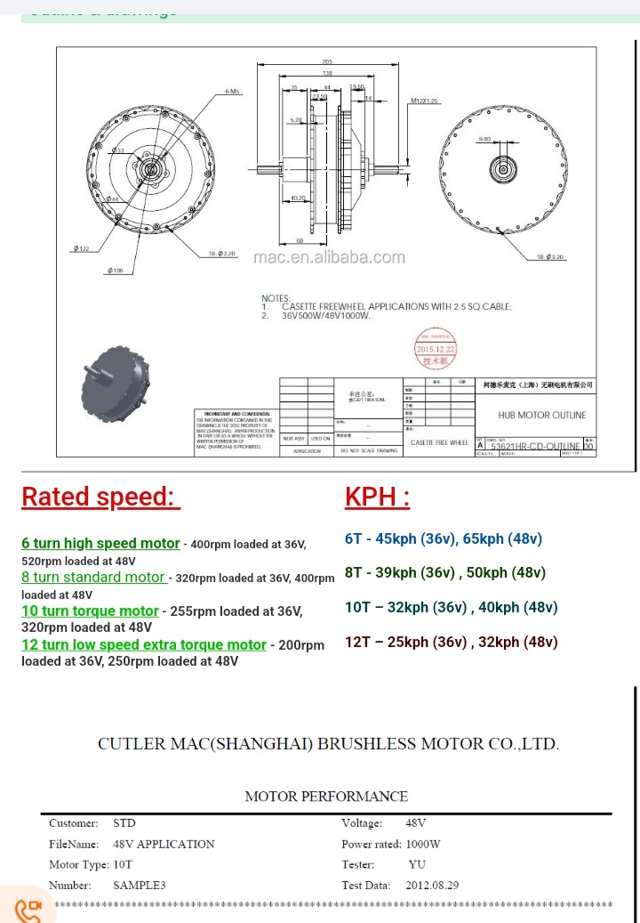

6 to 7" diameter hub motors are geared, the motor runs 5 times faster than the wheel. The start torque is about 5 times higher than DD motors. My Mac12T geared hub motor will start 330 lb without assistance on a 15% grade, then pull up to about 6 mph without help from my feet. The limitation of geared hub motors is that they will burn the winding if lugged up a steep grade for an hour or more. I cross 77 hills in 3.7 hours on my Mac12T, but they are rollers and I carry the speed of a downhill up the next hill. Some of these hills are 12-15% grades. My Mac12t tops out at 23 mph, whereas a previous 10 winding geared hub topped out at ~25 mph.

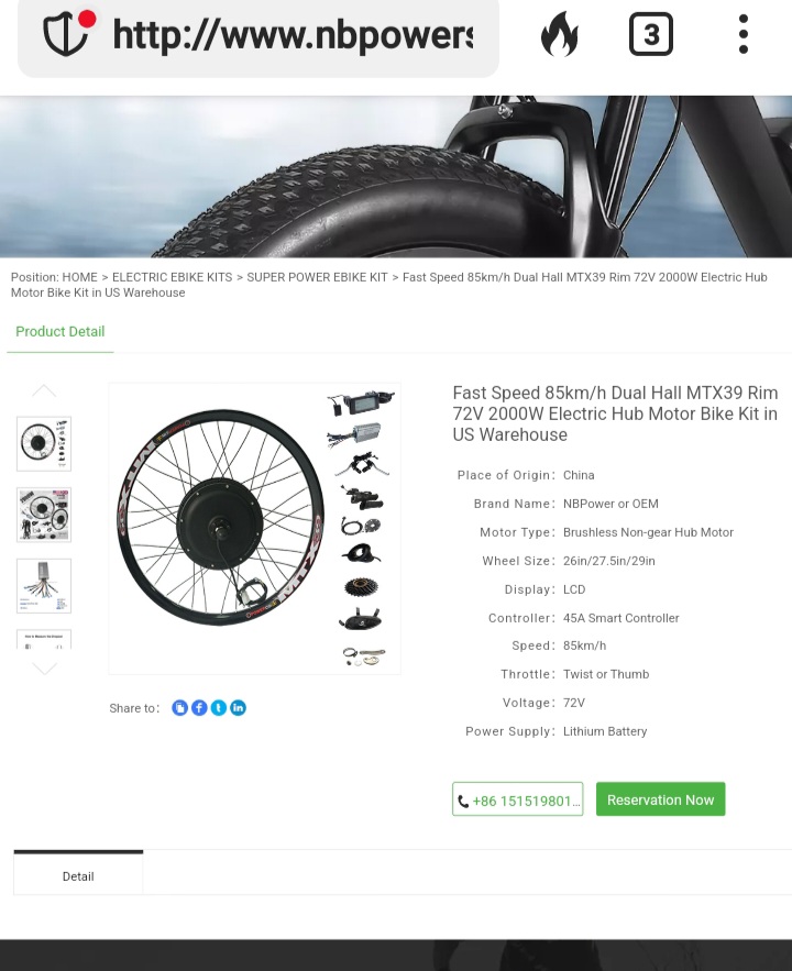

That motor looks too thin to be a geared hub motor in my opinion.
I found this, which looks like what you have, and they list it as a Non-gear Hub Motor.

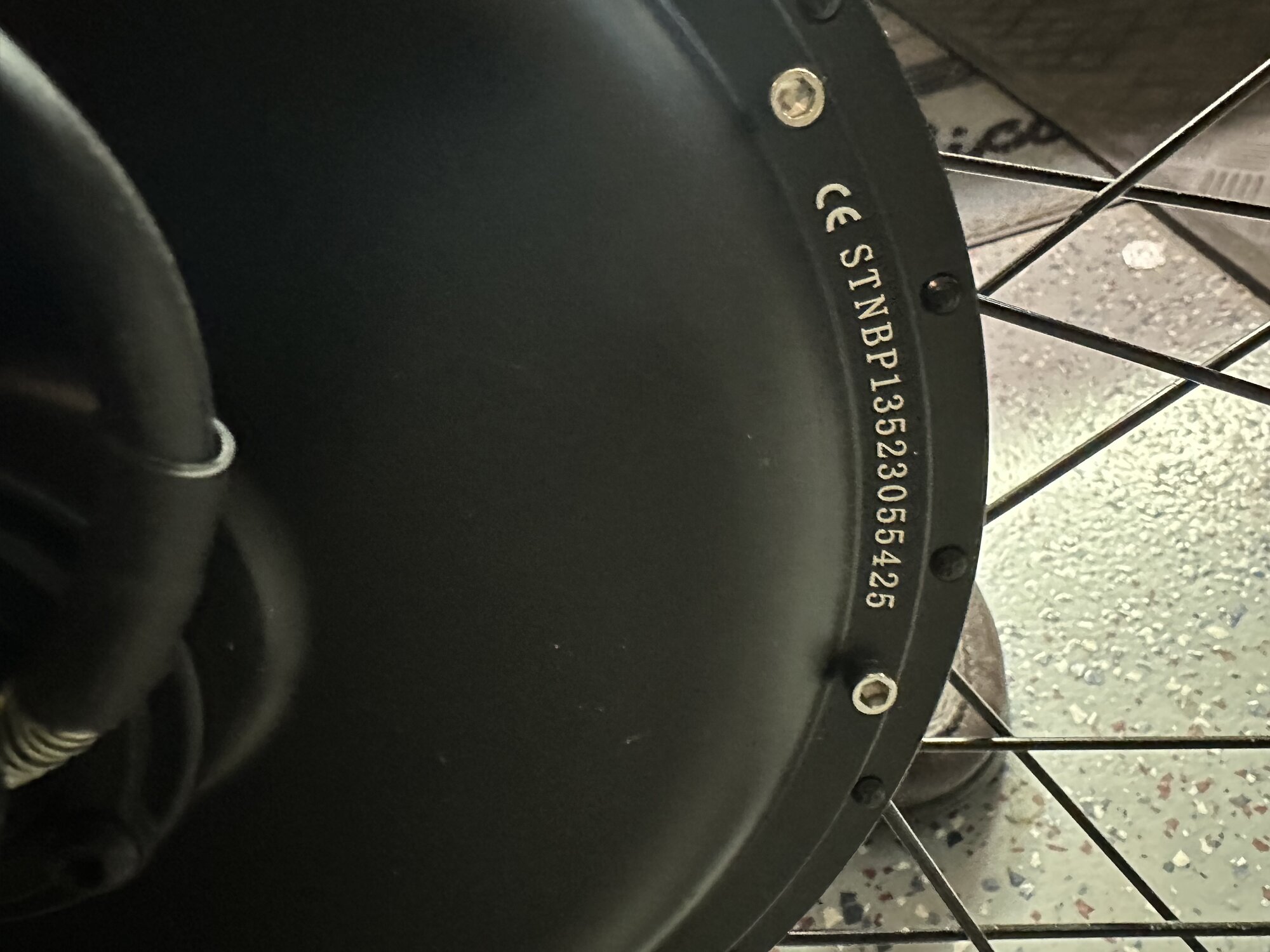

Foot rulers are $1 with the school supplies at any dollar store. Is the diameter 12", or 6 to 7"? If 12", it is DD. If 6-7" it is geared.

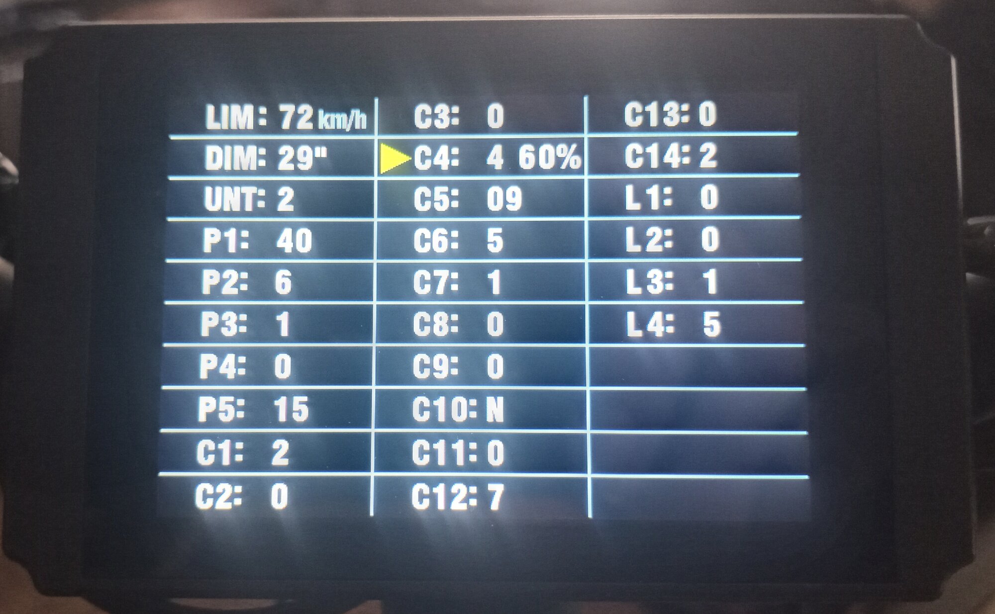

I have a 72 volt battery supposedly a 2000 watt hub. I set and reset the parameters on the SW900 display speed is set to 100

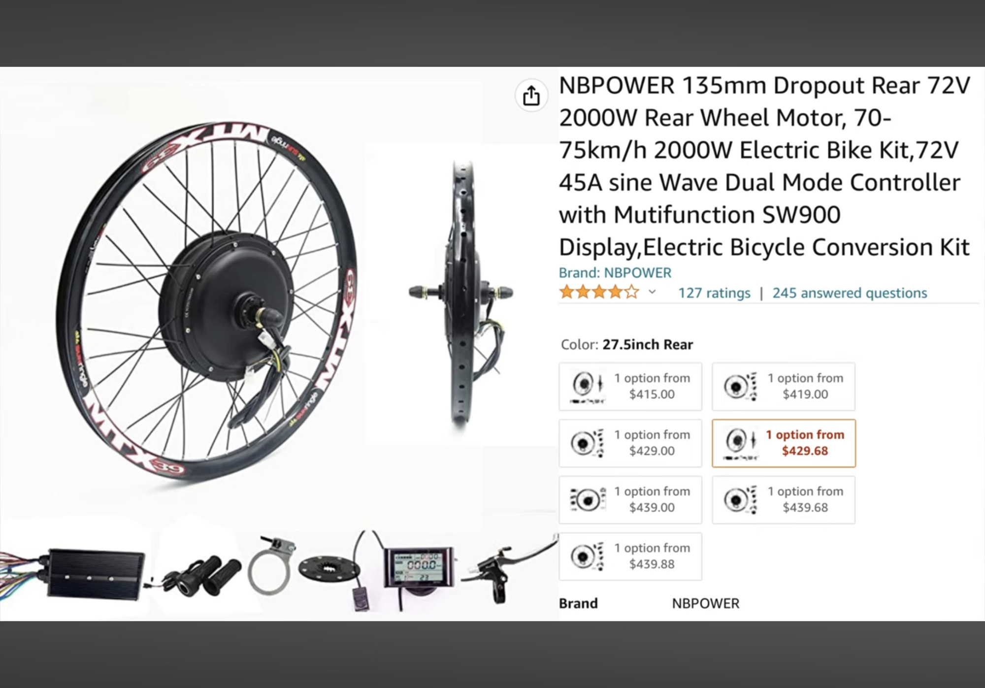

Glancing at the reviews on Amazon the results seem to vary, probably correlated to the battery voltage and max amp output of the battery.
1. Owner weighs 240lbs, 48V-1500W, with a 52V 20Ah battery. Reports 34mph.
2. Owner waighs 200+lbs (version/battery unk) Reports 45mph.
3. Ower weighs 260lbs, 2,000 Watt version with 72v 80Ah, continuous 35ah battery, reports 74.5 mph. "this kit will cause the bike to pop a big wheelie"
Question: In your display settings is the P14 Controller Current Limit set to match your controller maximum output?
"1-20 Amps, some versions of sw900/controller allow higher values.
Sets the current (amp) limit of your controller"
