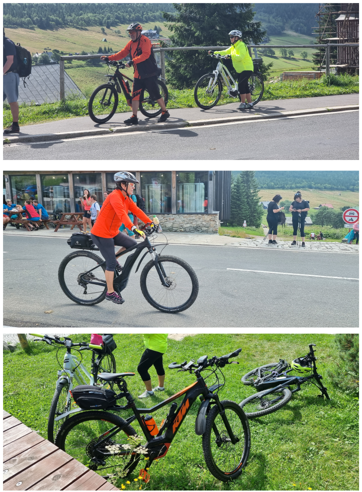

I was on e-bike vacation to the Czech Republic, which is a montane country (still, their mountains are not even remotely as high as the Alps). One day, I and brother climbed on our expensive e-bikes the equivalent of 3000 ft to reach a mountain pass.

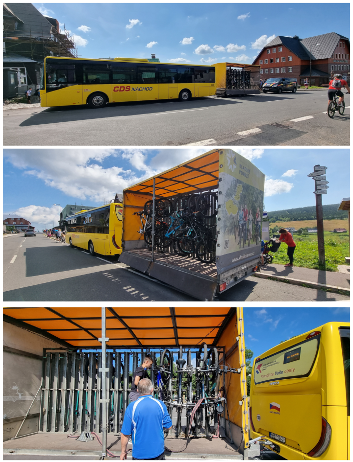

When we were enjoying our beer, three "cyclobuses" arrived, each of them carrying 30 bikes.
90% of bikes brought by the buses were relatively inexpensive mid-drive e-bikes from Haibike, KTM, or Polish Kross. No single hub-drive e-bike.

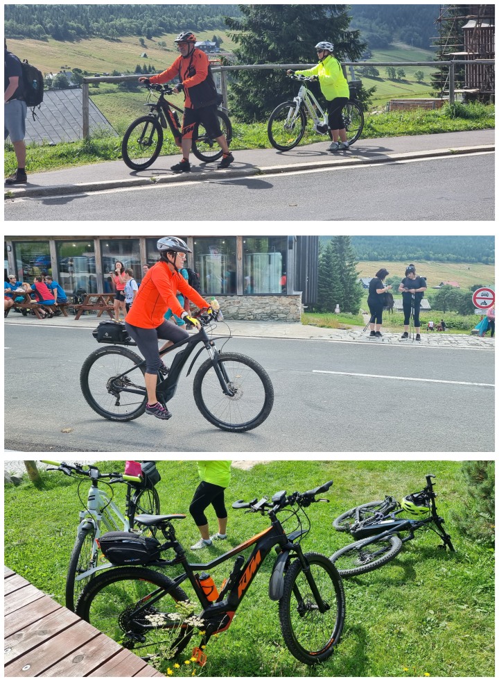

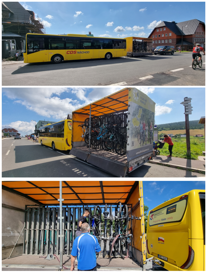

Right. Czech people are practical. If their e-bikes can be carried to the top of the pass, why suffer the long and boring climb with the traffic. They simply collected their e-bikes and set off for easier and harder trails in the mountains (and the number of bike trails is impressive there). Me & brother liked the harder way, so we actually climbed onto the pass with our Specialized and Giant e-bikes. Important to mention, Czech people we met were riding low-end Euro mid-drive e-bikes (the nation is not that rich). I would say only 10% of the bikes brought to the pass by buses were traditional MTBs (for sporty types), and we also overtook three roadies climbing together with us on traditional road bikes.
I cannot say anything about cheap hub-drive e-bikes vs mountains as I haven't seen one wherever on our trips, and I wouldn't dare to take my hub-drive for any montane rides.
