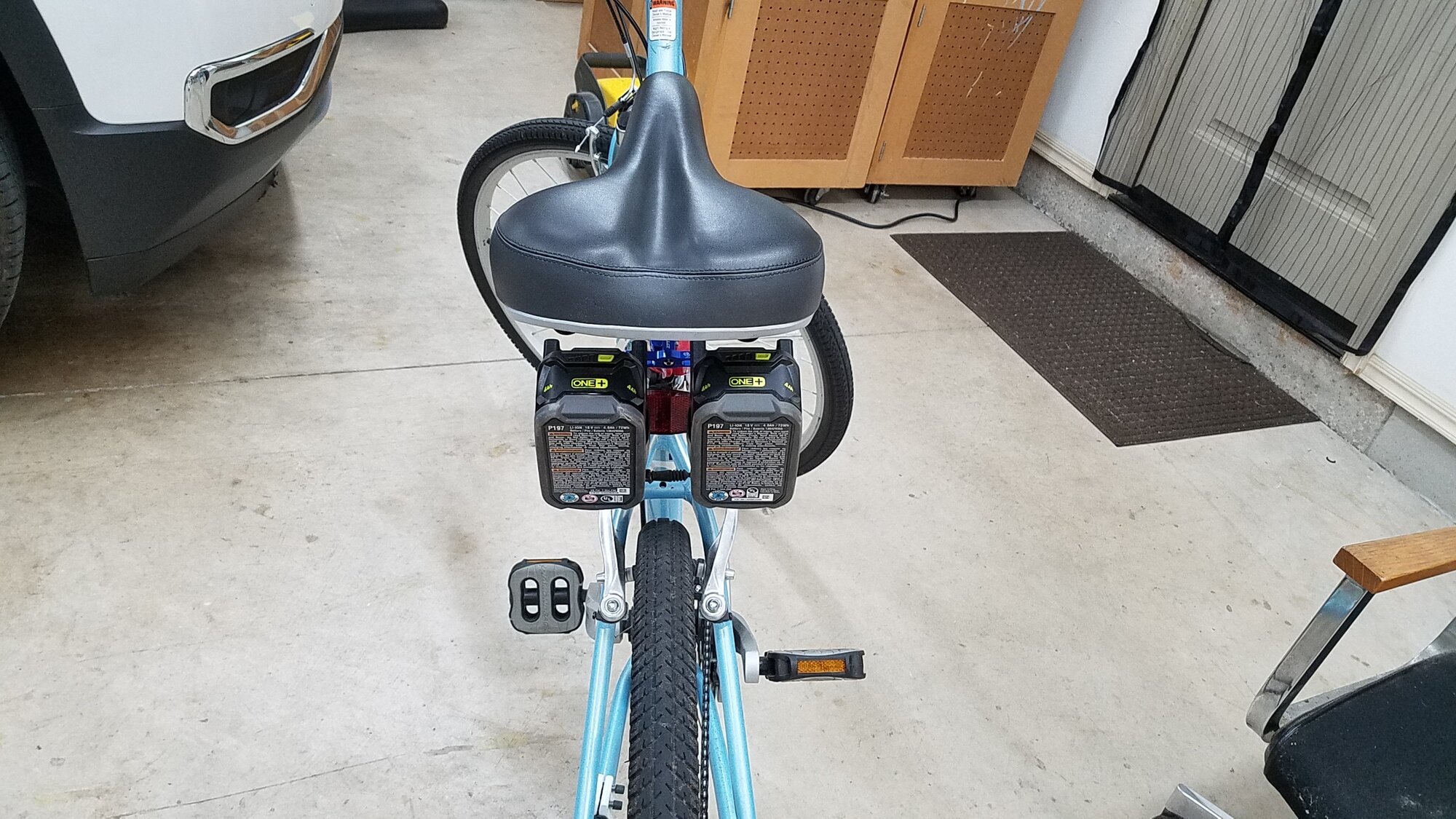

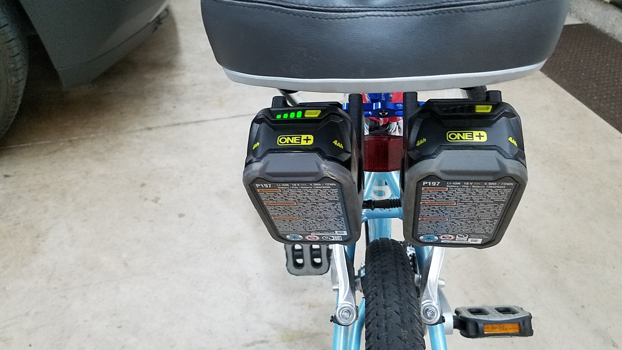

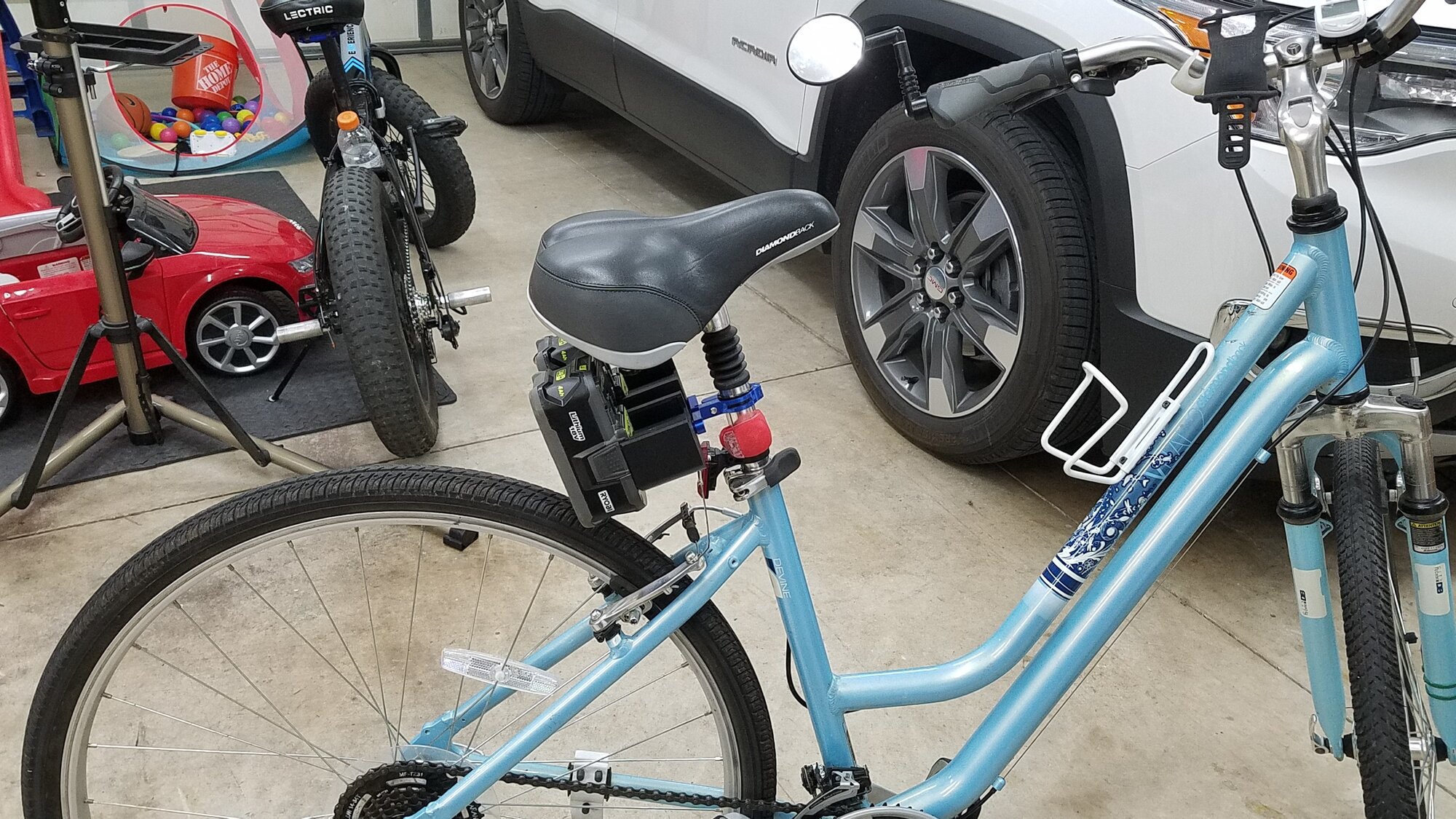

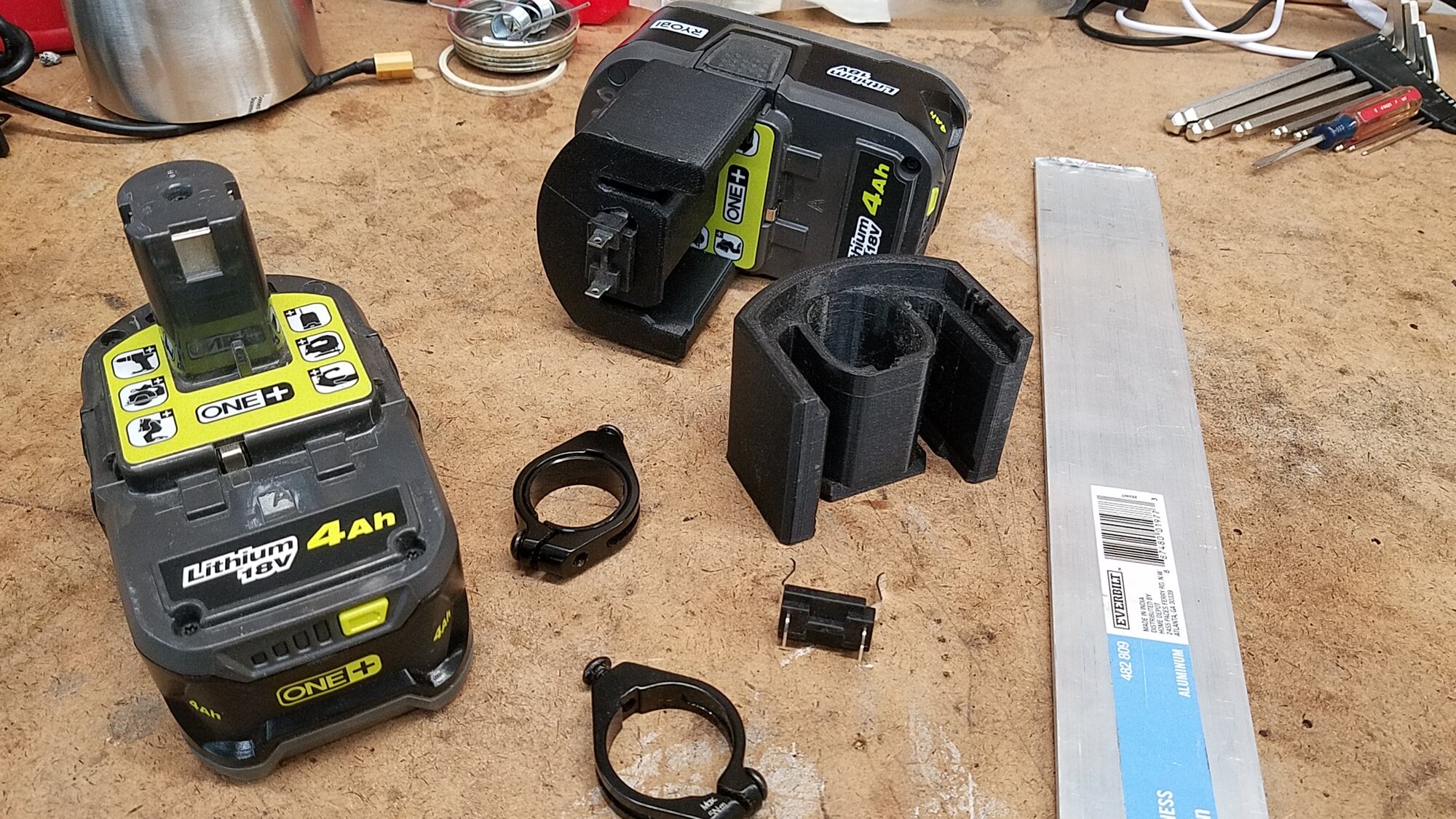

I am in the process of building a custom 10 amp hour battery for my wife's ebike conversion. Until then I thought I'd slap a couple of 18 volt Ryobi batteries in series take her for a spin.
The parts consist of a Ryobi battery wall hanger and a Ryobi battery clip, both on eBay from different sellers. I join them together with some aluminum bar and then added a couple of seatpost water bottle clamps to attach it all.
Hope you like!
Hope you like!
Very cool design... can you tell us more about the conversion project?
Nice bracket!

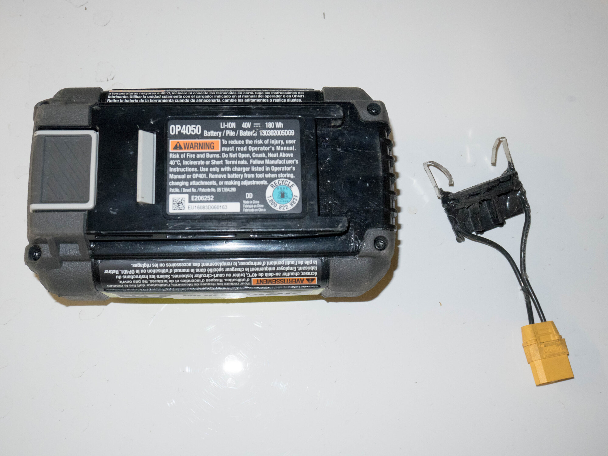

I've run the ebikeling motor (and others) on the 1.5AH and 5Ah Ryobi 40V packs. The bikes ran stronger on the smaller AH pack because it puts out a higher peak current, albeit for a short range, like 8-10 miles. The 5AH pack did not increase range much at all because it would reset if asked to pull high current after it was half discharged.

Thanks! I got the LCD and no it doesn't show speed while coasting. No biggie though, this is just to hold the wife over until her Lectric XP arrives.

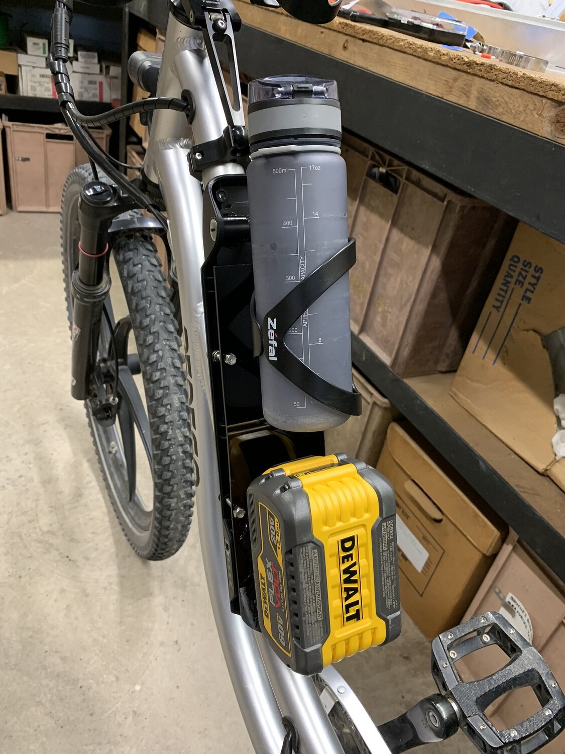

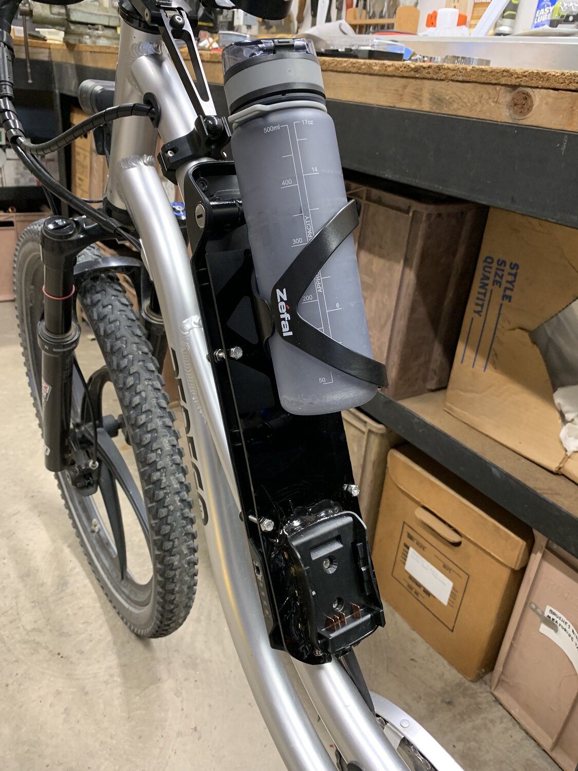

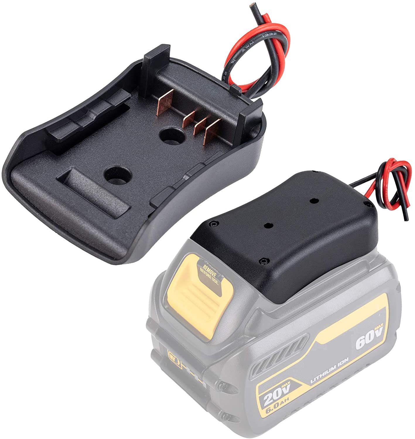

I made a battery for my 52V Pedego bike using 60V DeWalt power tool batteries. I have many DeWalt tools and a supply of their batteries so the cost for me was minimal.
I used this adapter:
And made a bracket to mount it on the down tube below the bottle cage:
It's a 4 AH battery at 60V and it gives me a 12 mile range on a smooth level surface.
View attachment 117762 View attachment 117761
That's a nice installation and a better range than I would have guessed.
