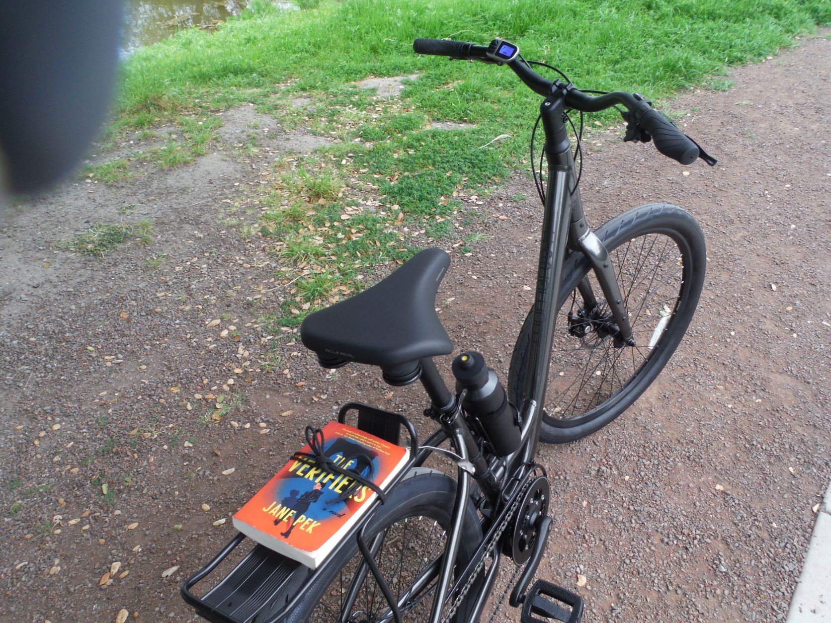

I know this has probably been discussed somewhere, but I just ended up getting the 48v Tongsheng controller. After I ordered, I noticed that the eco-cycle water bottle battery @Antonella bought is made to work with the 36v controller. I see there are other ones out there, supposedly a Samsung battery - Samsung battery???
Anyway, I'm deep in the battery rabbit hole. Hoping to find something light and reliable that will work with my controller.
