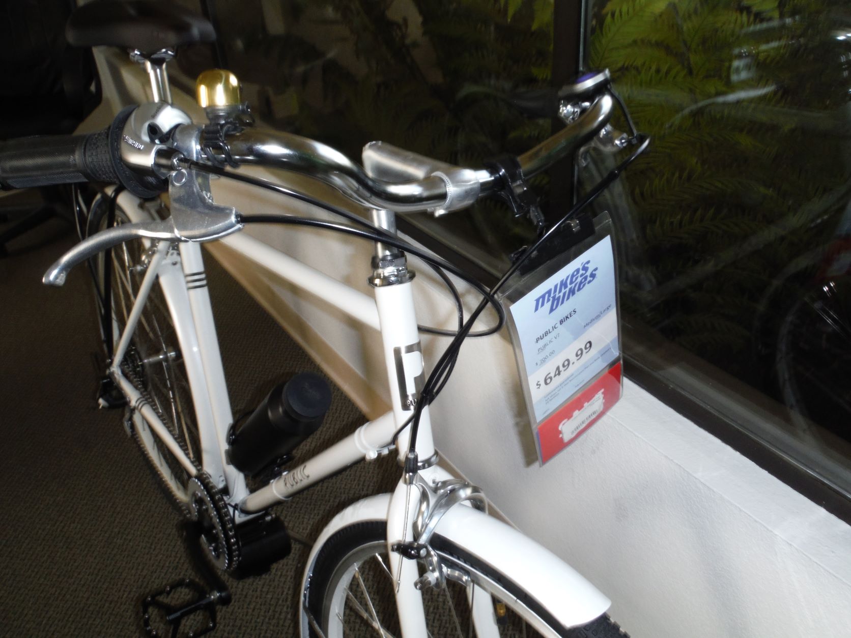

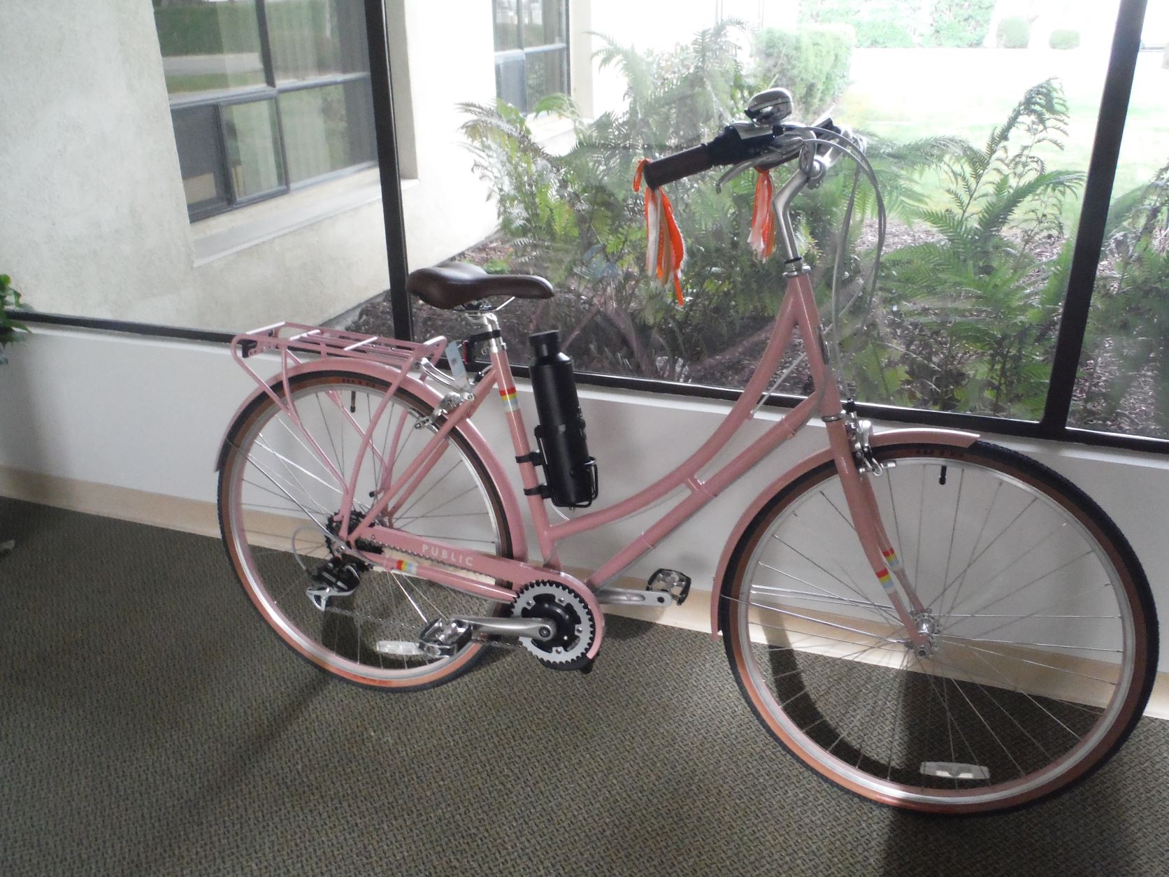

Actually I got two of them for $549 each. They were on sale the week before, so I asked for the sale price. I got them late in the day on a Tuesday and the Blush one was sold on that Thursday at noon. Here is the bike I picked up on last Thursday for $325. They want $1200 for these in Montreal. They are not imported to the States.

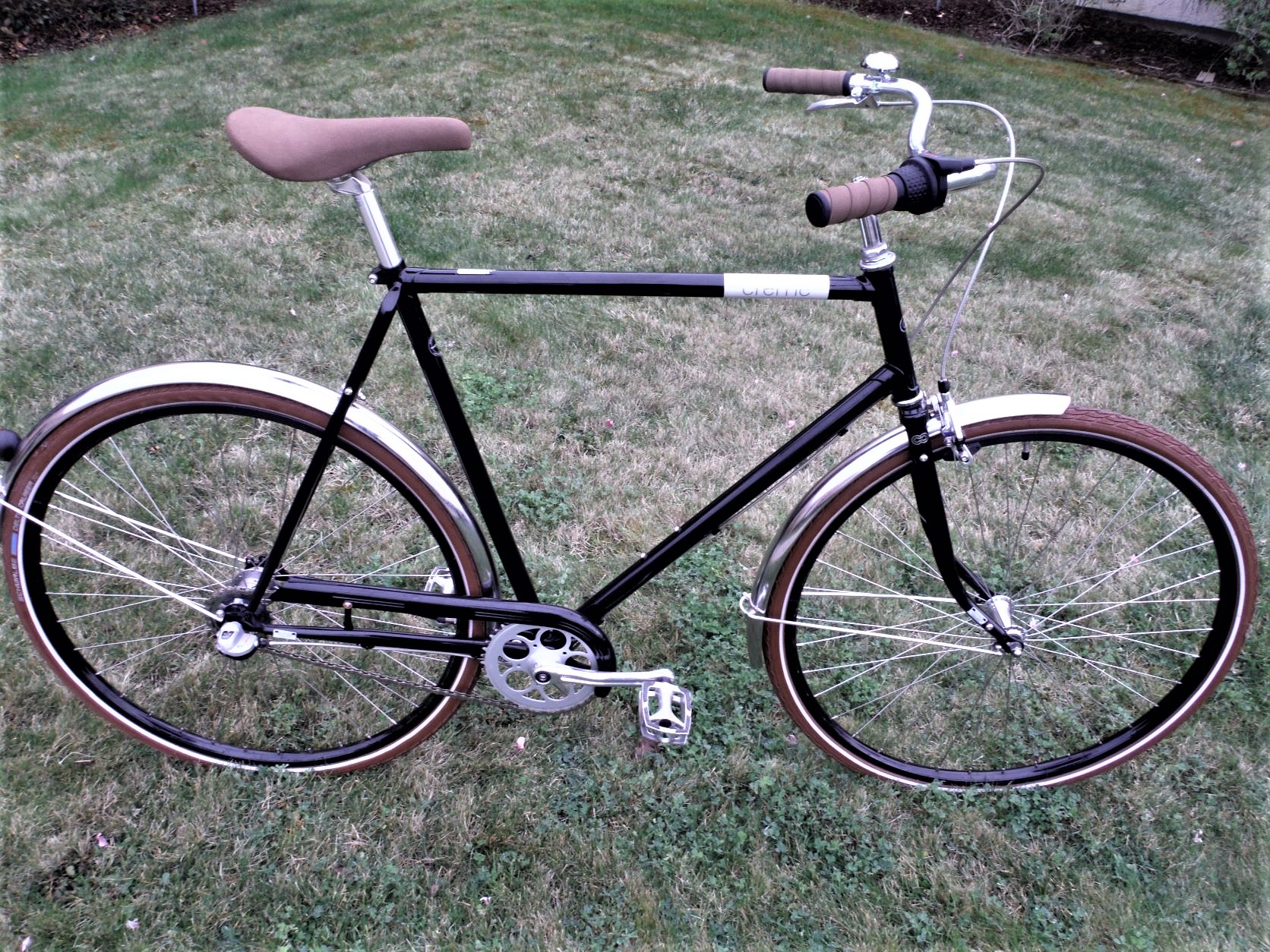

The $325 bike will look a lot more like this classic three-speed but cleaner when transformed and made superior electric. It will blow past the $9400 bikes from stores on climbs. It is handmade in Poland. The frame has flex and is much better to ride than carbon and faster in the real world. @Stefan Mikes does not like superior bikes like these. They go 45Kph. And are practical daily transportation.

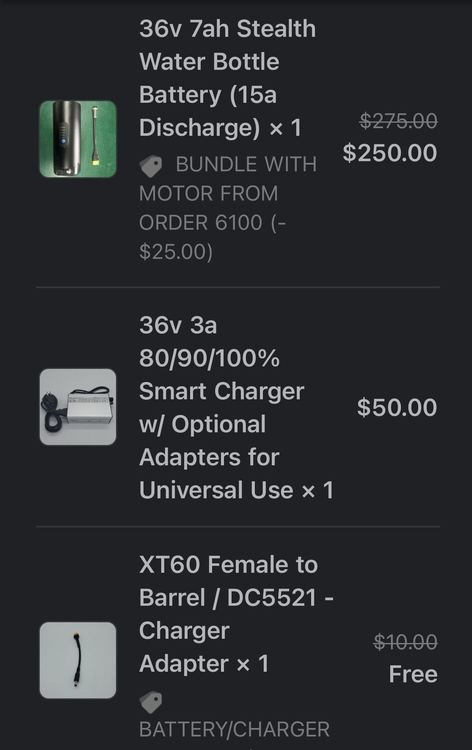

Ps: just purchased the battery, adapter cable (free), and the smart charger 80/90/100 for $300 with free shipping from David Hall at Eco Cycles in Nashville Tennessee. Great service very, knowledgeable man!

Ps: just purchased the battery, adapter cable (free), and the smart charger 80/90/100 for $300 with free shipping from David Hall at Eco Cycles in Nashville Tennessee. Great service very, knowledgeable man!View attachment 116164

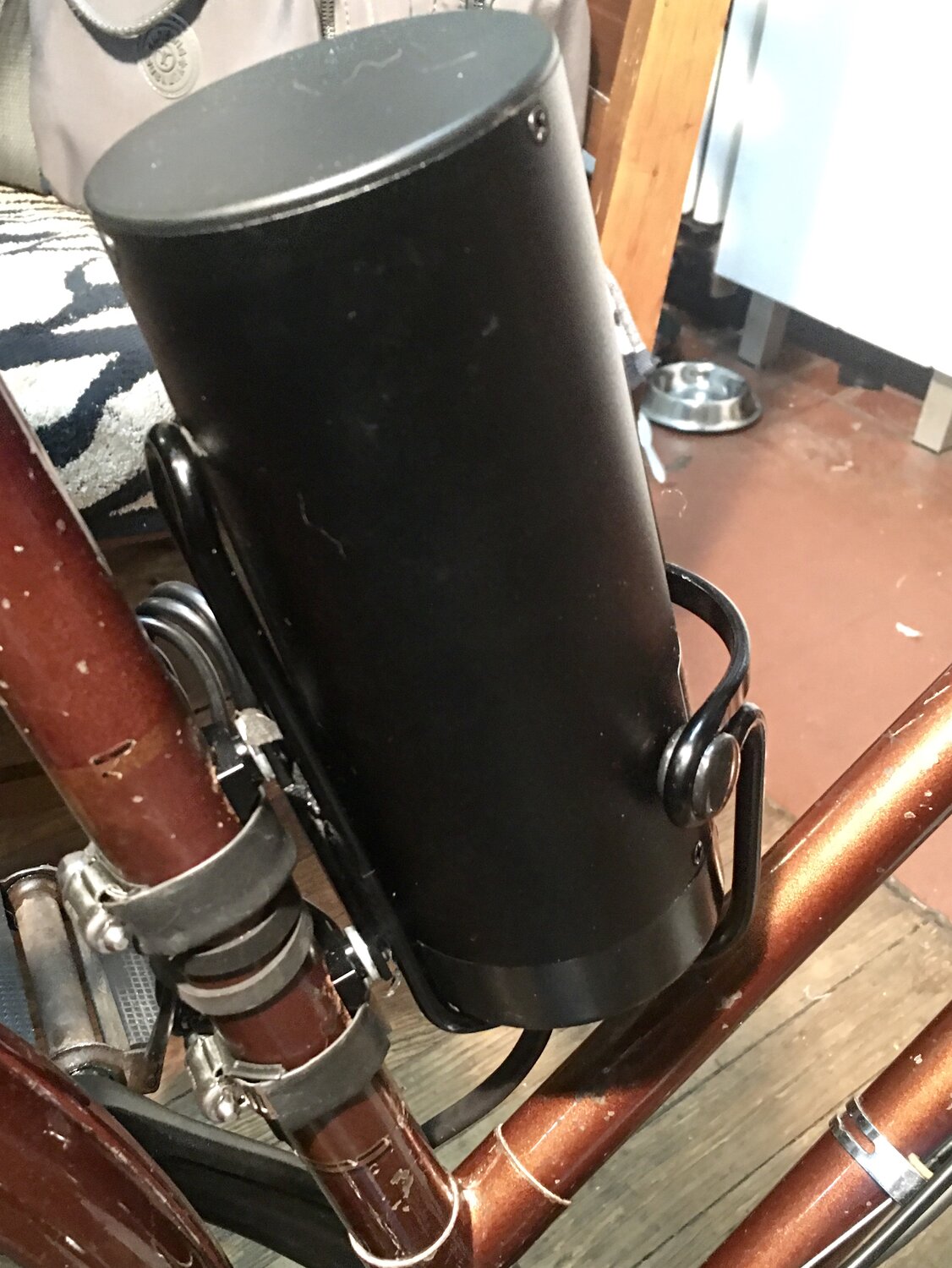

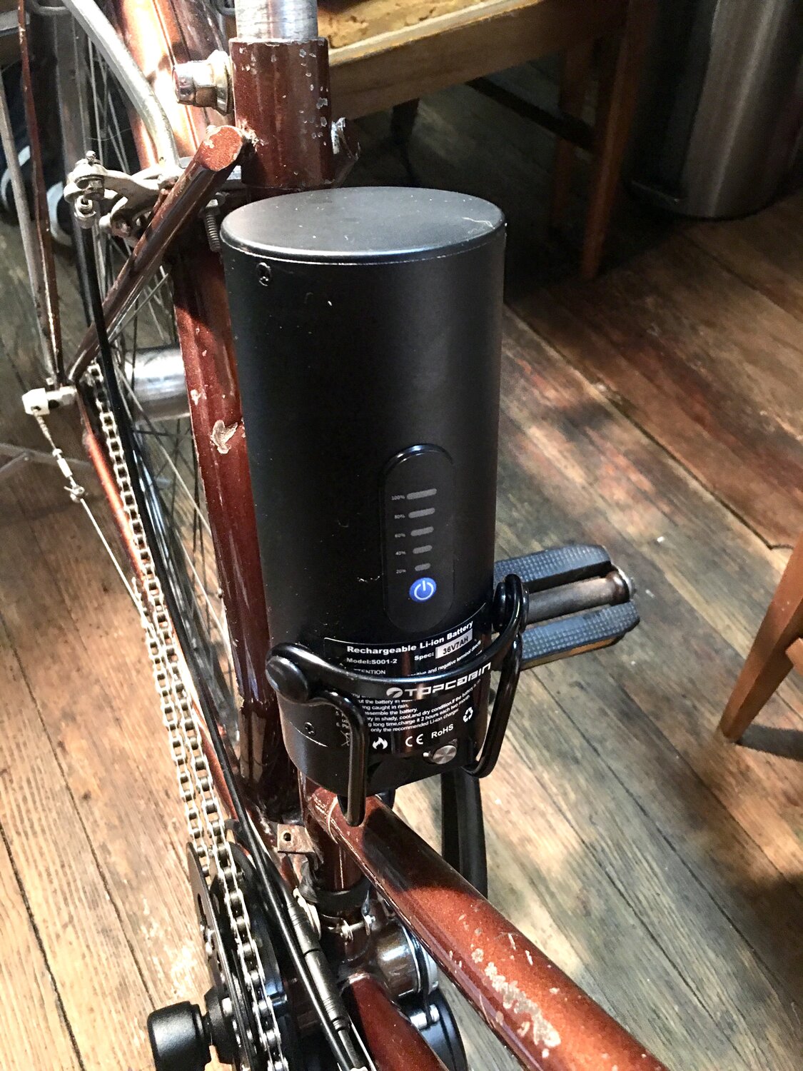

Okay, I finally hooked everything up! Yes, the plastic cages that come with the water bottle battery are crap. Mine was even cracked when I got it so I purchased a metal cage on amazon for like 7 bucks. As per PedalUma, I purchased the exact cage he recommended and it is the best one I've found. It holds the battery well. I used a Bottle Bob to attach it to my seat post that had no attachment threads on it. One note, when installing the Bottle Bob be careful when screwing it to the aluminum assembly. The provided screws are short but they can still come through on the frame side and scratch your frame. So I added two washers on each "BoB" to keep it from scratching the frame.
