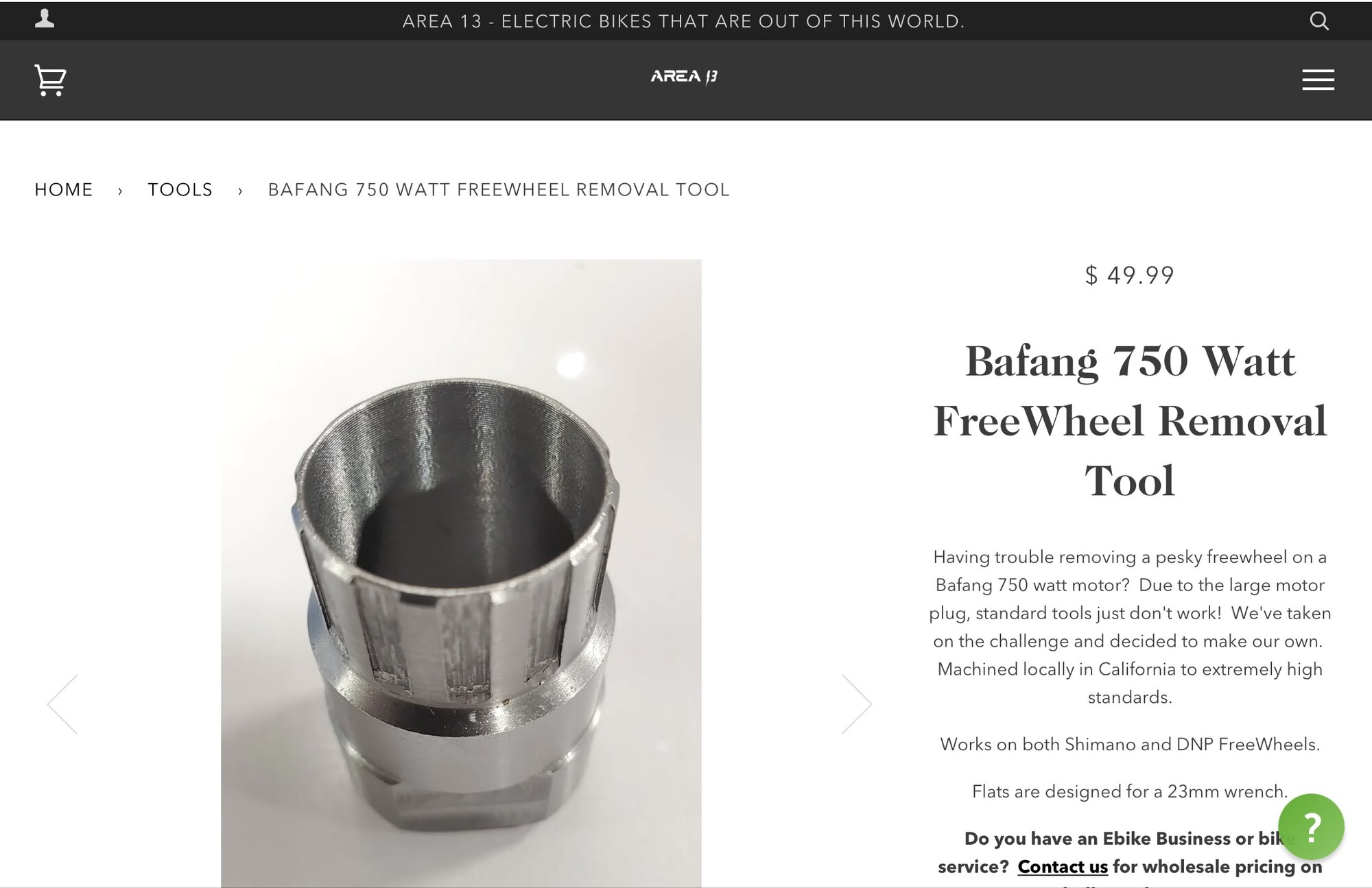

I've emailed RAD regarding the rear cassette tool, they responded saying they do not provide such tool. Any alternatives out there?

Um, nope. The nut we're engaging with this tool is engaged using the OUTSIDE of the tool.
Further, this tool must often be slipped over the motor power wires, further complicating the issue.
Check out the pictures in this thread for an idea of how some are doing this:
WTF? That’s a $10 tool!
He's taken a lot of heat for that price, but I understand he is actually making them himself in house. I agree though.
And a 23mm wrench? As silly as the Bafang socket Californiaebike sold needing an 1 5/16”
dremel out a 1/2 drive version.
