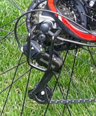

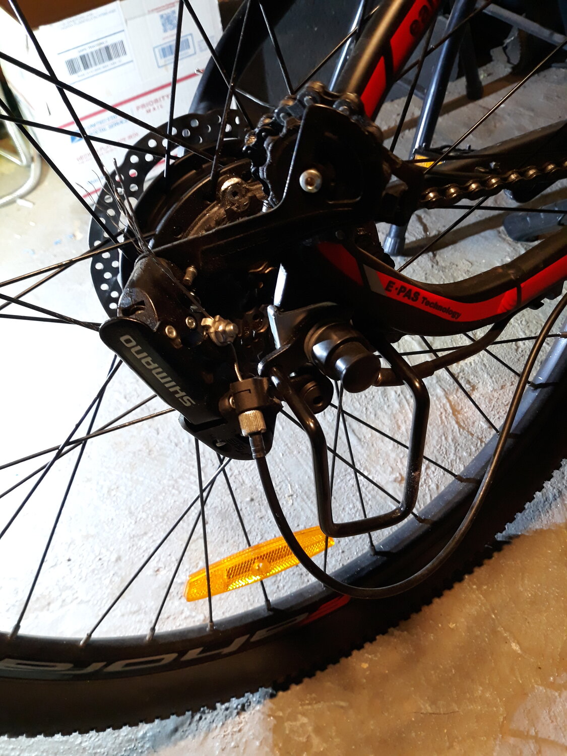

Hello all New to the forum and have a question... I had a minor accident with my xc100 and utterly destroyed the rear derailleur. Stupidly, I did not save the mangled mess, so here goes... does anyone know the actual 7 speed shimano rear derailleur for the eahora xc100? I was told by my local shop it was the Altus M310. Eahora's product specs say the same. However the product shot (although very unclear) looks like it reads 'Tourney' . I bought the M310 on the shops advice, and I will tell you, it does not fit nor work! Guess i should have researched just a little bit more before buying! So, I'm assuming it should be a 'Tourney', but which one??? Sorry to sound like an amateur, I should have handled my situation more cautiously and intelligently. I miss my bike. Can somebody help? The rest of the bike is still stock; no upgrades. Thanks everybody. Glad to find you all.

The old derailleur was totally FUBAR and, alas, I threw it away. I do have this bad and fuzzy shot from before the accident.

Looks similar to the deraileur on my Paselec G9. I removed the guard that is the same as yours.
G9 is a 7 speed 11-34 freewheel, although the deraileur says 6speed.

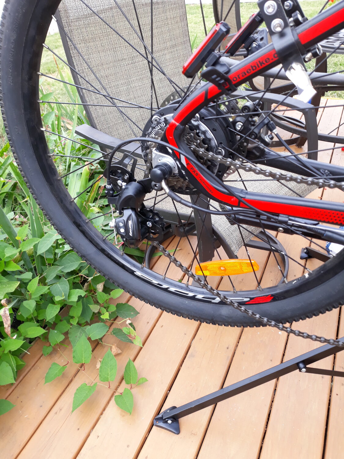

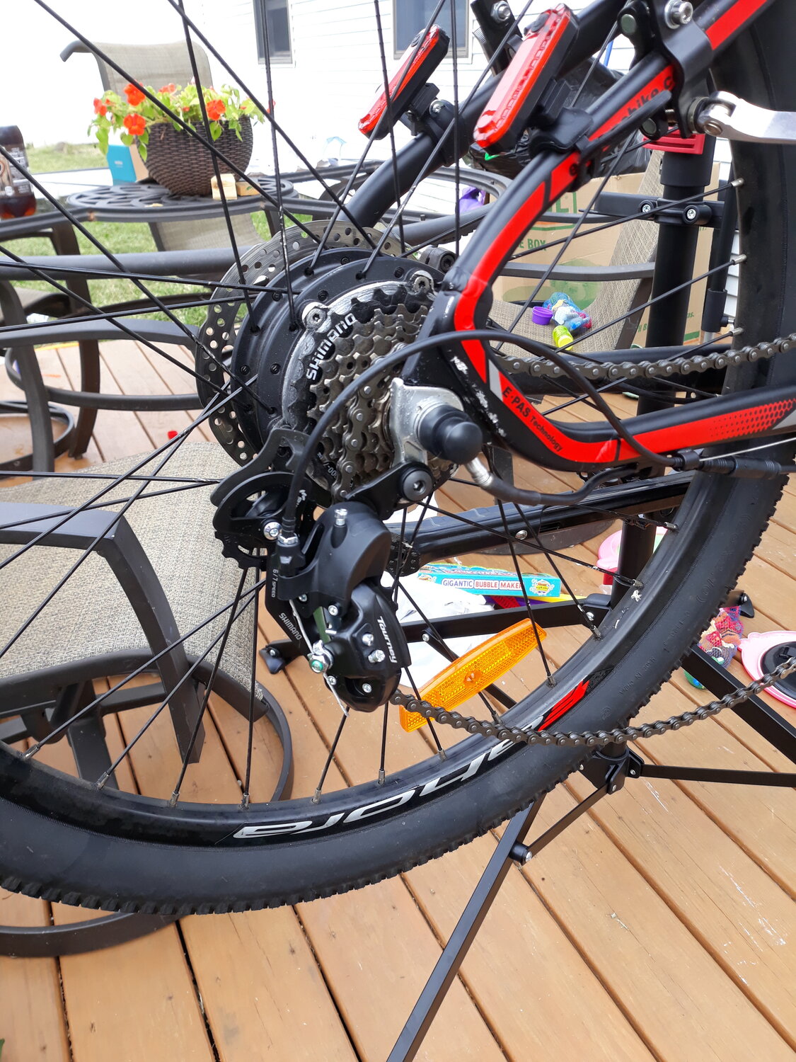

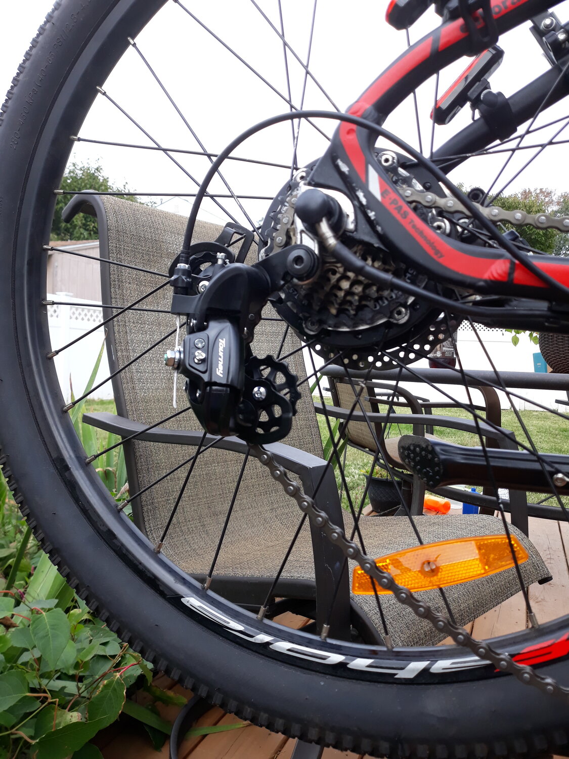

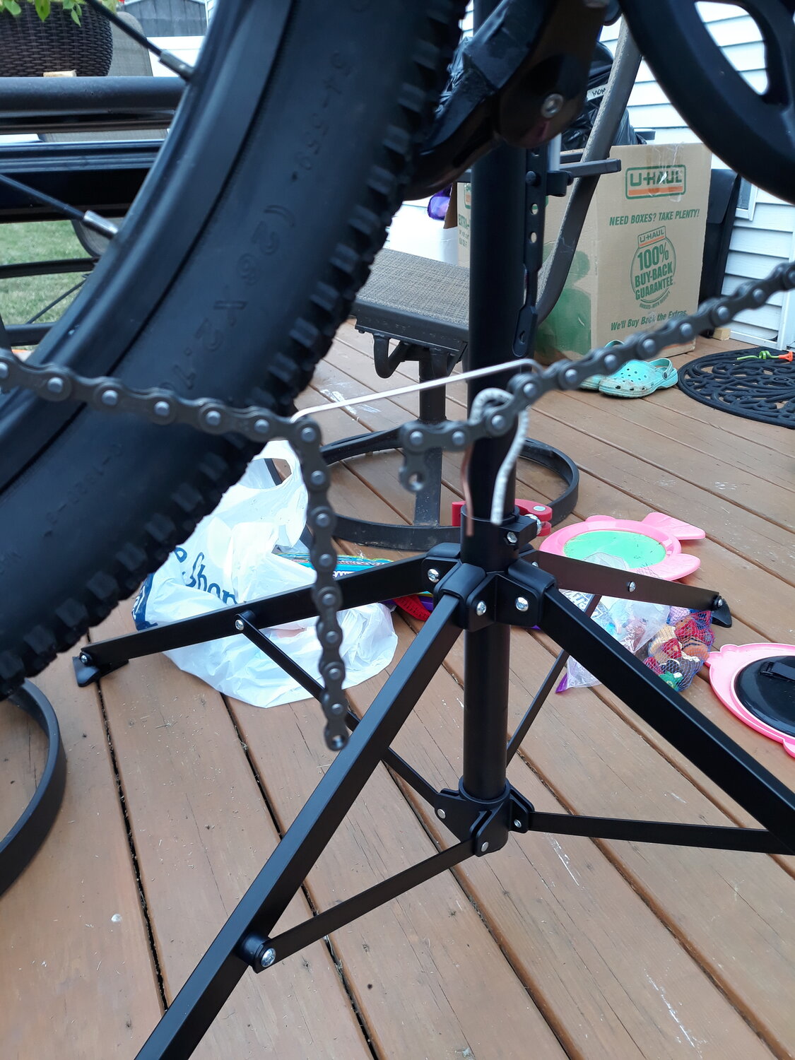

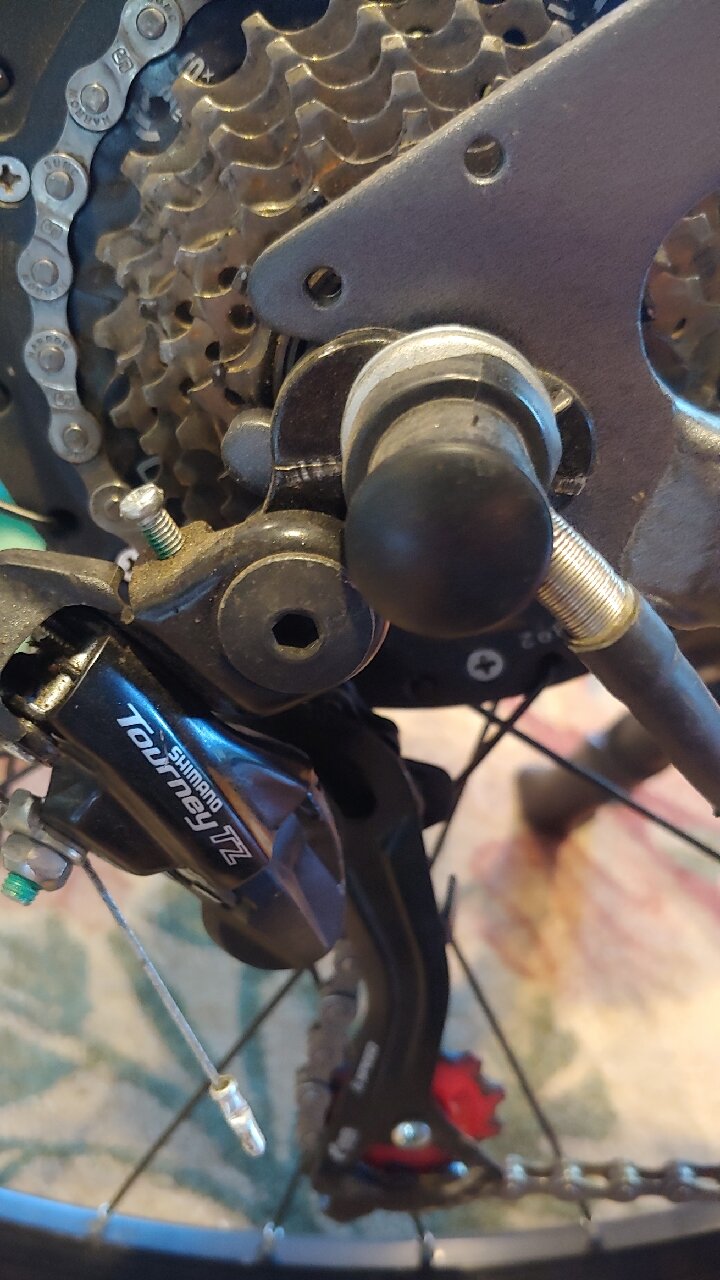

Same results! The derailleur only goes on one way because of the stop tab. What's wrong with this picture? Do I need to shorten the chain? The new chain is the sam length as the old (actually about 2-3 links shorter. By my estimation, I would have to remove about 4 links(maybe 5 for a proper tight fit-largest cog,without derailleur) does this sound right???
