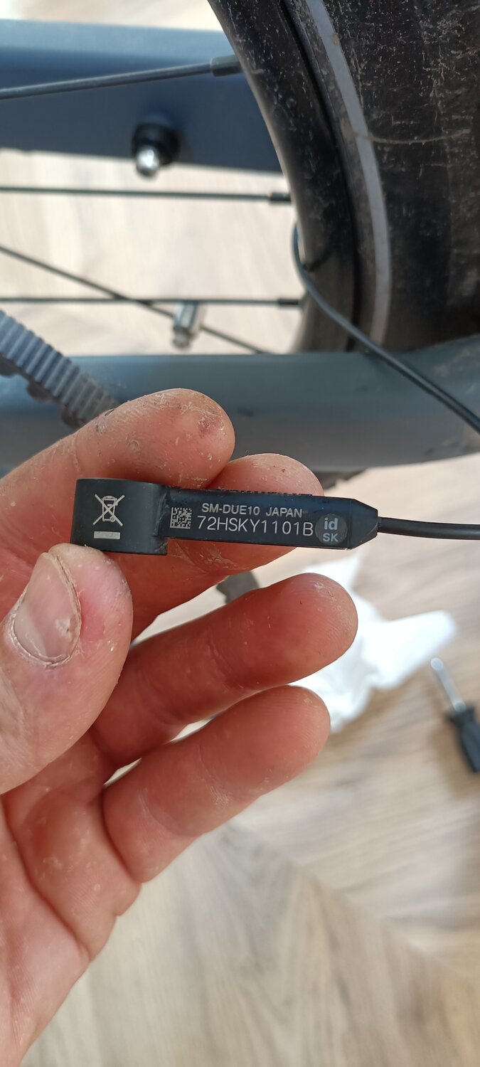

Hello eveeyone. I was riding today and suddenly got no motor support, heard 3 beeps and error E014 on display. Looks like a speed sensor. Checked the sensor and magnet, all in place, magnet is well orientated, no dirt or contamination, no damaged wire sensor. Power off, removed the battery, drained the system by pressing power button with battery removed, but no luck. Removed the motor cover, removed the sensor plug, all clean, no traces of water or dirt. The bike is a road bike and was not taken offroad. Anyone had this issue?
