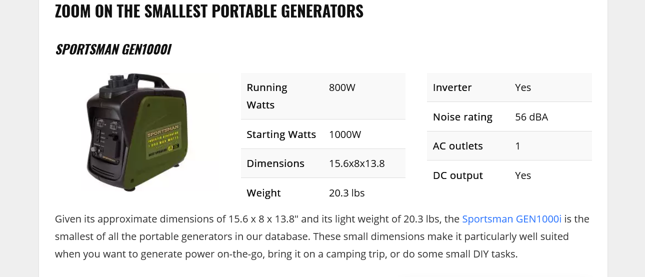

If you mean having a gas engine as well battery motor then you could put one of these on your rear rack and plug in your charger to it.
Screenshot 2023-09-28 at 13-03-06 What's the Smallest Portable Generator September 2023 Top 10...png
