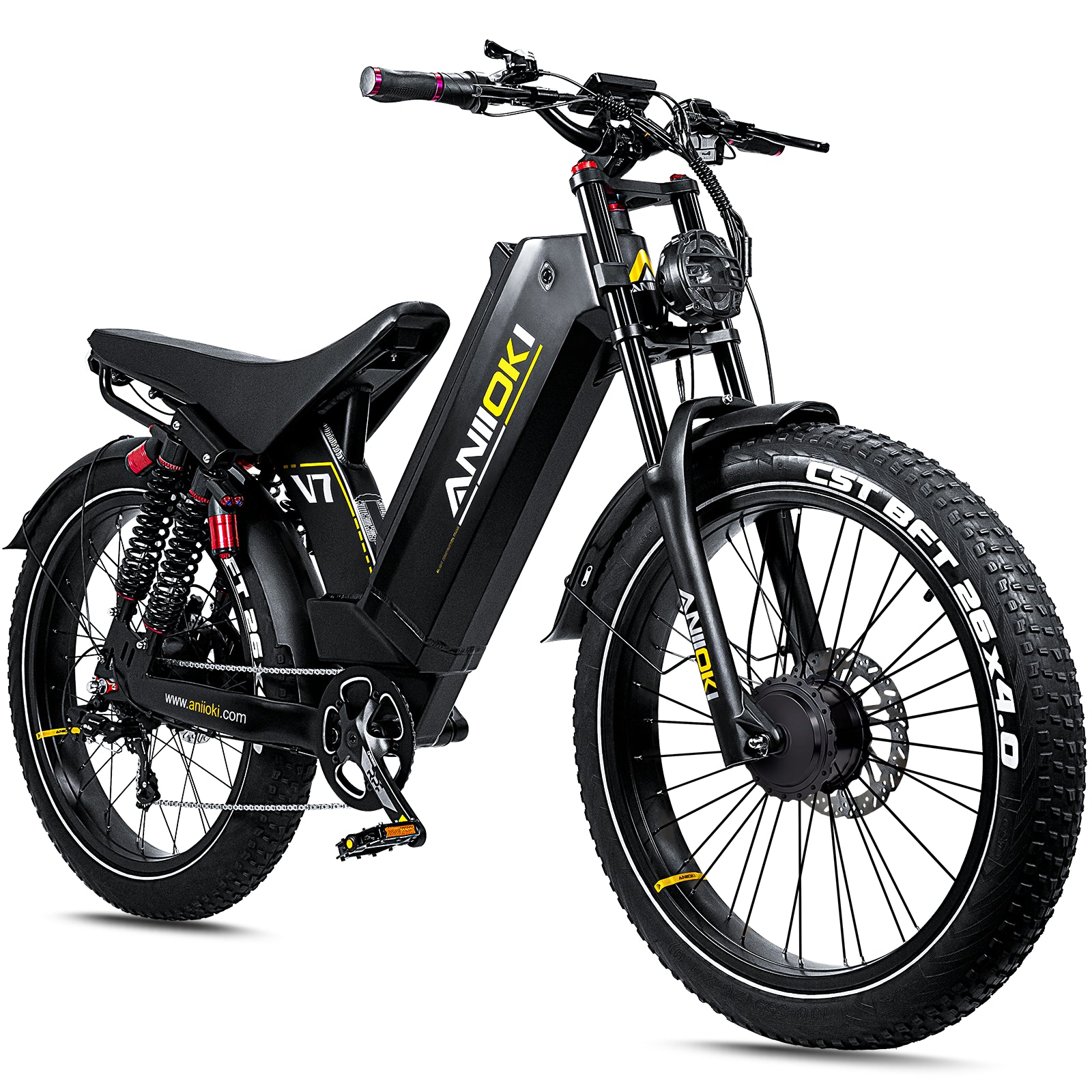

Court reviewed and e-bike with dual motor and has a long banana seat like motorcycles. If you look at his videos you may see it. That can fit for you.

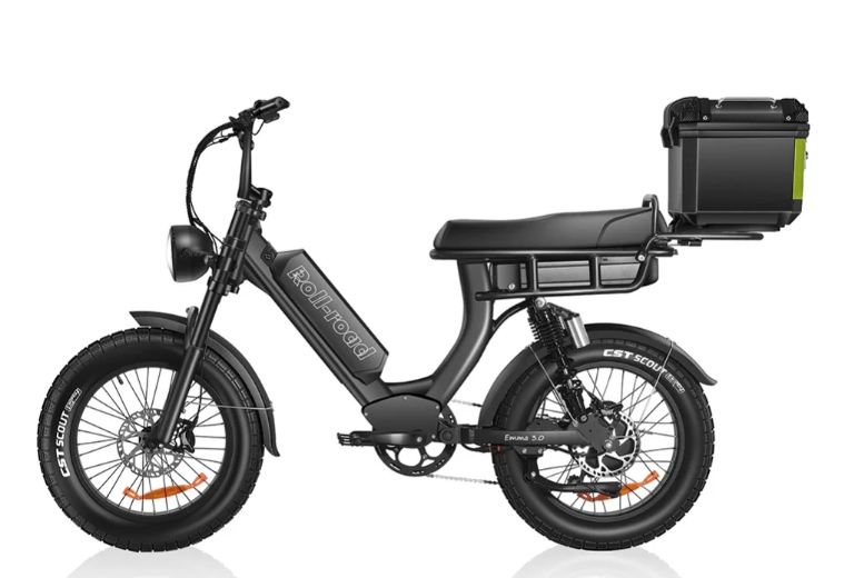

Have you heard of roll road emma 3.0? Two 52V batteries, 1500W bafang motor, full hydraulic suspension. Can hold up to 450lbs payload. And indeed, me and my friend ride out a lot. We have been riding the bike all summer!The total weight of the two of us was 370lbs, and the ebike held that weight perfectly! Also it has a trunk to take all the stuff we need, which makes short trips easy and enjoyable!

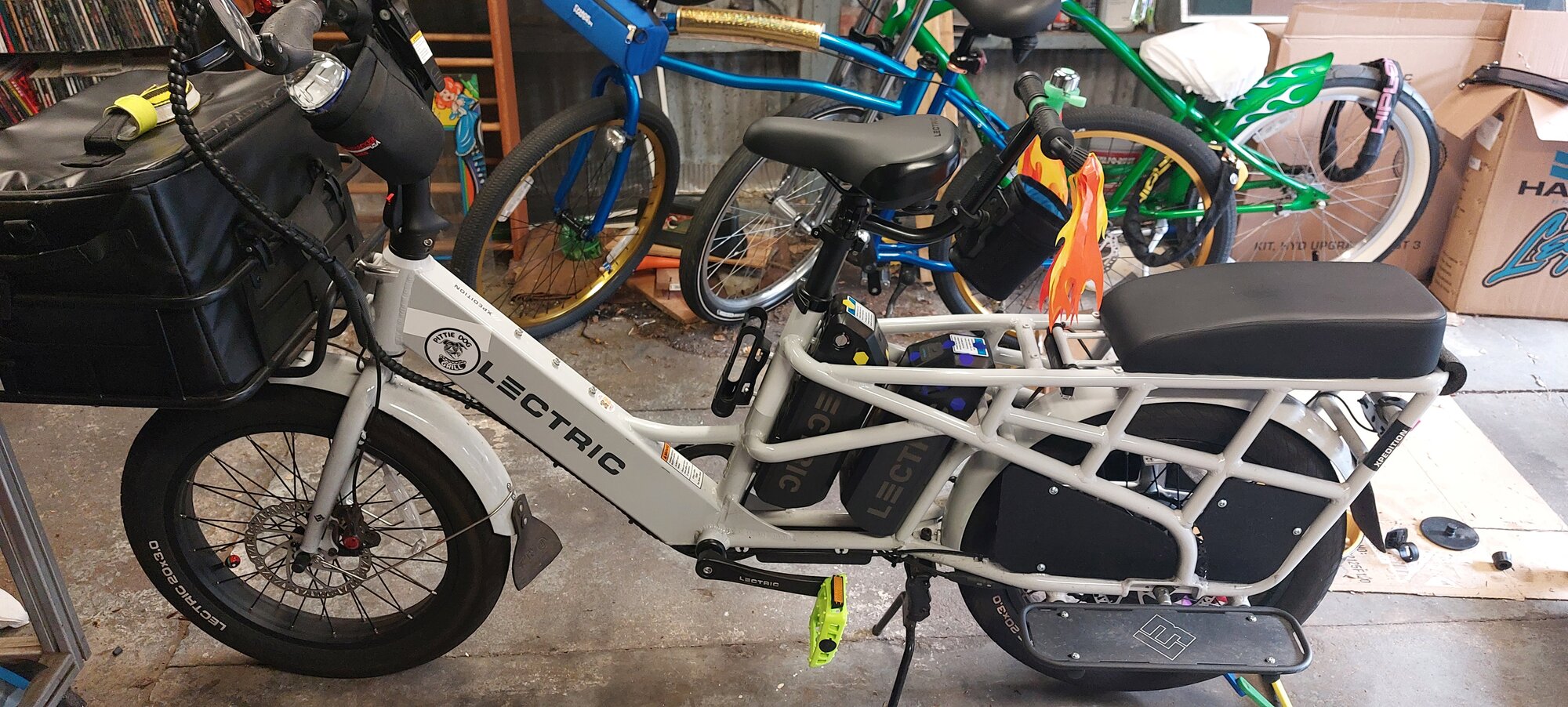

My wife and I ride 2-up on a Lectric Xpedition. It works great for what it is, and the dual battery option makes range anxiety a non-issue. I'll post a picture later as I can't go outside right now because my cats have a vet visit today and their bouncing off the walls wanting to go outside!
If you want more compact a Ariel Rider Grizzly, as mentioned above, would be a good option as well. I considered a Grizzly but I wanted to actually pedal and the Grizzly is more "moped" than the Xpedition.
