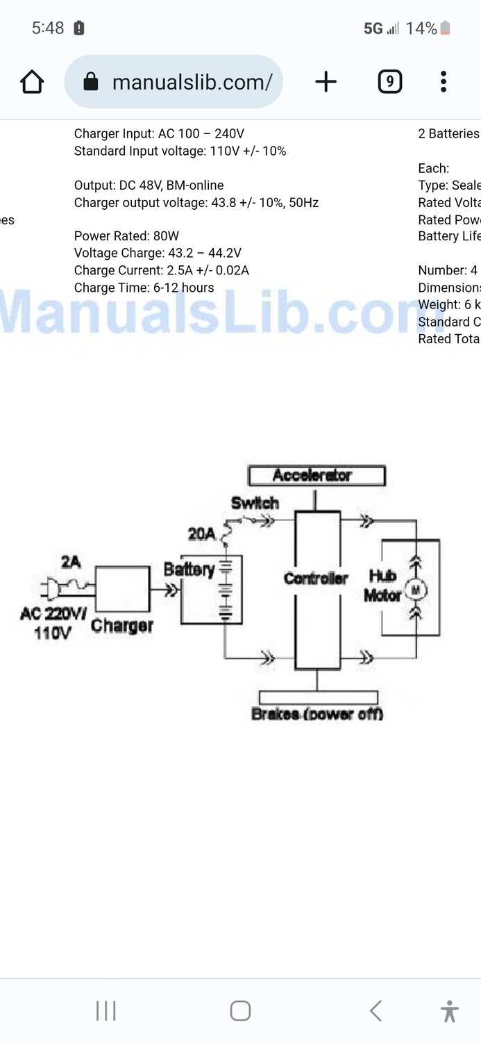

I can only picture in my mind how this would be wired. Did you also replace the ignition switch? If yes, is it an exact replacement?
It seems like the charger wire is connected where the battery should be and the battery is connected where the charger should.
If this is what you have, not a lot to do wrong.
