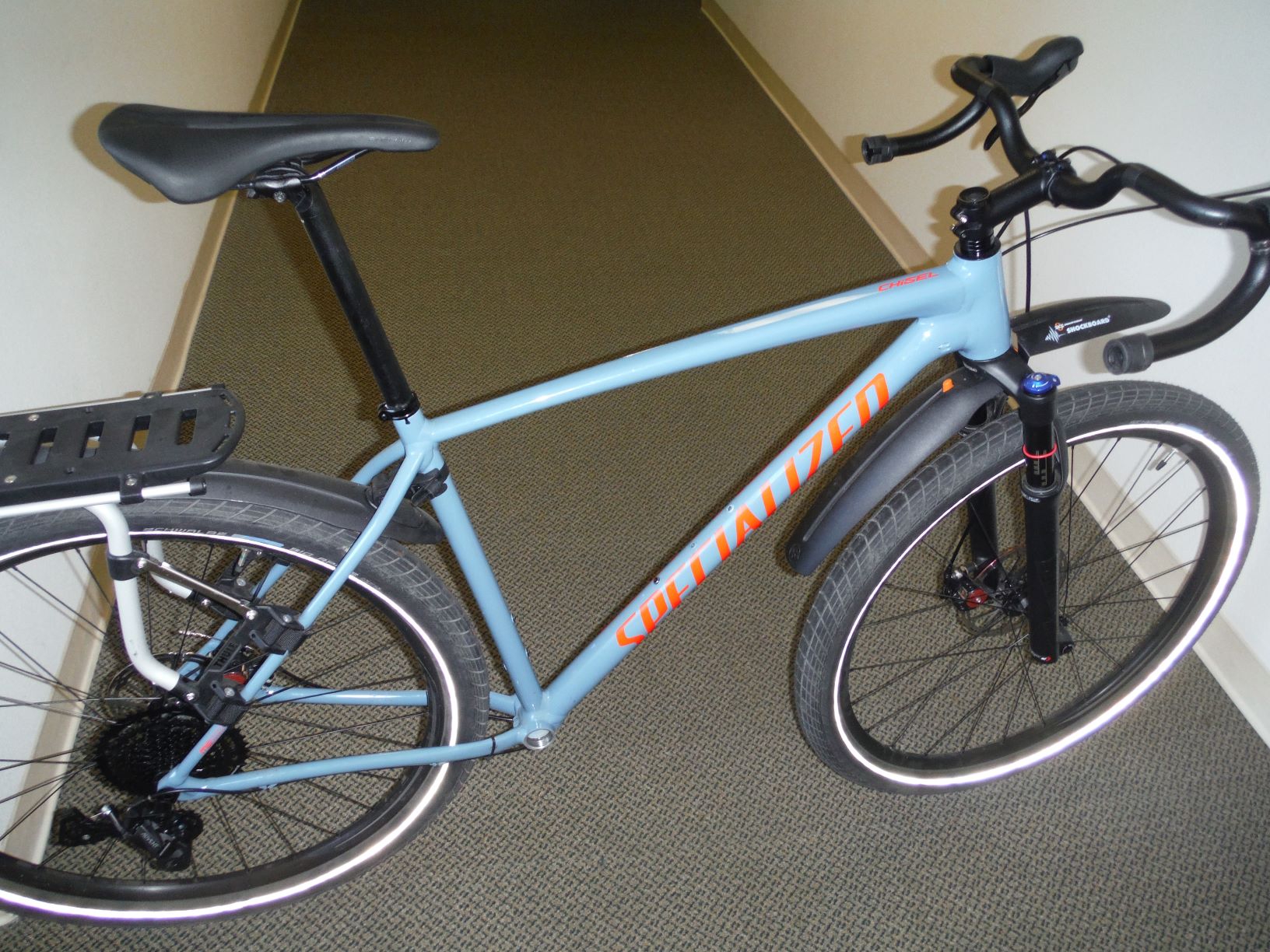

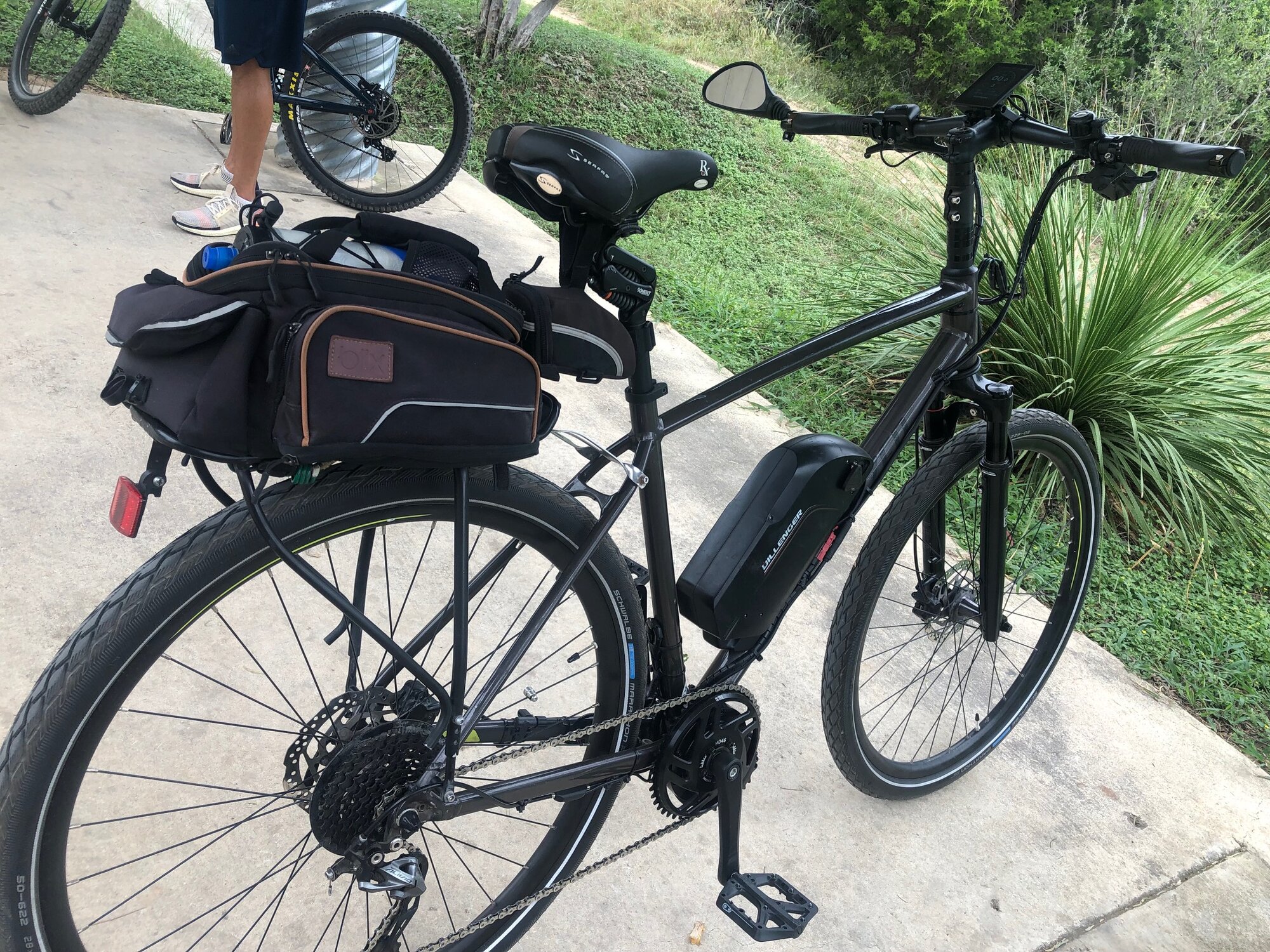

I have a Specialized Crosstrail that I have installed a BBSHD mid-drive kit. I don't find the bike "shooting off" with a lot of speed from a stop with the throttle. In fact, in stock form the throttle is linked to the PAS setting. If you are on PAS 1 you can only go as fast as you PAS 1 would ever allow. PAS 0 you have no throttle at all. All of this is configurable via software with a programming cable if you wish. However, the kit comes with 5 levels of PAS but you can change this to 9 PAS levels through the display on the bike - no programming cable needed.
Before I installed the Bafang mid-drive kit I had previously installed a 750w rear-hub drive kit. On that bike the throttle was not at all linked to the PAS setting and you would "shoot off" with the throttle from a dead stop. (Which I quite enjoyed.)
Also, Bike Lithium batteries are very safe and certainly do not need stored in a sealed case or anything.
You will need some of those bike tools to complete the install - and when ordering you need to know the Bottom Bracket size: 68mm, 73mm or larger. It really is as easy as removing the pedals, the crankset, the BB and slide the motor into place. Installing the speed senor, shift interrupt, battery cradle and display is super straight forward and easy. For me the most difficult part is placing everything on the handlebars, arranging all the wiring and making it look good with 1578 zip ties... well, it seems like that many.

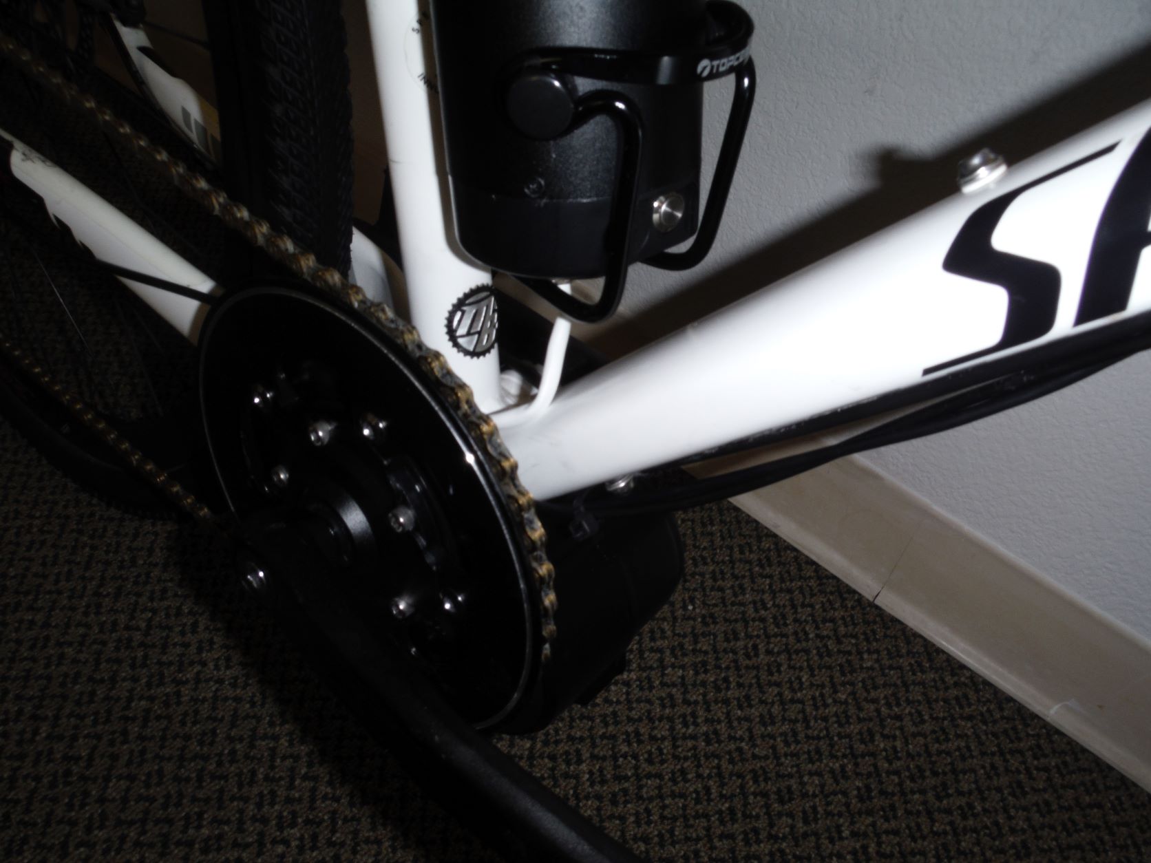

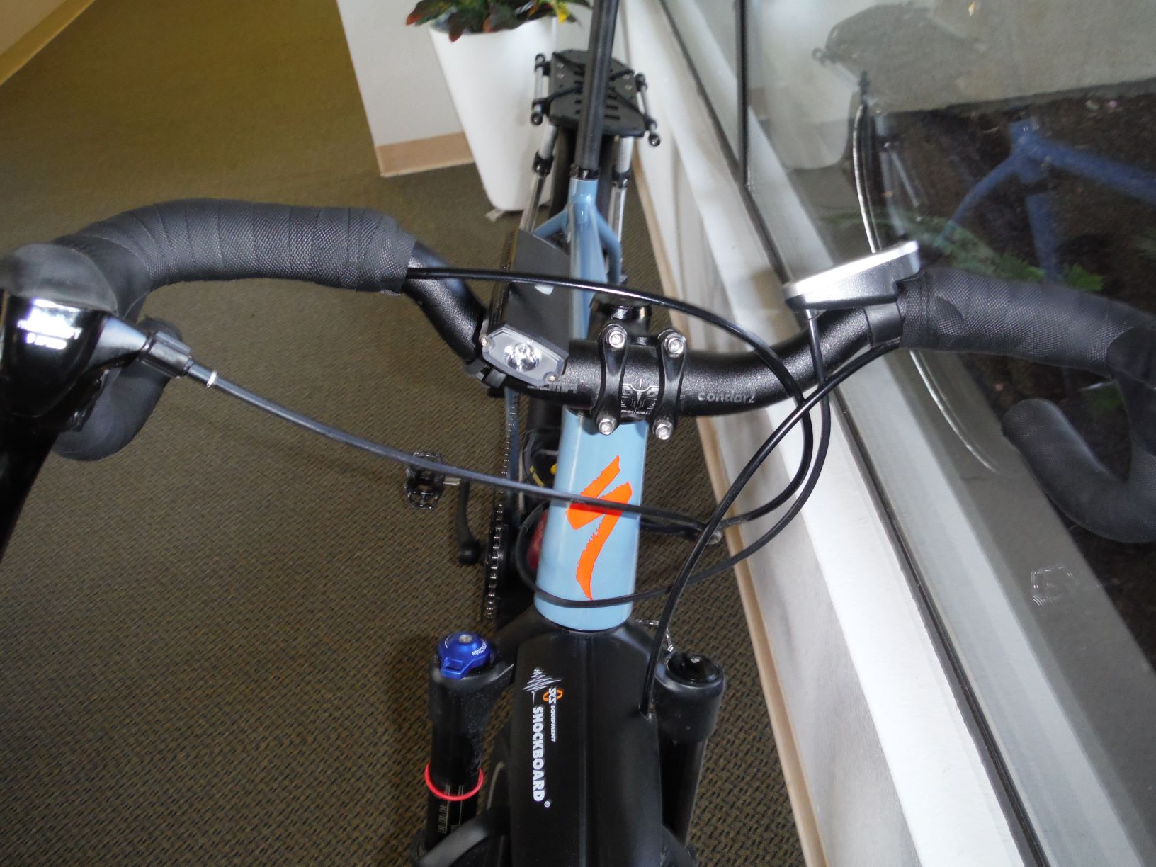

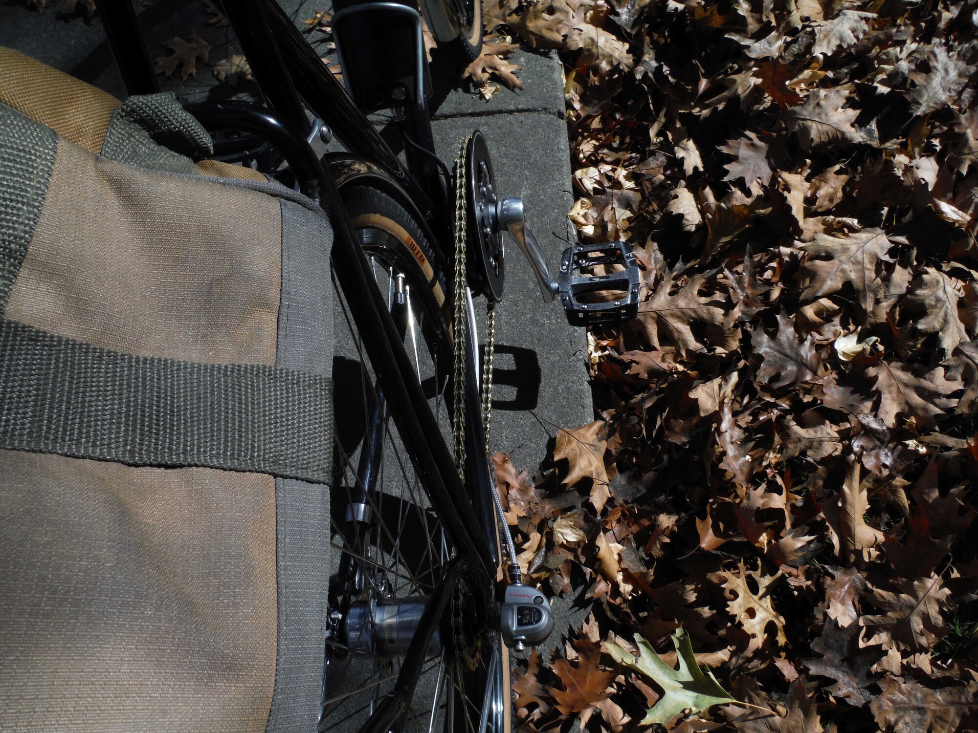

I had a Bafang on a similar bike, a Specialized Chisel. It ate the 11-speed in three weeks. And after the initial thrill it was not all that fun. Surge and lurch. Lag and punch. So I sold that to a disabled guy and went for a smoother and smaller torque sensor motor. The thru-frame of the wiring and rear hose took some reworking. I dropped it to a 9-speed because of the thicker components. And installed a gravel bar. It is a great bike. It feels like the $9400 bikes and not like a bolt-on kit. Look at the wires. Does it look messy?
Good luck!

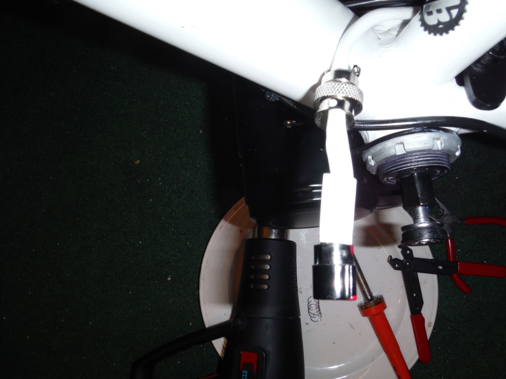

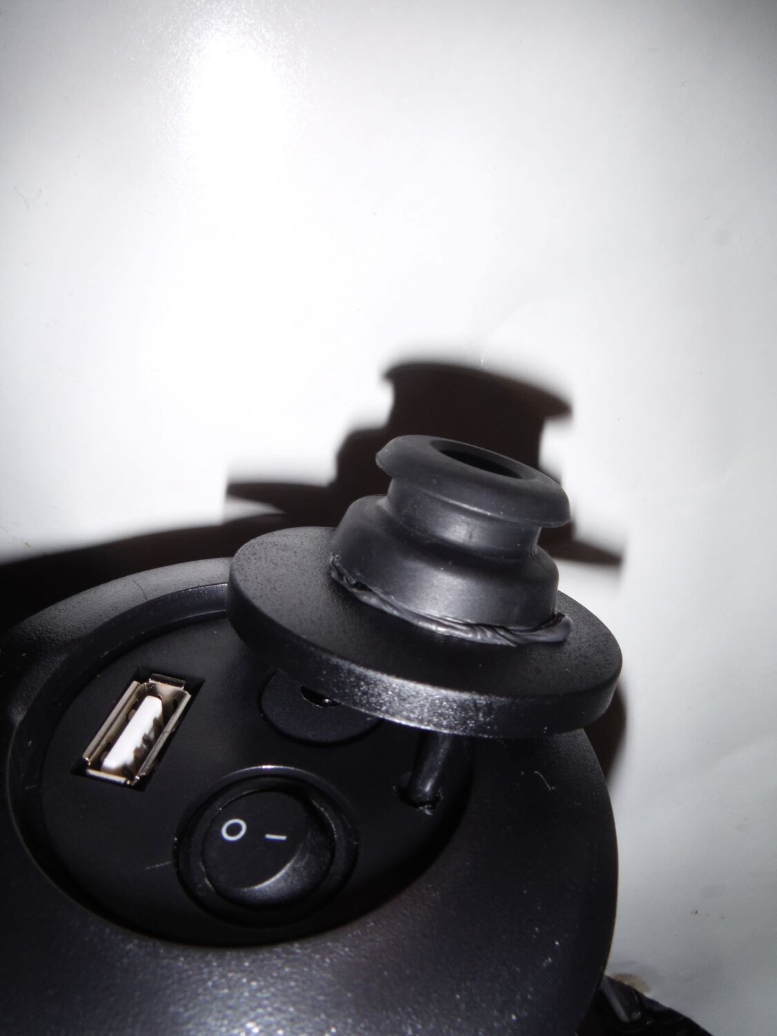

I use this one most often: TongSheng. Or TS. See what other's say. If you want to see some photos and the size of the motors go to PedalUma.com. I am in California, only local. Just letting you know that there are options for you. Get a six pin and do not install the speed sensor, chop it off, seal it, tucking the wire inside the secret compartment behind the chain ring. Set wheel circumference at 100cm and speed limit at 45Km. The six-pin does not allow for a throttle or cut out levers. With a torque sensor the throttle is in your feet. Supper intuitive. Use the thumb sized display.
I have been using the TSDZ2 on most of my builds for four years. My first builds were all Bafangs. Now these are very rare. These hefty Bafangs are for the disabled only, or the occasional porker on a 2.5M long cargo bike. Or people who do not really like bikes. Someone who stepped on an IED and lacks a leg and spheres needs a hand throttle. I get it. And am happy to help. A torque sensor that is lightweight is so much better. These better bikes are acoustic electric. Not electric motorcycles, lurchy, hefty with no feel, like a player piano and not a real piano that is amplified, enhanced.

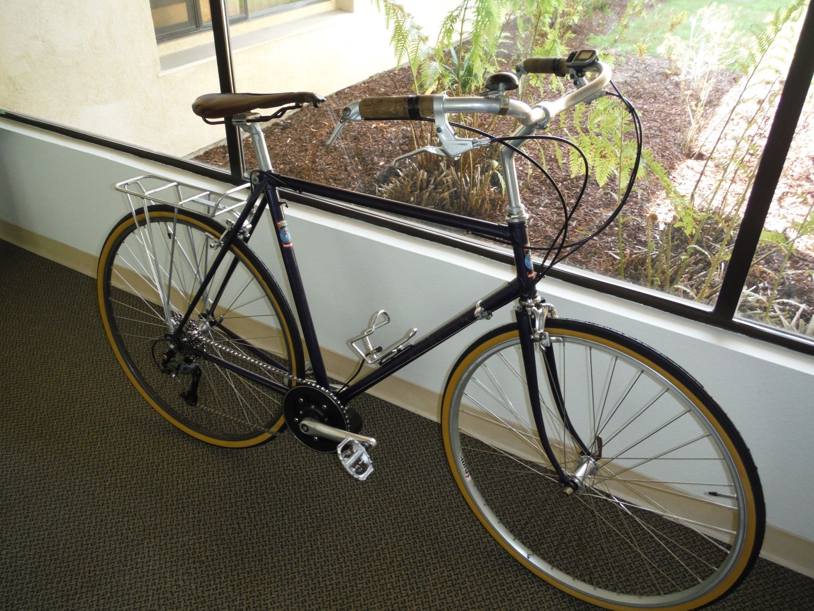

Here is one with a robust chain instead of a Gates Carbon drive. Saving hundreds of dollars annually over five years and providing equivalent performance with a smooth quiet ride. Naturally. Just drop a battery in a standard water bottle cage and go. They do not need to look electric or feel like run-of-the-mill electric bikes with back yard, junk yard pit bull breaded zip ties or bundled wires. Clean. You can achieve superior refinement. While ditching all the heft and crudeness of a Bafang to find a great bike that rises above the expensive stuff in stores.
