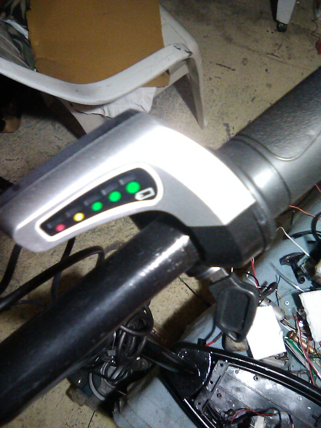

Hey this is gonna sound kinda mess up coming from an old man but I'm working on a e 300 scooter for a mobility scooter and for the life of me I can't figure out why it keeps going full on when I connect the battery. It runs through the speed controller. I have a 36 v motor/battery had a 36 v controller it blew then tried a 24 v( same architecture) both rated 500 w as is motor it worked for a second then went full on me not having turned on the ignition. Can anyone give me some help? I had checked FETS on the 36 v controller one was bad replaced off the 24 then I had to put it back all in all it still went open. What's funny is it was working fine then this. Could it be I have 12 gauge wire instead of 10? I thought 10 and 12 could handle up to 30 amps.

What controls the speed? Is there a throttle? Then look for a broken throttle or bad throttle connection.
On ebikes, throttle is a three wire control using a magnetic chip and a rotating magnet. Power, ground, signal. Power is 4.5 volts if you measure it. SIgnal changes from 0.8V when off to 4.4 volts when max. If the ground wire is broken, ebikes go full ON.
You'd be better off going to a scooter forum. This is all about bicycles. Could be you have a couple bare wires touching somewhere, completing a circuit.

It does sound like a throttle problem.
You swapped FETs from the 24V controller into the 36V? Were they the same part number FETs?
Just to be clear, the 24V controller was hooked up to a 24V battery pack, right?

So if i understand it could be the throttle? I believe its rated at 30 amps

I hear you but shouldn't the controllers work same as each other? I don't think wires are touching but I'm going to check the case to see if anythings touching inside the case causing a contact short of some kind.
