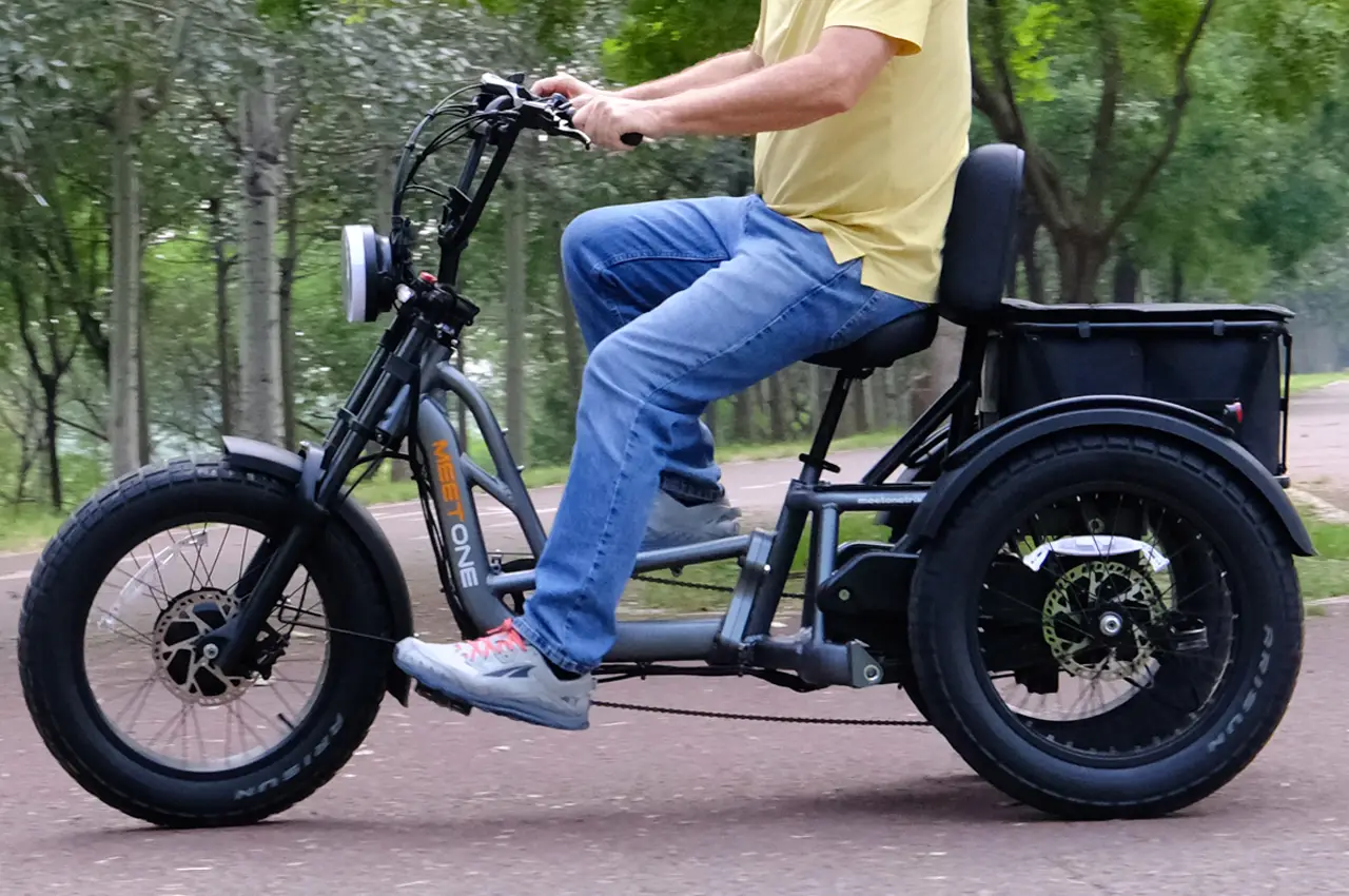

MeetOne has done something unprecedented with the Tour that I wanted to illustrate below.
Look at how low that the seat can be positioned while still allowing easy access via the step through design. Just as striking is the amount of area that the seat can be positioned around the seat post bottom shoulder and the recumbent angles possible from there.
Now take these two features and imagine a frame that can be stretched longer by a teenager in his first shop class for pure comfort...at any desired seating/reclining angle.
It's the 'what if' and a beefed up enough frame to back it up which make this trike special ala the old cars that my generation used to tinker around with/make better.
