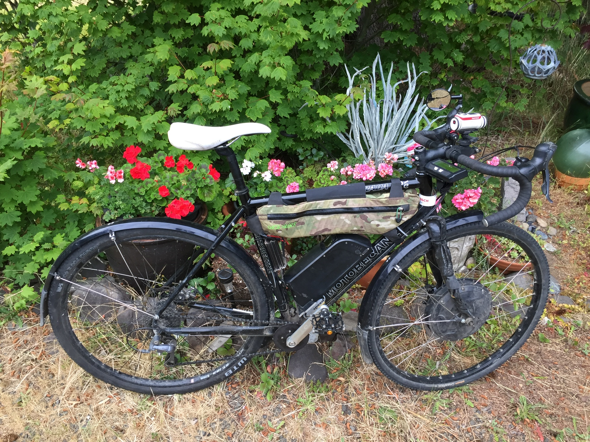

3 positions. Front, Off, Rear packs. Works without matching packs. Several of these done in 2015 and still flawless. 48v and 52v, 10Ah through 23Ah packs. The switches are a bit hard to find but they are a post away if interested. Sorry about notdirectly postingbut I don’t have the file on my iPad.
