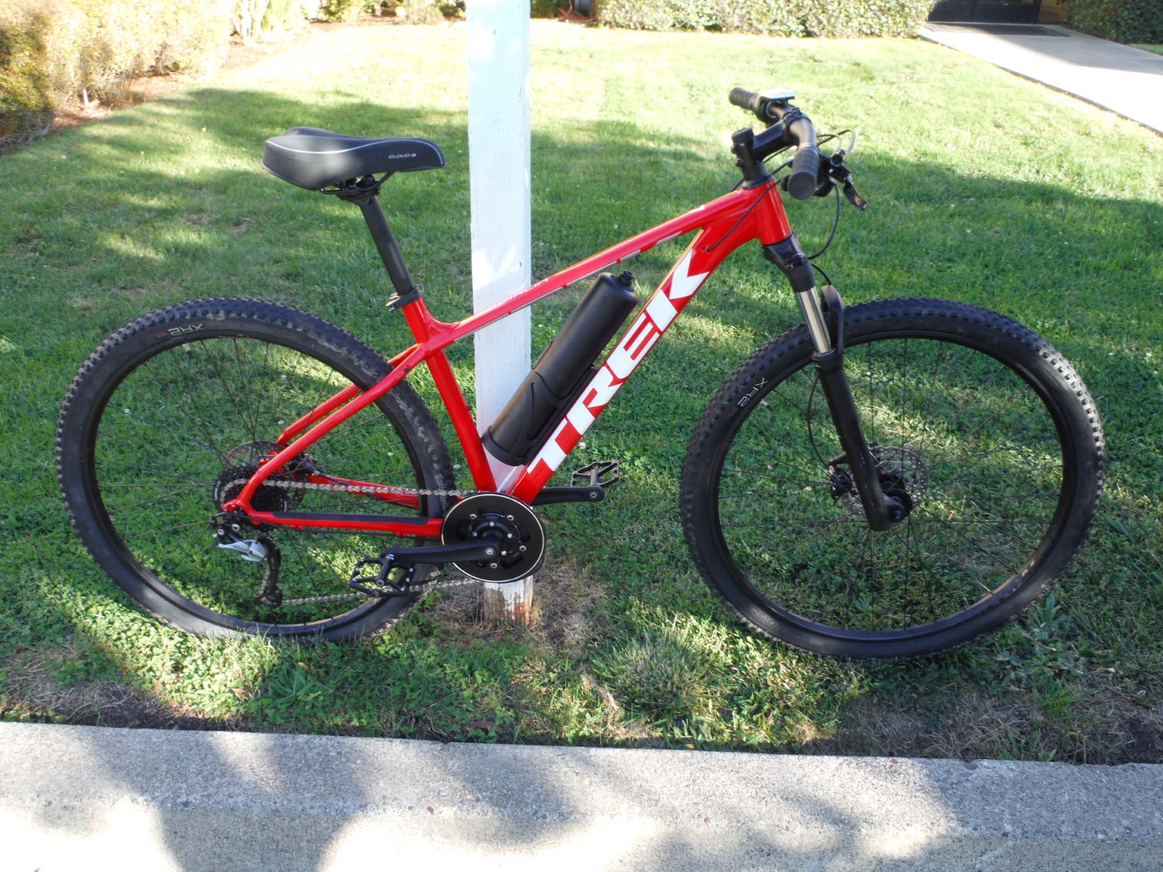

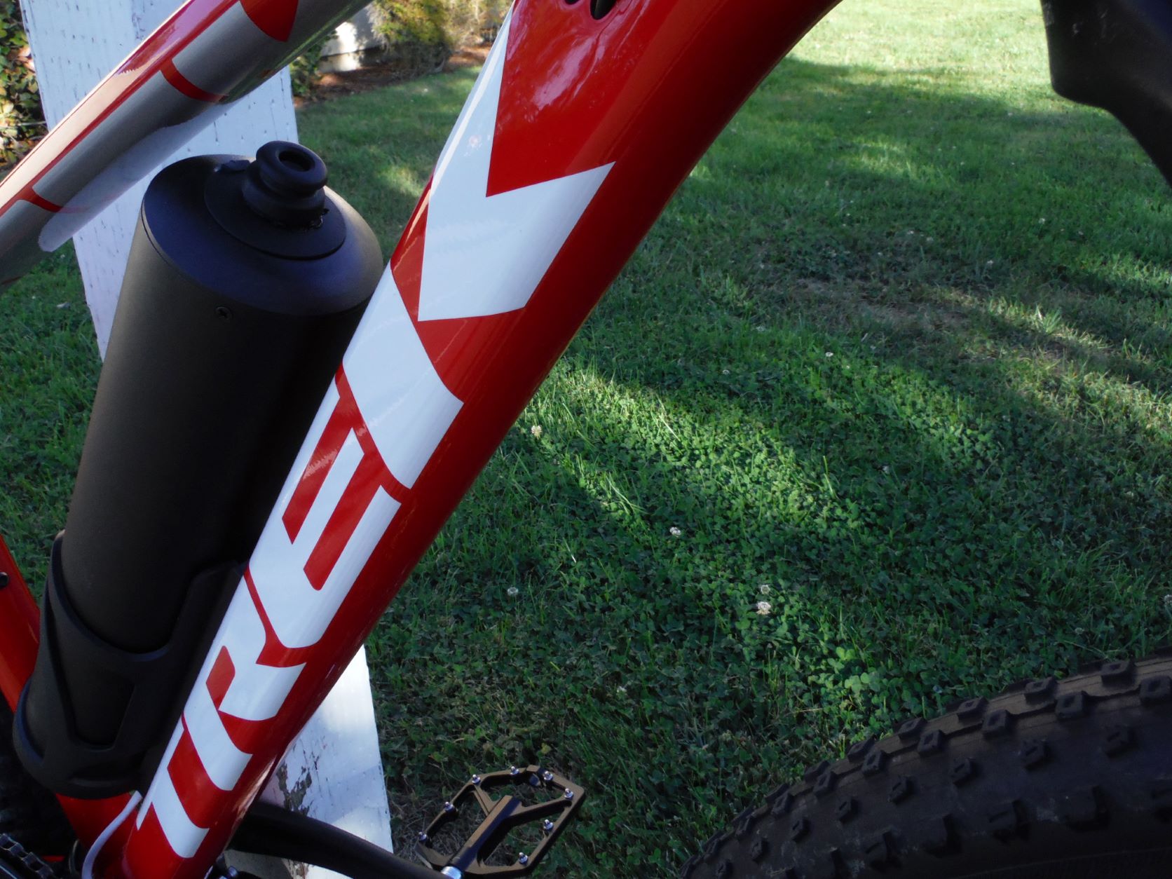

I used automotive ones for years. Now I mostly use the Park Tool VC-1. This bike just went out the door with some tubeless juice. It is 750W with duel clutches. Check the down tube. No butt connectors here. No connectors at all.
