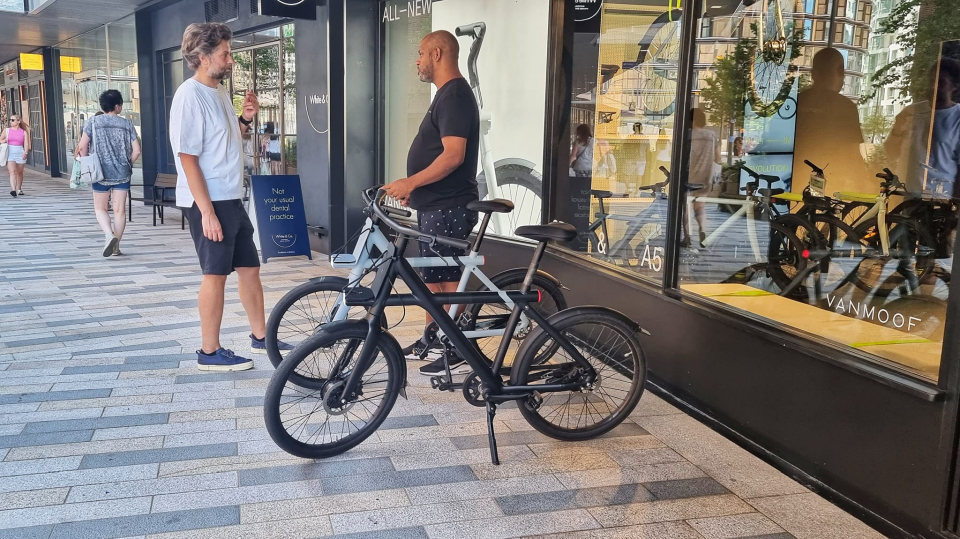

@Chargeride, do you by chance know what happened to that revolutionary e-bike brand that sold so well in Battersea London not so long ago? :)
I saw a lot of youtube shorts on that bike, no idea if it took off.
