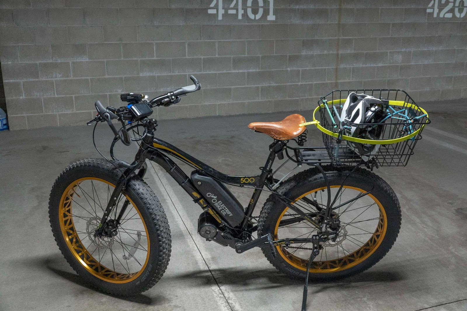

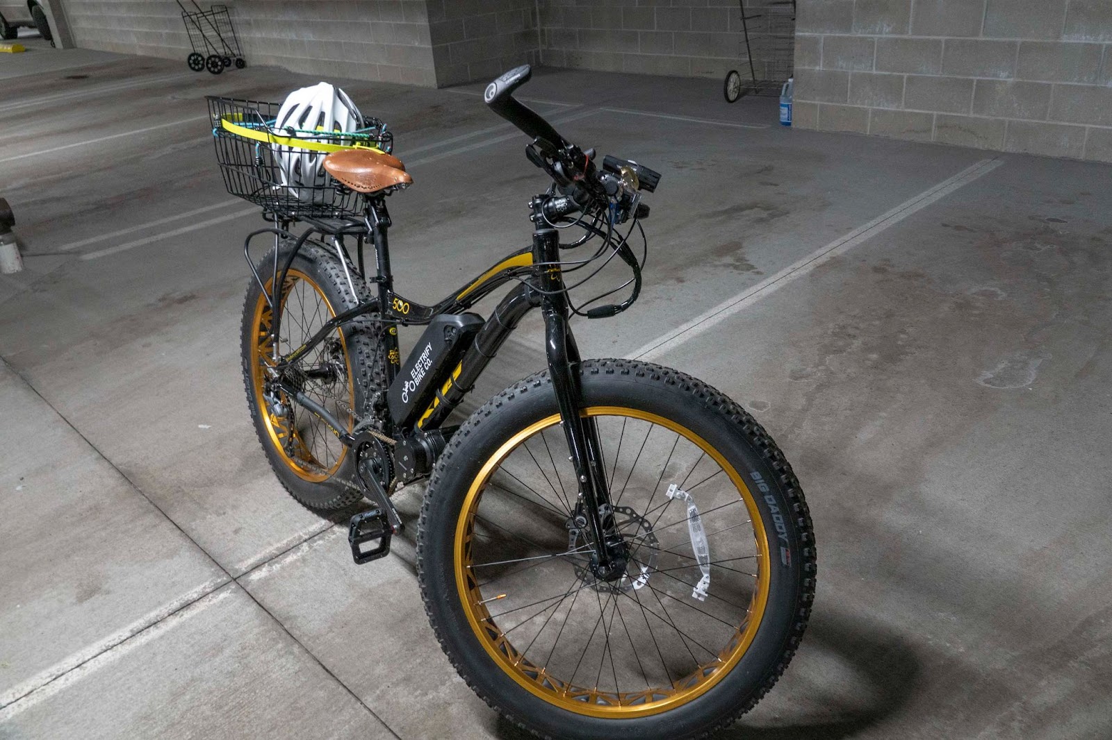

The donor bike is a KHS 17 inch frame fat bike which a LBS happened to have in stock and somewhat “on sale” when I went looking for something to ride 3 or 4 years ago not having been on a bike in about 60 years. I naively thought I could ride it through the snow here in Minnesota but gave up on that Idea after one attempt. Then the year after I got the fat pedal bike I discovered e bikes and have since bought two ( a Frey CC and a Priority Current), both torque sensing mid drives. So to get more use out of the now not much ridden Fat Bike, I decided to convert it and add it as the n plus 3 to my e bike stable to have a wide range of bike tire widths and drive train personalities.
Installation was straight forward with the hardest part removing the old bottom bracket cartridge bearing. The torque sensor PAS works well with power easily modulated by pedal feel at very low speeds needed to navigate around dog walkers and to summit steep wet grassy hills without mishap. Although the motor looks as if it’s escaped from a sewing machine, it feels more powerful than my Bafang Ultra CC, albeit way more noisy even with the brass gear option. Interestingly it seems Luna used to sell an assembled version of this same KHS bike with a BBSHD.
cadence motor installed.
