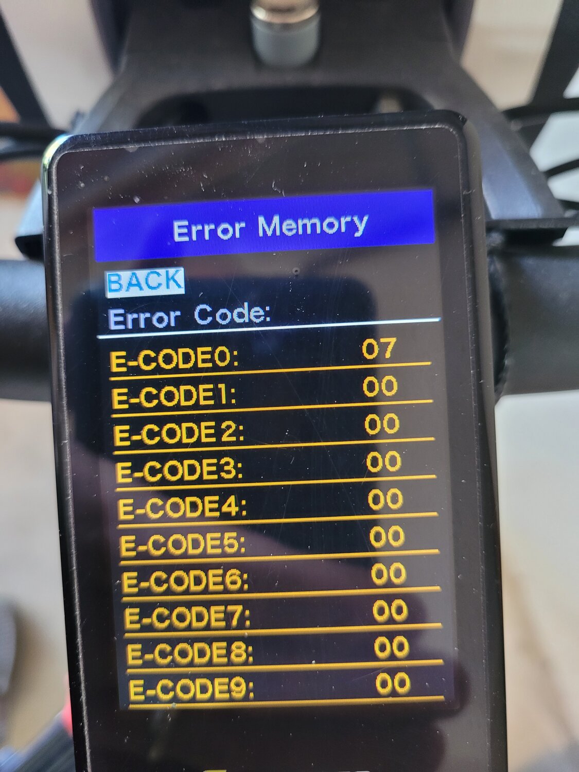

I want to say yes, but I found this.
That’s not a rare error code. Sadly that may be a controller issue AND a display issue.
Bafang shipped a bunch of controllers that posted error code 07 or over voltage. AND the early displays wouldn’t show accurate battery levels.
My controller is rated 48v, but my battery is 52v. I current have a C961 display attached, but i do like the S900 as its more informative.
I have the error code 07 in my advance setting. What does that mean. I am disappointed in the pedal assist, even at level 5. I don't see anything in the setting that could bump it up. I did that on my Magnum and it is a 'beast'. But, that is what cadence drive seems to do. howard
