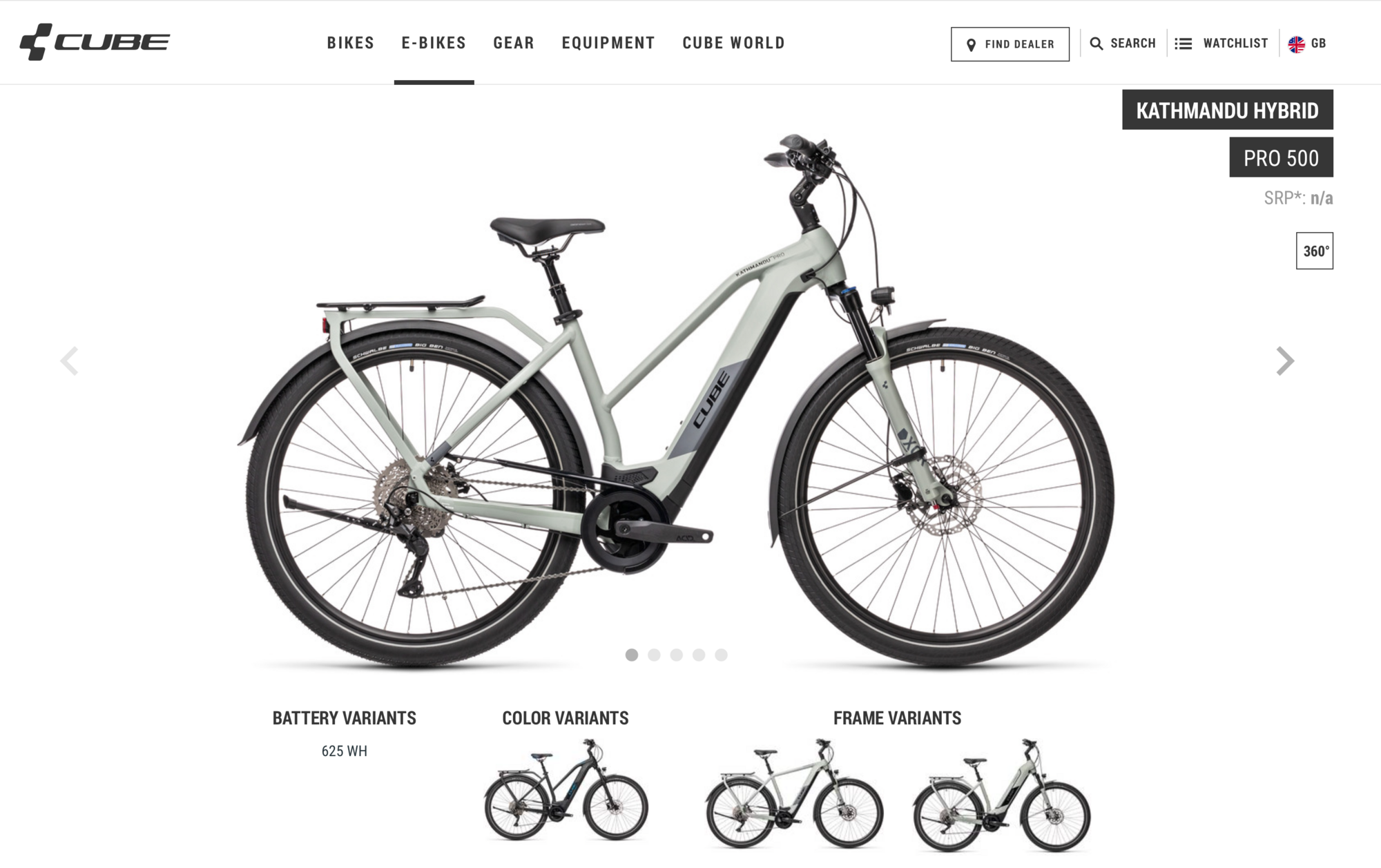

I went to the Cube European site, and they do propose the 2 battery sizes for the same model. Same frame sizes. I only checked the Kathmandu PRO 500 and they do offer the 625 variant (bottom left of the screen). Must be spacers or same size battery pack with different number of cells. I guess that they can offer more models with different battery sizes this way :
I told you how this is possible on my last post above! The upper mount is movable between two positions covering both batteries! Its not only Cube doing that, and I actually find it a very clever solution.
