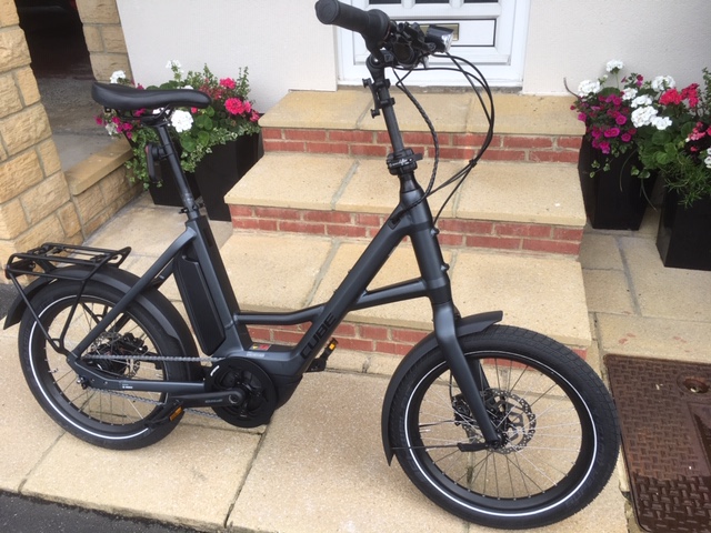

I have been a great fan of Brompton for many years, latterly having a Brompton Electric 6 speed..... the fact you couldn't change power without stopping and pressing a button on the battery was "inconvenient" to be polite about it! Also wheelspin from the front hub was dangerous on even slightly gravelly surfaces found at the edge of many roads.... so it had to go!
I wanted a Bosch crank drive bike which wouldn't take up too much room in the garage.
I saw the publicity for the Cube Compact and went for a test ride.... I was so impressed I bought one straight away.
I really wanted the "Sport" version with the slightly more powerful motor but Cube had run out of them.
I'm so pleased I didn't get the sport as I think the "mech" seemed to hang very close to the ground and who really needs 10 gears on an electric bike?
I'm 6'7" and about 17 stone living in a VERY hilly area. I cannot believe the power from the new Bosch Active Line Plus motor, it's unbelievable and the twist grip 5 speed gear change is very slick... also the motor is so quiet I can't hear it above the noise from the tyres on the road.
The way I can fold the handlebars through 90 degrees makes storage an absolute dream... no more complaints about the handlebars catching SWMBO as she walks past it.

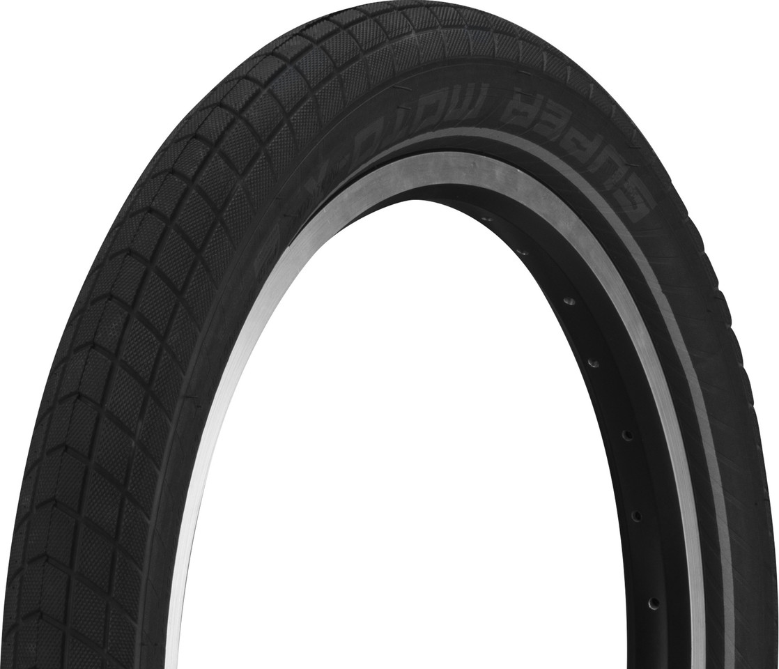

Now I have another question, I almost got a puncture (just removed a nail but the angle was huge so tube seems unaffected). I did almost 20 km with the nail in the tire , I know that as I was listening to it from the very beginning of my commute. Therefore I thought that it would be a good idea to be prepared for the future in case I get a real puncture. I know that the tyre we have is the super moto-x and thinking of getting one or two from bike24 but have no idea what tube we need. Ooops! Just noticed the the tire is not in stock there! Delivery time 18-19 weeks!
Regarding the tubes from my research i guess this air plus is suitable. Correct ?
Generally i would like suggestions for tires and tubes. Have in mind that the roads here are bad, I bike with a front suspension would be better suited than ours.
Thanks
That was the reason, more lubrication was needed.
Thanks
Check this site too:
And this is the tube I would use:
