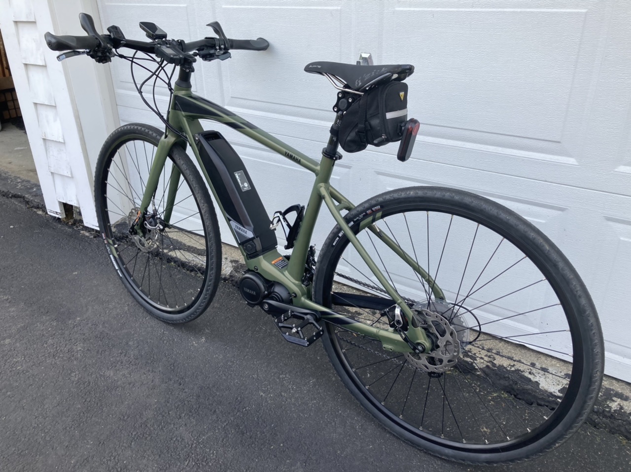

You have white cables? Mine are black. Did you buy bike new, those are OEM?
The cable housing is not original. I first went with bars with 45 degree back sweep and needed longer cables. This current setup probably does not need longer cables.
Look at my modified Cross Core drivetrain.

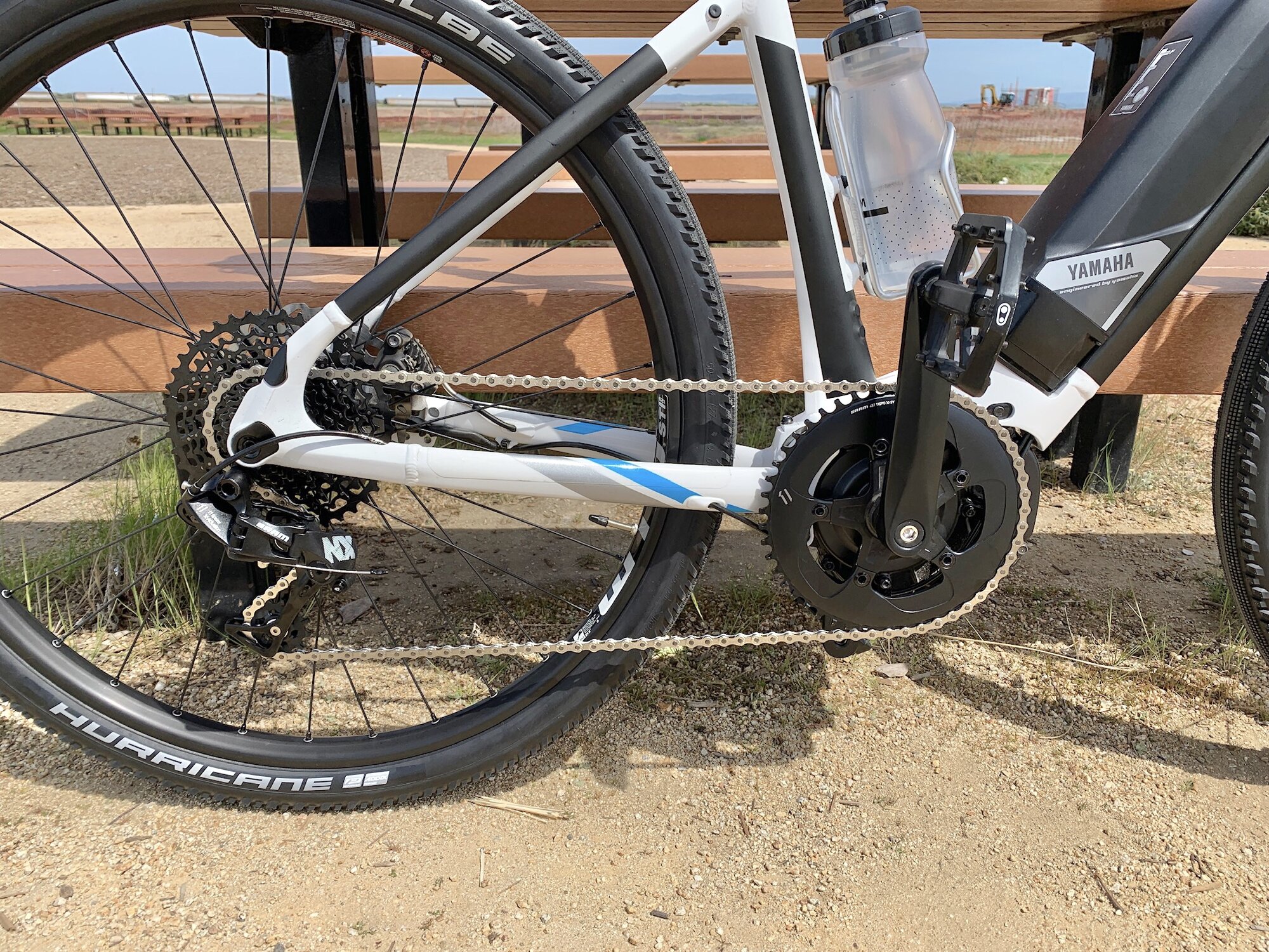

A note to the poster who didn't like the double chainring.
I went to a 40 tooth inner ring and only use the inner ring. I took off the front derailleur and shifter and am much happier!
42 tooth probably would be fine too. In the future, if I find myself mainly in the 11-13-15 cassette gears in the back I may put the 40 tooth as the outer chain ring for straighter chain travel.

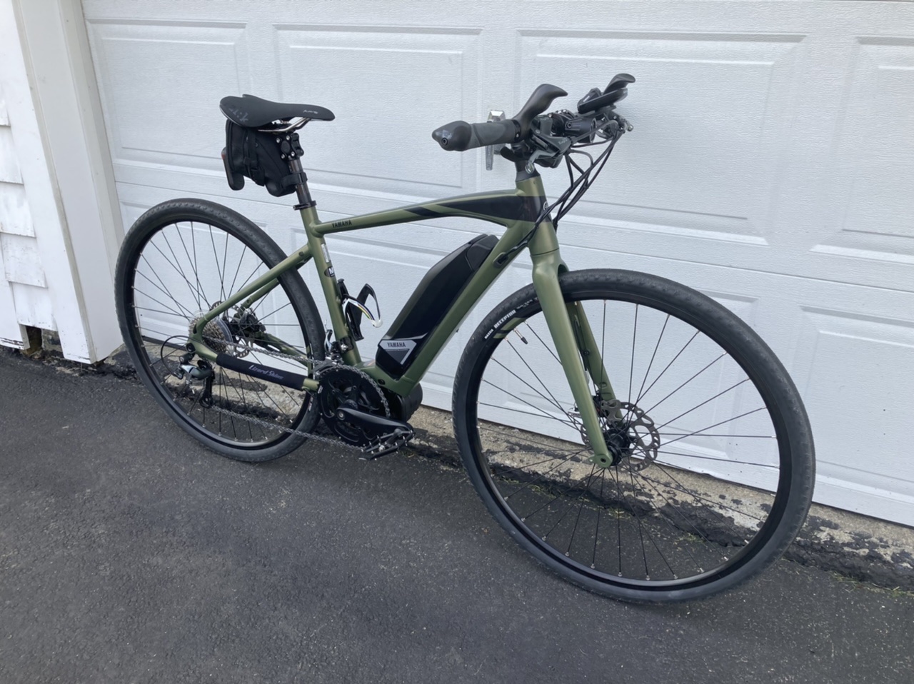

I’m new here, and new to Ebikes, but I have been a cyclist for nearly all of my life. I chose the Cross Core partly because it was such a good value and a good place to begin a customization. I immediately changed the tires and tubes, seatpost and saddle, next came the bars and pedals, followed by brakes and cables, shifters and derailleurs. There was really nothing that needed to be changed and the bike works fine right out of the box. I had initially wanted to get a Wabash, but then I compared it to the Cross Core and there was not $1100.00 difference in the value, so I made the Cross Core into a flat bar Gravel Bike with inner bar ends and 17 degrees of sweep on the bars. It provides a great and fun ride and still came out to be less expensive than the Wabash, (same frame, wheels and motor, and I would have changed out the saddle, seatpost, tires and pedals on the Wabash too). I’m having a lot of fun with the Cross Core and it’s nice to have a three year warranty.
what stem are you using? I have carbon fiber bars with 20 degree backsweep and went with a 120 mm 17 degree stem. I am thinking of going to a 120 mm 6 degree Kinekt stem to smooth the ride. I will say the carbon fiber bars and 40 mm tires have reduced the shock level a good amount.
The stem is stock. I am using Salsa Deluxe Bend bars with 17 degrees of sweep. They seep forward, then back, so the reach is unchanged.

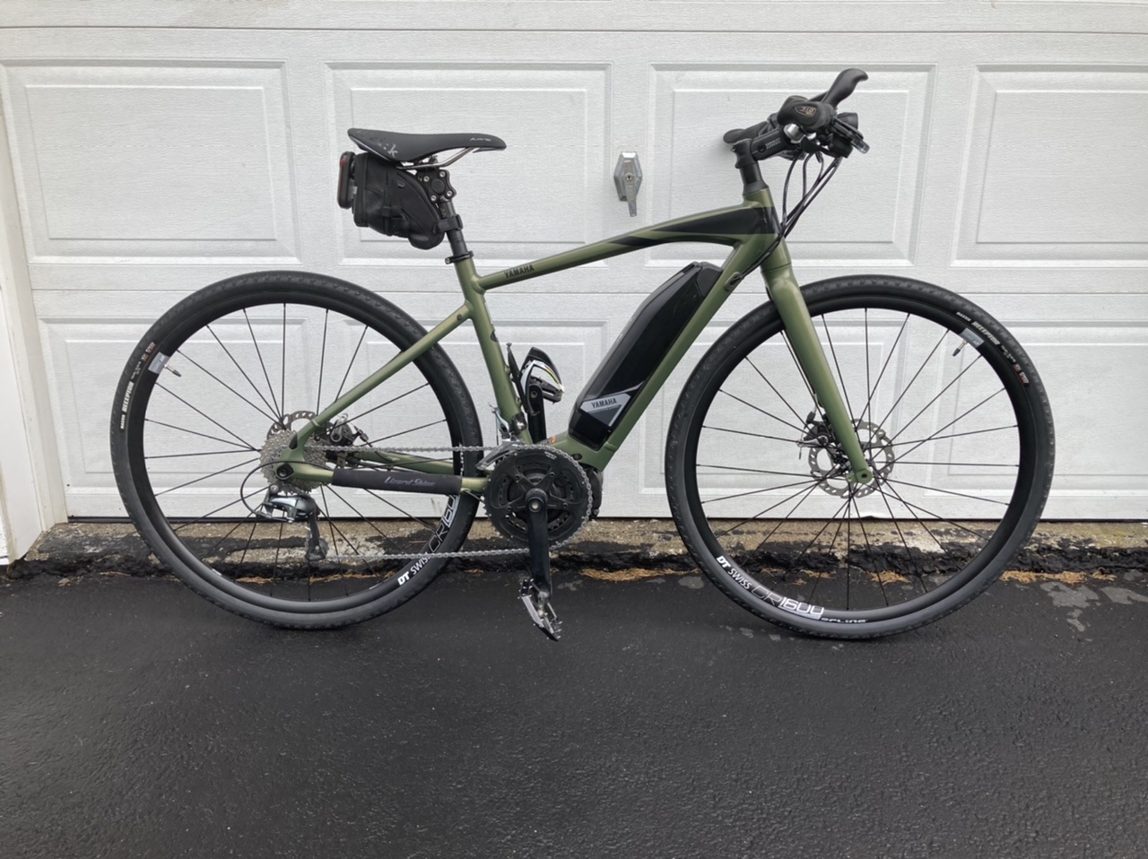

Unfortunately, Yamaha has a serious supply line issue. I had a rear wheel issue, which I was able to resolve by upgrading to DT Swiss CR 1600 wheels and machining a groove onto the end cap to locate the speed sensor. Another forum member is having a hard time getting a new speed sensor, (unfortunately, there is no workaround for him). Part of the reason that I bought the Yamaha was the 3 year warranty and the fact that they are not a “fly by night“ company. Unfortunately, rather than trying to help a customer, they are just throwing up their hands and blaming the supply line problem, (a better company would come up with solutions).
On the plus side, the DT Swiss CR 1600 wheels are a nice upgrade and my very upgraded Cross Core is a very nice gravel, rail trail and road riding bike. It handles very well and moves right along, even when I am riding past any assistance. In addition to the wheels, mine has Maxxis 40 mm Receptor tires, a Tiara 4700 drivetrain, Salsa Deluxe Bend bars, Carbon inner bar ends, Spank Oozy pedals, Fizik saddle, Cane Creek carbon eeSilk gravel seat post, Red Shift stem and TRP Spyre brakes. That may sound like a lot of changes, but except for the wheels, it still came out less expensive than a Wabash, and it is more to my liking.

Bummer about the issues. The bike looks fantastic, though and I bet it rides better than ever. If/when I need to change out my wheels, I think I'll go with 650B for even more suppleness.
I was surprised at how supple they are. I assume that it is probably a combination of lacing pattern, reduced spoke count and mostly, that the inner width of the rims are 3.25 mm wider. I had a good ride today with a mixture of gravel and paved roads, and some good climbs. I wasn’t noticeably faster, but the difference in suppleness was striking. I run 40 mm Maxxis Receptors at 45 psi and I already have a Red Shift suspension stem and Cane Creel eeSilk Gravel seat post, so the ride was already nice, but the new wheels made a significant difference. I would have preferred to keep the $706.00 in my pocket, but I will have a nicer ride long after I have forgotten about the added expense.
My “acoustic” road bike has Shimano Dura Ace C24 wheels and my previous road bike was a Specialized S-Works Roubaix that came with $3000.00 wheels, so I guess that I shouldn’t gripe about $706.00 wheels for my eBike, (being retired has tightened the purse strings a bit).
