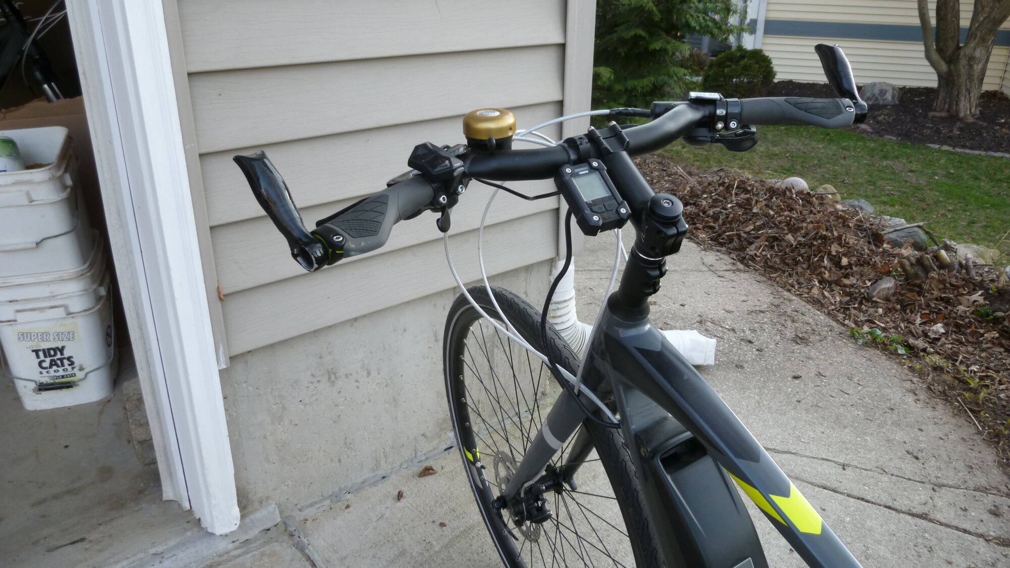

I added a 115mm stem riser to my CrossCore to raise the bars. That was the shortest I found and raises the bars around 2 inches. So far feels solid and stable. I also switched to the same sintered/metal brake pads and pedals used by Dan212. That particular type of pedal is quite nice. The middle of the pedal is flat, unlike some other pedals. Also, the bearings do not need adjustment.
Did you have any problems raising the handlebars. When I tried to raise mine, the electronic cable had no slack and I wasn't able to raise the handlebars at all. I would need another couple inches on the cable to be able to raise the handlebars..
I am wondering same thing? 2 inch rise would be nice, wondering if frame size has any relevance, e.g, the cables are all standard length but less excess on large frame. I have the large frame.
Frame size could be a factor for slack in the display cable. I have a medium frame and had no issue. The picture shows use of a stem riser plus a long stem. I may re-arrange the stem spacers to drop the bars down a bit. Those are zero rise Origin8 Batwing handlebars. The bar ends are not needed with those comfortable bars.
You have white cables? Mine are black. Did you buy bike new, those are OEM?
You are probably right about the frame size, I have the large frame and there is no way I could lift my handlebars even half that amount. They left no slack at all on my display panel cable..
I wish there was some type of parts catalogue, we could look up P/N and see if they are same number all around. Yamaha usually does a good job with parts supply and ID. How does dealer order parts, there must be a microfiche (yeah, i'm showing my age)
