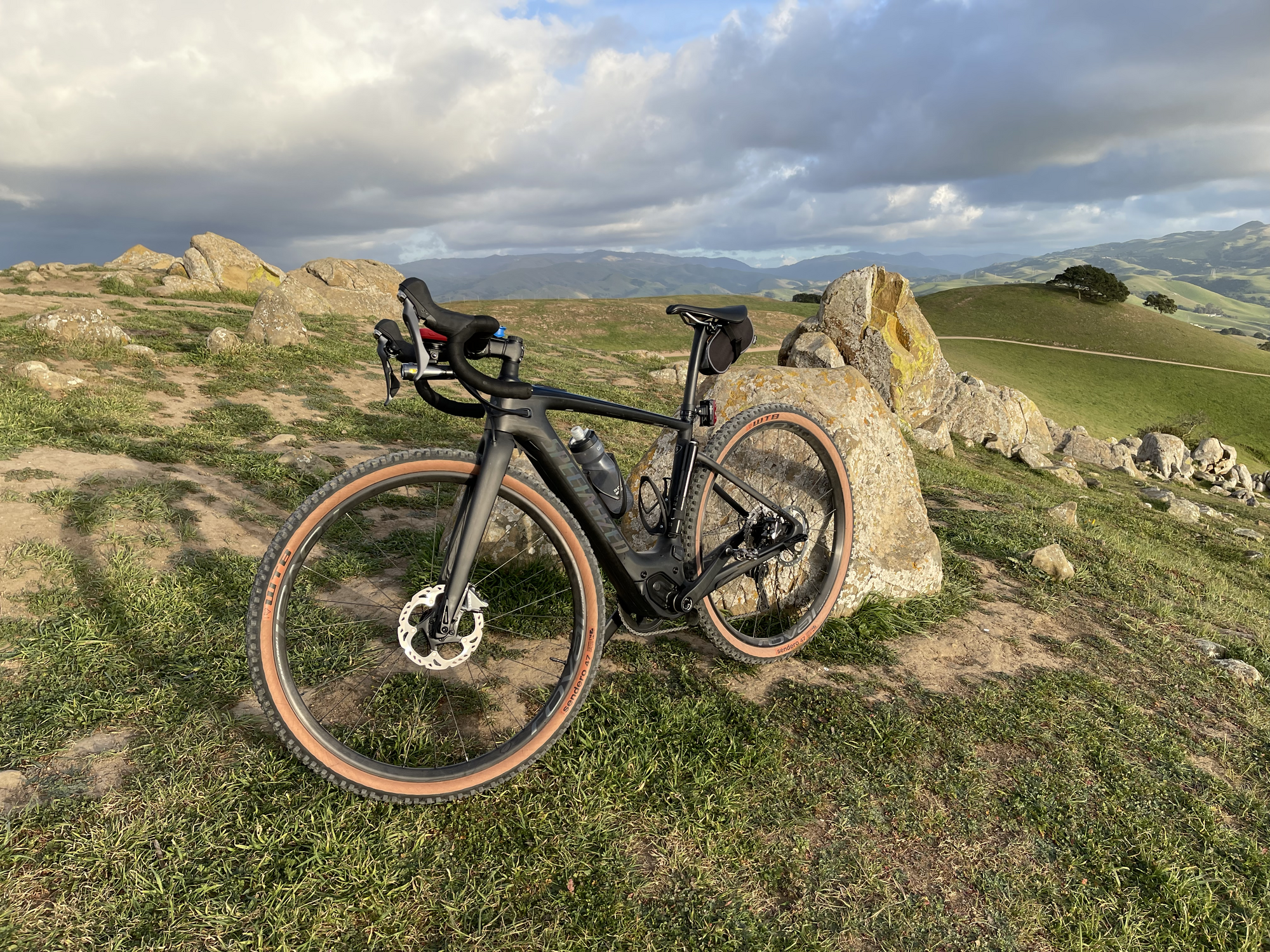

Greetings, I’m a new member so excuse my first post in case this has already been discussed. I have a Creo Turbo carbon comp which I’m in the process of modifying to better suit my riding and location. I’m in North Florida so I don’t encounter any climbing to speak of and I’ve found the stock cassette and chainring to offer inadequate gear ratios. I will swap in an Ultegra 11-32 and Wolftooth 50 ring instead. Those ratios will be closer to what I ride on my analog Colnago so I can better compare heart rate, effort etc. bike to bike. I’ve rarely used anything other than the Eco mode but find I spend most of the time on the smallest 3 cassette cogs. I’ve also purchased the turbo remote control, and will do the entire makeover once I purchase the Roval Terra carbon wheels as described above. My question is this: has anyone (maybe mschwett above?) who has swapped out the stock wheels done anything with them such as converting them to occasional gravel use with fatter tires? Sold them? Not sure what bikes could use the boost hubs. Just looking for ideas or suggestion. Thanks so much.
I got a Specialized Traverse 27.5 alloy Wheelset with WTB 650B x 47C Sendero knobby tires. I believe Specialized also makes a carbon version of this Wheelset.

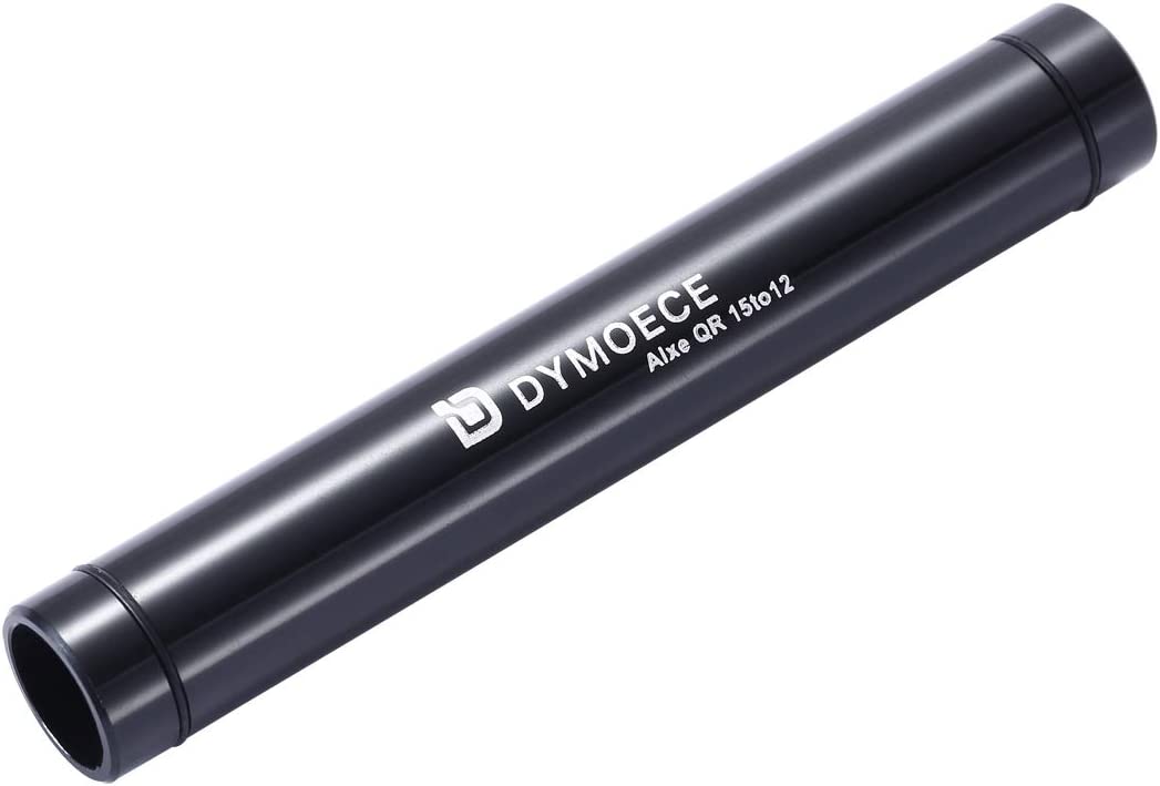

On Paper the front hub is damn awkward to fine as so few bike use the 110 x 12 standard. However, but using a simple sleeve to reduce from 15mm to 12mm means you can use MTB 29er boost wheel. I have a set on mine and down thousands of miles on then with zero issues.
"simple sleeve to reduce from 15mm to 12mm"
can you share and post some pics on this.
I use something like this. It is 100mm rather than 110mm, but this is not an issue and works well for me. Must have done 3000 miles or so on it
