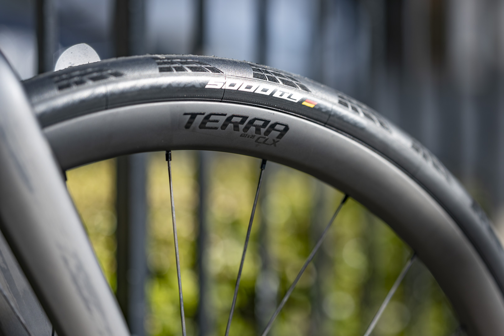

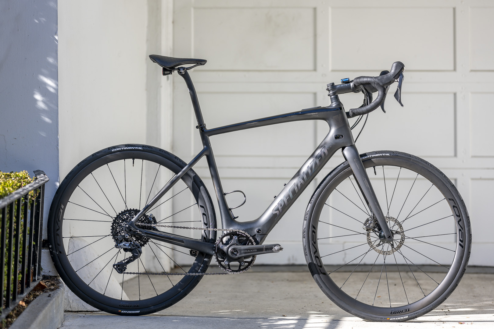

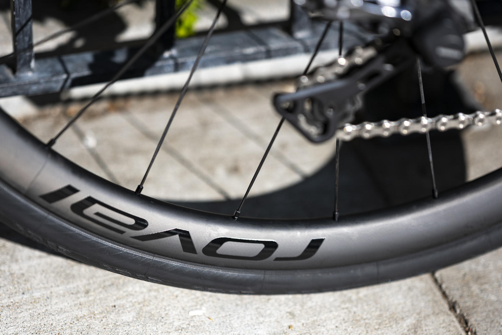

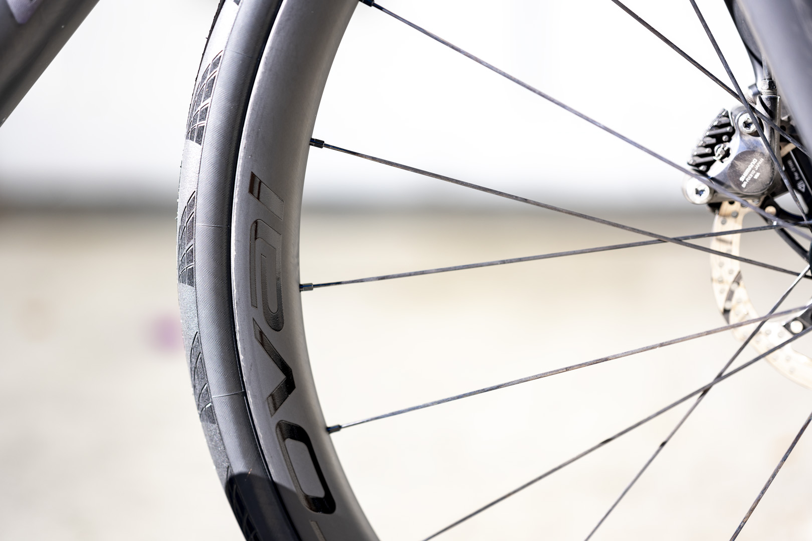

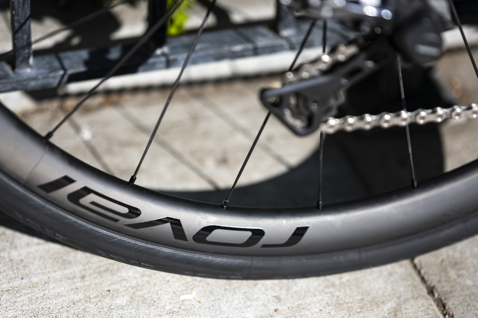

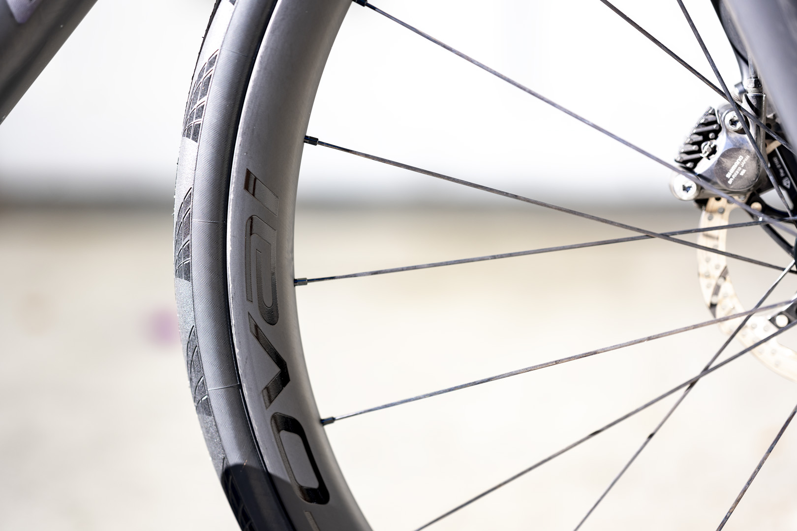

i decided to go the easy route, and picked up the roval terra clx, since they tick all of my boxes - light, tubeless ready, understated, slightly more aero than stock but not too deep for the crazy crosswinds i ride in.
for the weight weenies, the total weight of my original rear wheel including cassette, driver, wheel, tire, tube, and QR axle was 2,176g. current setup (10-42t instead of the stock 11-42t) weighs in at 1,679g - more than a pound of rotating mass in just the rear wheel!
apologies for the terrible photo. it's nighttime.

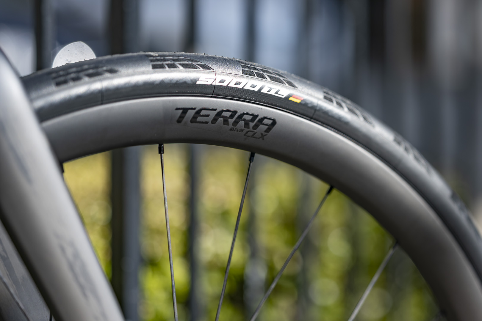

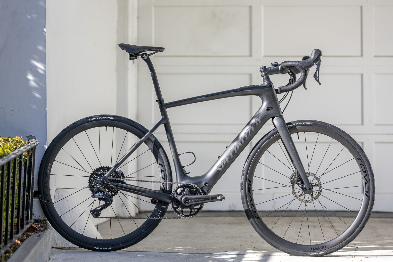

those look nice! no idea what it would take to get the right spacing, it isn't just the end caps, afaik, but the actual hub in order to keep the wheel centered and the cassette in the right place.

lol yeah, i had been debating what wheels to get / have made for a long time. didn’t realize the Terra CLX were tubeless compatible, and readily available in boost spacing. stopped by the shop on a quick break from work friday morning!
mike’s didn’t have the right freehub driver, and it would have taken them much longer to get it than me (?!?!?), so i took the bike back and did it myself after they mounted and filled the tires with sealant. i’ll try and do that myself next time too!

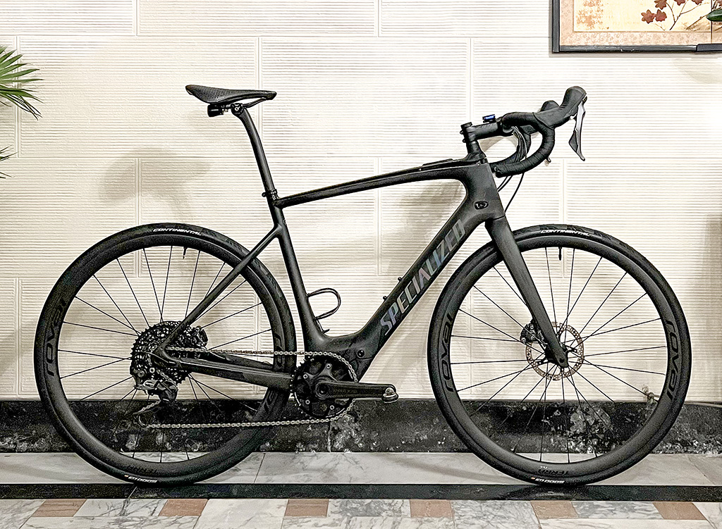

Greetings, I’m a new member so excuse my first post in case this has already been discussed. I have a Creo Turbo carbon comp which I’m in the process of modifying to better suit my riding and location. I’m in North Florida so I don’t encounter any climbing to speak of and I’ve found the stock cassette and chainring to offer inadequate gear ratios. I will swap in an Ultegra 11-32 and Wolftooth 50 ring instead. Those ratios will be closer to what I ride on my analog Colnago so I can better compare heart rate, effort etc. bike to bike. I’ve rarely used anything other than the Eco mode but find I spend most of the time on the smallest 3 cassette cogs. I’ve also purchased the turbo remote control, and will do the entire makeover once I purchase the Roval Terra carbon wheels as described above. My question is this: has anyone (maybe mschwett above?) who has swapped out the stock wheels done anything with them such as converting them to occasional gravel use with fatter tires? Sold them? Not sure what bikes could use the boost hubs. Just looking for ideas or suggestion. Thanks so much.
