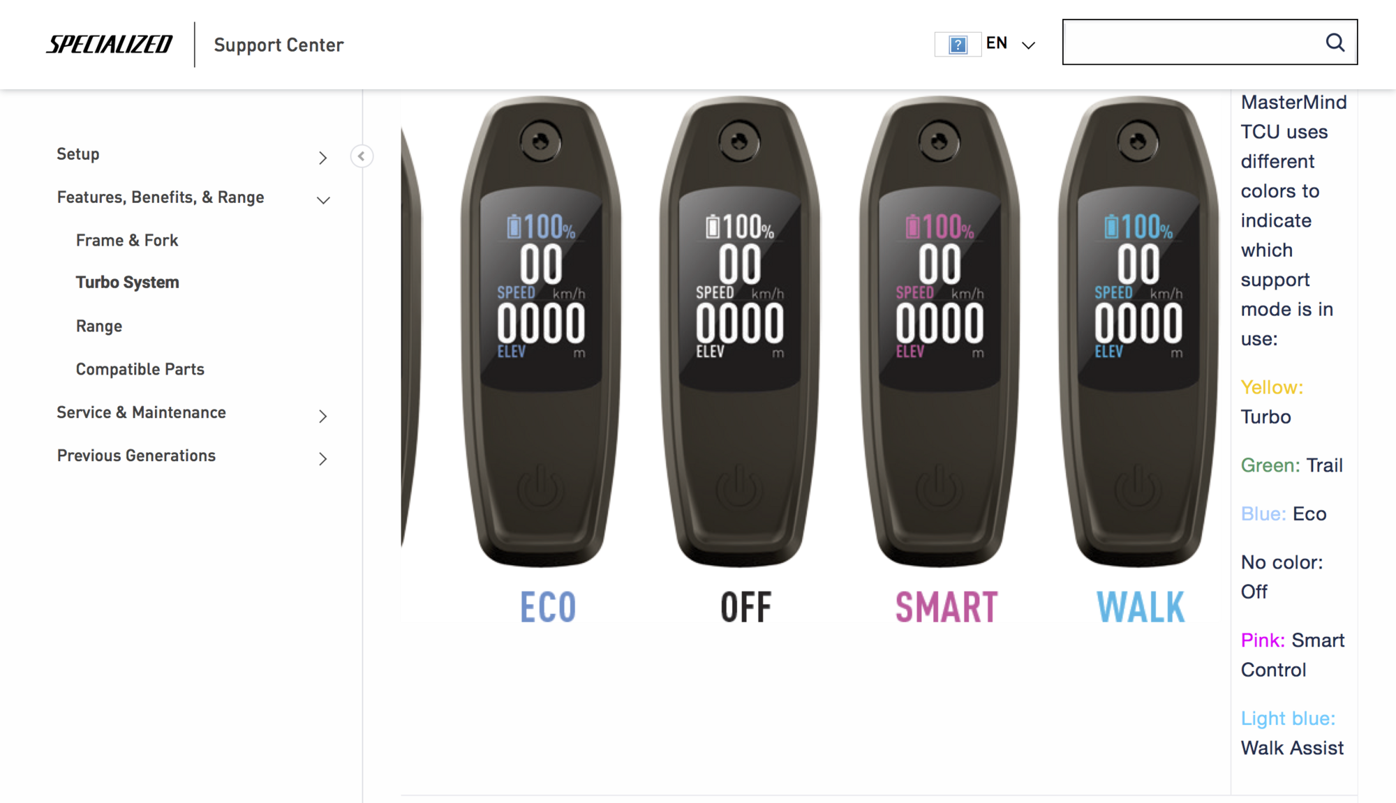

I don’t believe the original Creo, with the original TCU, has a walk mode (if it does, color me stupid, because I own one) However, I found this, indicating that the MasterMind units do. What isn’t clear to me is whether that includes Mastermind on the Creo 2.
I have a 2022 Creo 1 with mastermind. If it has walk mode, I have yet to discover it. I'm pretty sure Amoto is right: Walk mode is within the scope of mastermind but it is not implemented on the Creo.
Perhaps you need to depress the Mode button on the Mastermind TCU and hold it?

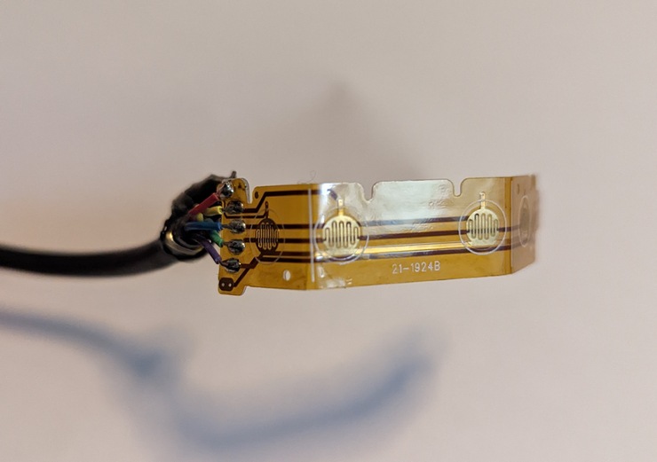

Creo has 31.8mm bars. I bought a switch intending to do the dI2 left shifter switch mod and when I plugged it in for a test it didn't work. I can't remember if the Creo SL 2021 connector was missing two of the control wires or if it was a program setting that needs to be change by the shop.
This is the inside of the switch.
You would need to have one of the accessory bar adapter attachments with a 22.2 bar section to fit the control to a Creo. There are pictures somewhere in the forum with a Levo control mounted from a couple of years ago.

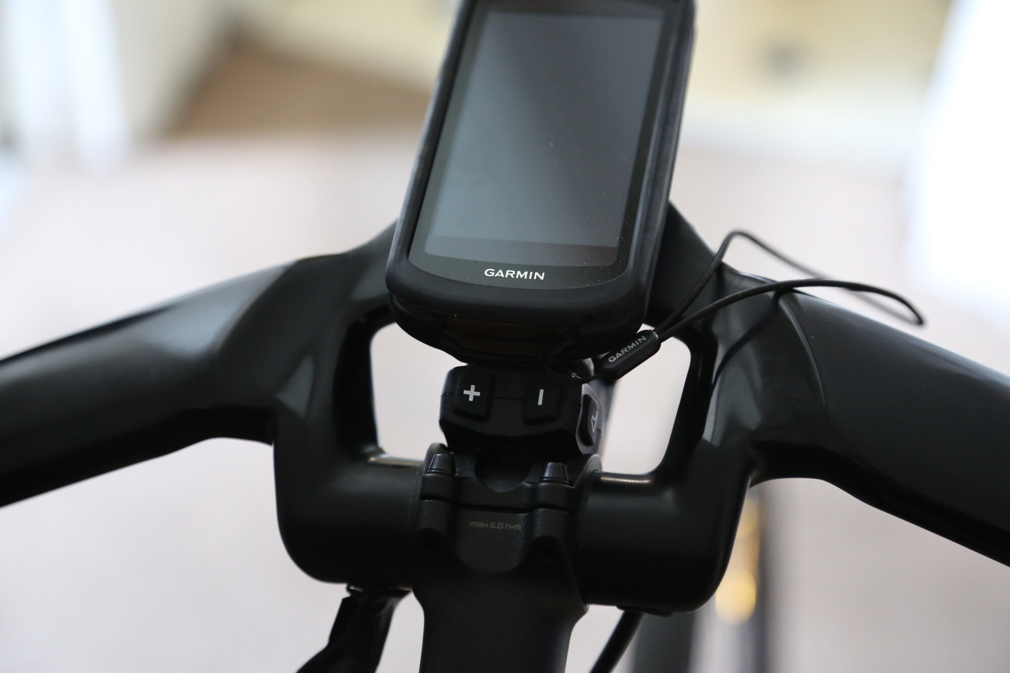

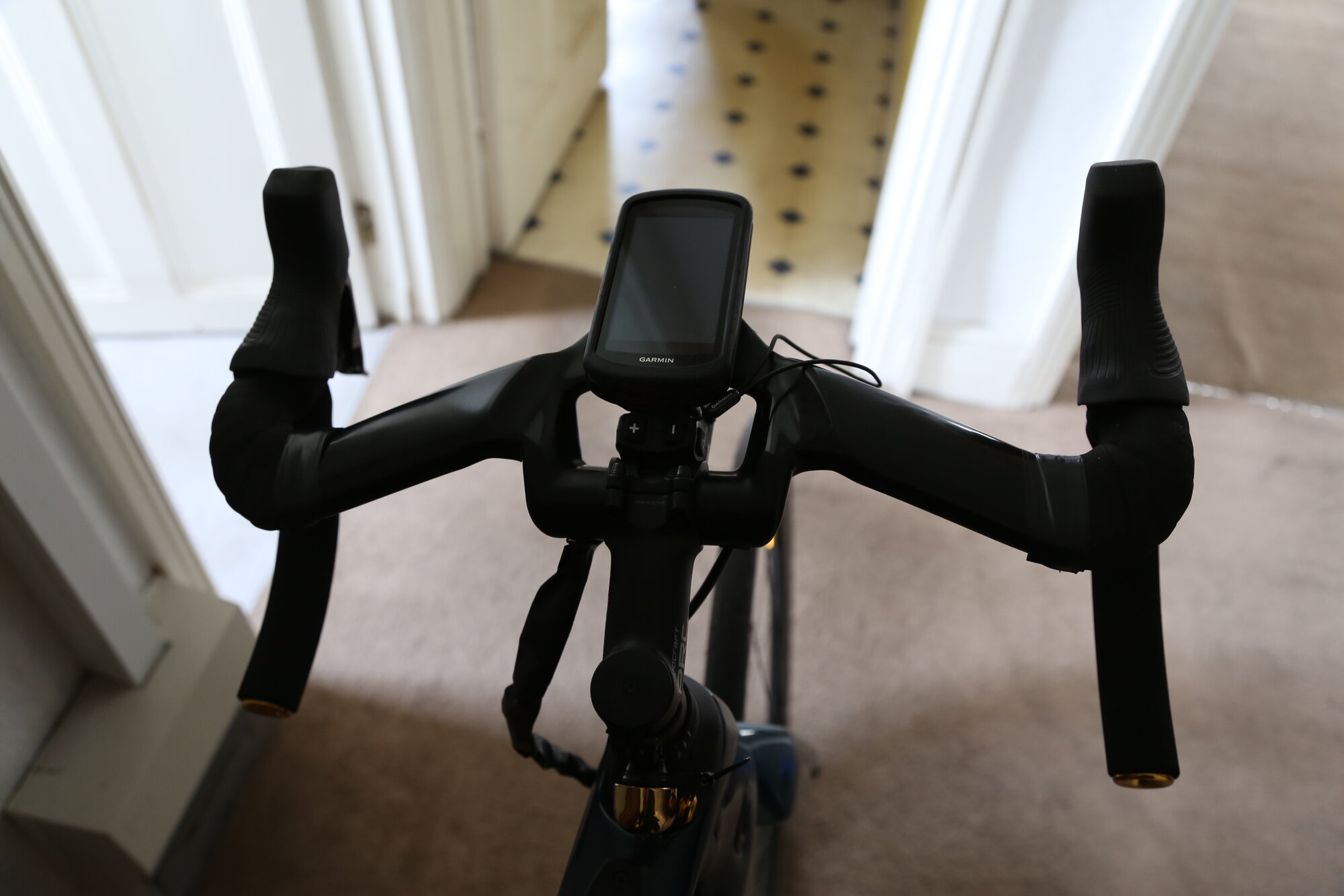

My Creo 2 has walk mode, but only because I use the Levo remote over the Creo version. Look under my Garmin and you can see the remote mounted under there. This remote is far easier to use the extra pages on the Mastermind TCU and I find it nice and easy to switch power modes. This remote also worked on the Creo 1 to get walk mode. Being an MTB remote, it does not fit as standard on a drop bar, but it does have enough material that you can bore it out and it will slide over the bars. However, the wire does get in the way, hence why I mounted mine where it is.
