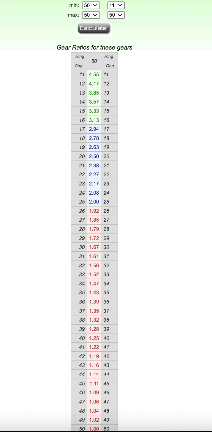

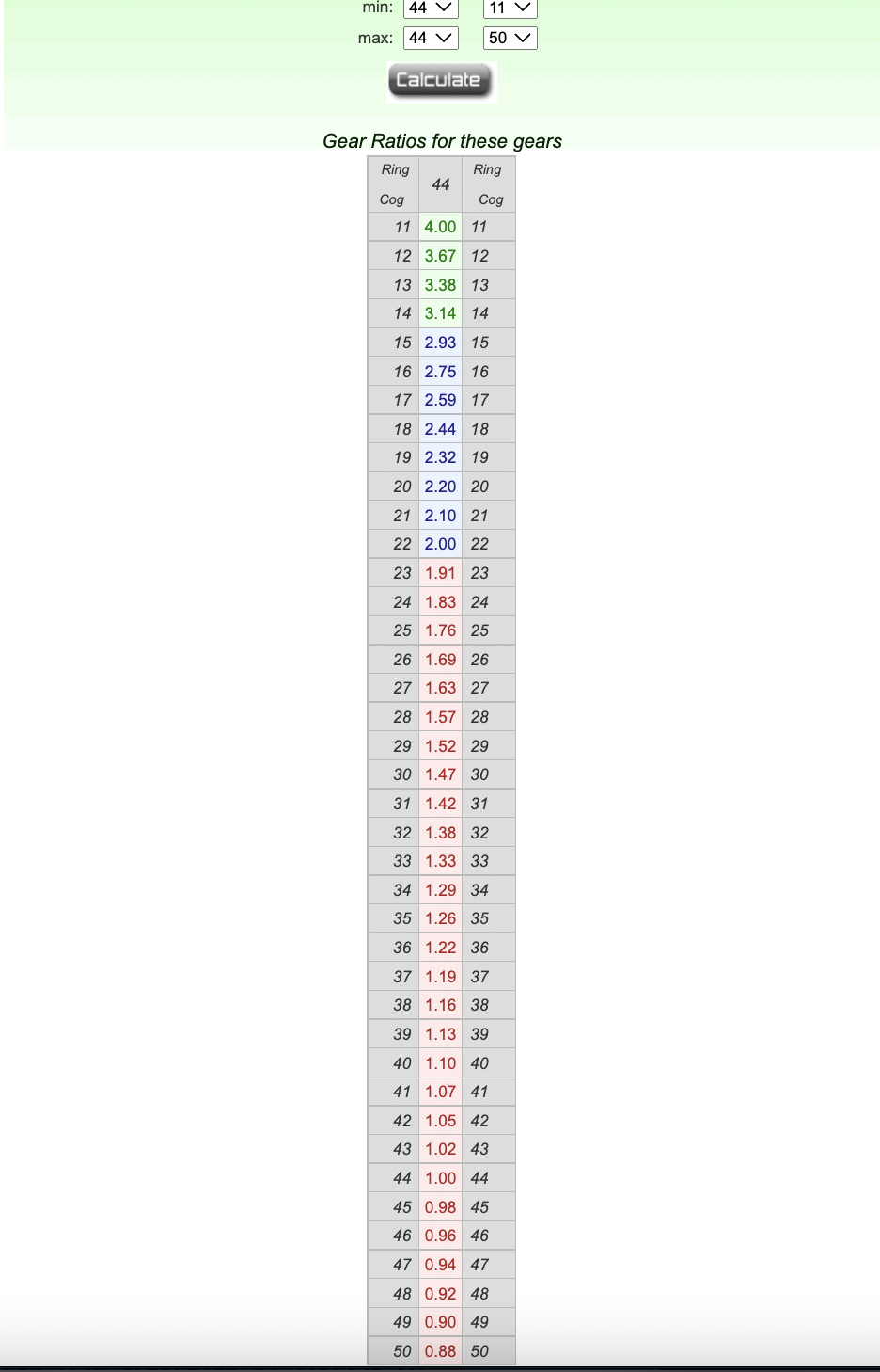

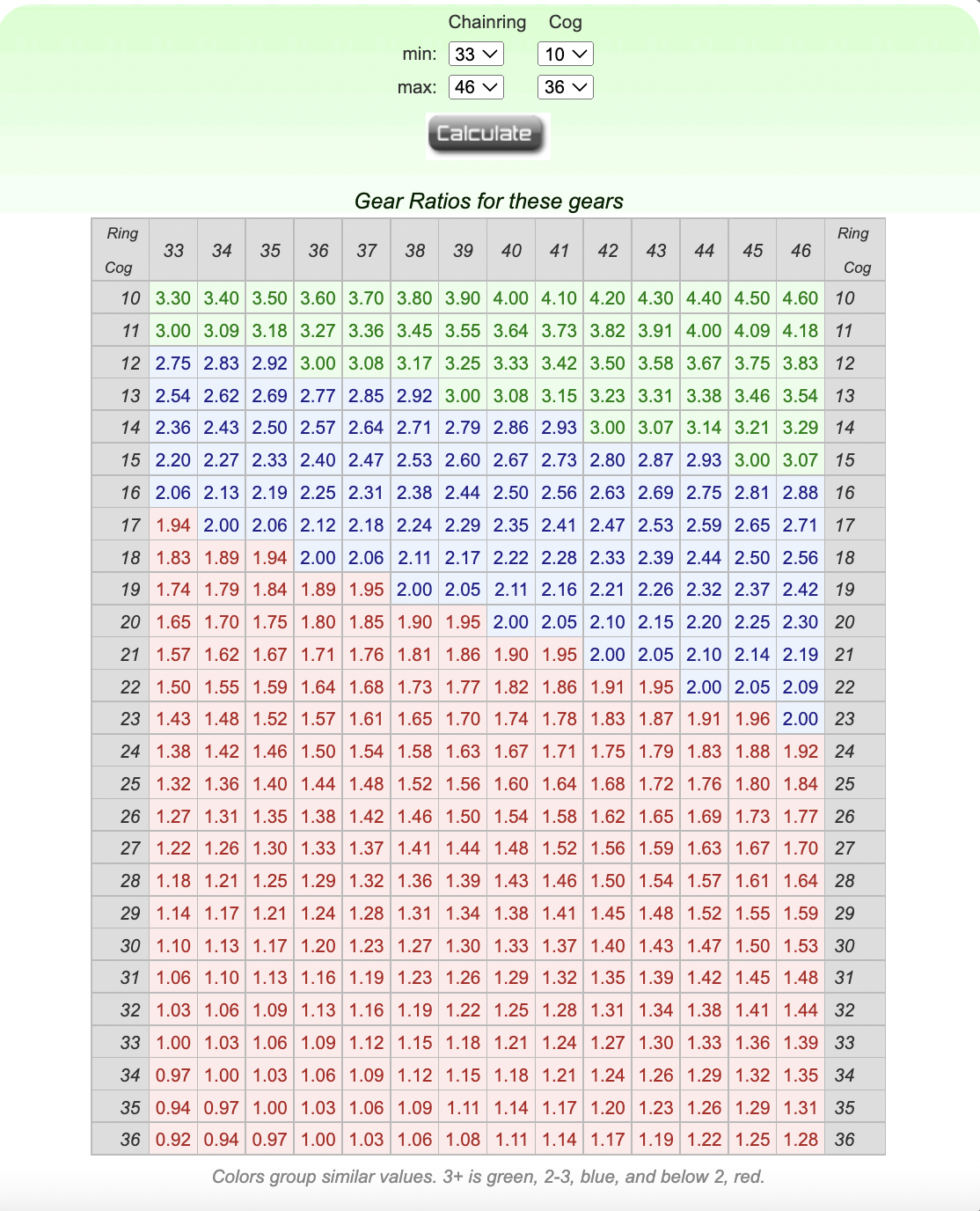

I guess the part I don't know is how far off 4.36 vs 4.55 is compared to 4.60 on the top end and how far vs 0.96 vs 1.00 compared to 1.28 on the low end. I think I'll mostly be okay on the low end since I usually only use the larger chainring on the Roubaix. There were only one or two times when I came across a hill where I actually needed the lowest gear (and motor).
I'm leaning towards the 48T because it's in the middle? But not sure if that's the right thing to do.
For reference here's the Roubaix config

Current Creo Config

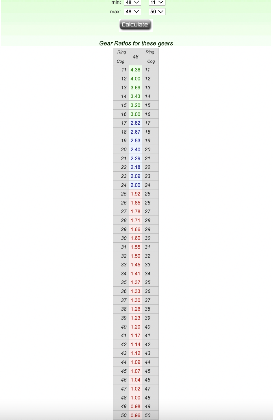

Creo Config w/ 48T

Creo Config w/ 50T

Thanks for that context, is 4.36 (48T) close enough to 4.4? I'm leaning towards that to keep the low gearing available for tough ascents. I don't mind spinning out on steep descents, I don't like spinning out on flat and flat-ish terrain.

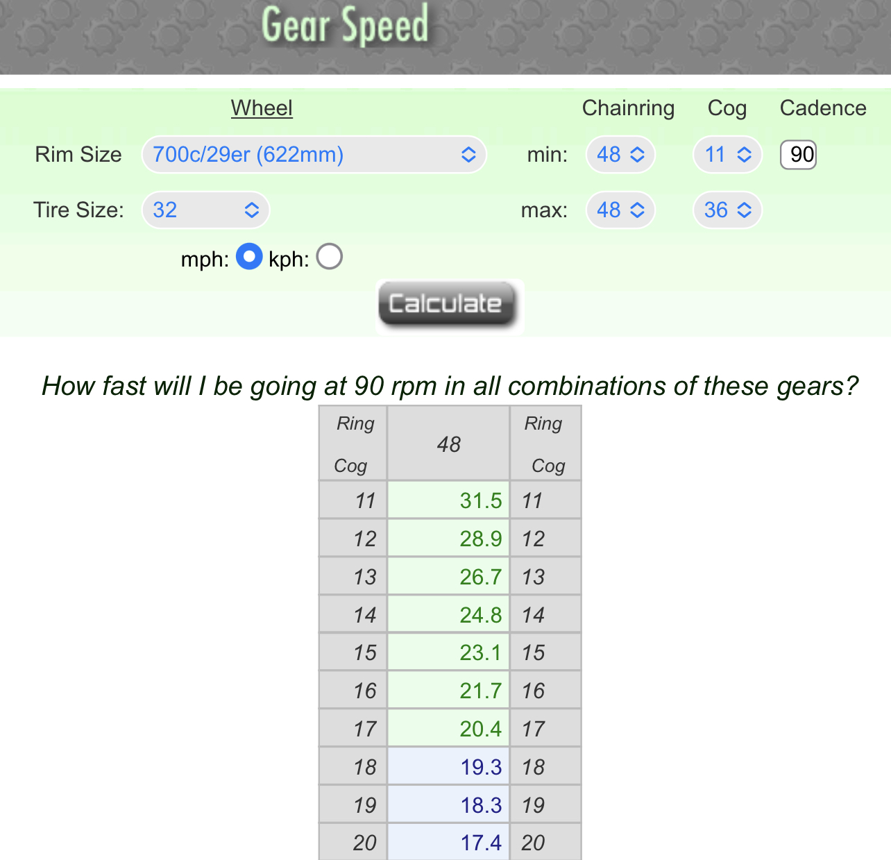

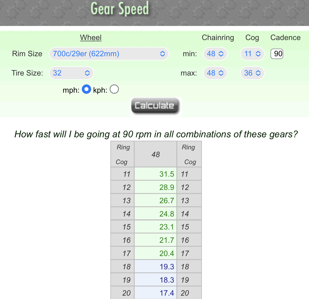

for me, 4.36 would be “close enough.” definitely on the low side by road bike standards, but you shouldn’t be spinning out on the flats with that. 31mph at 90RPM:
