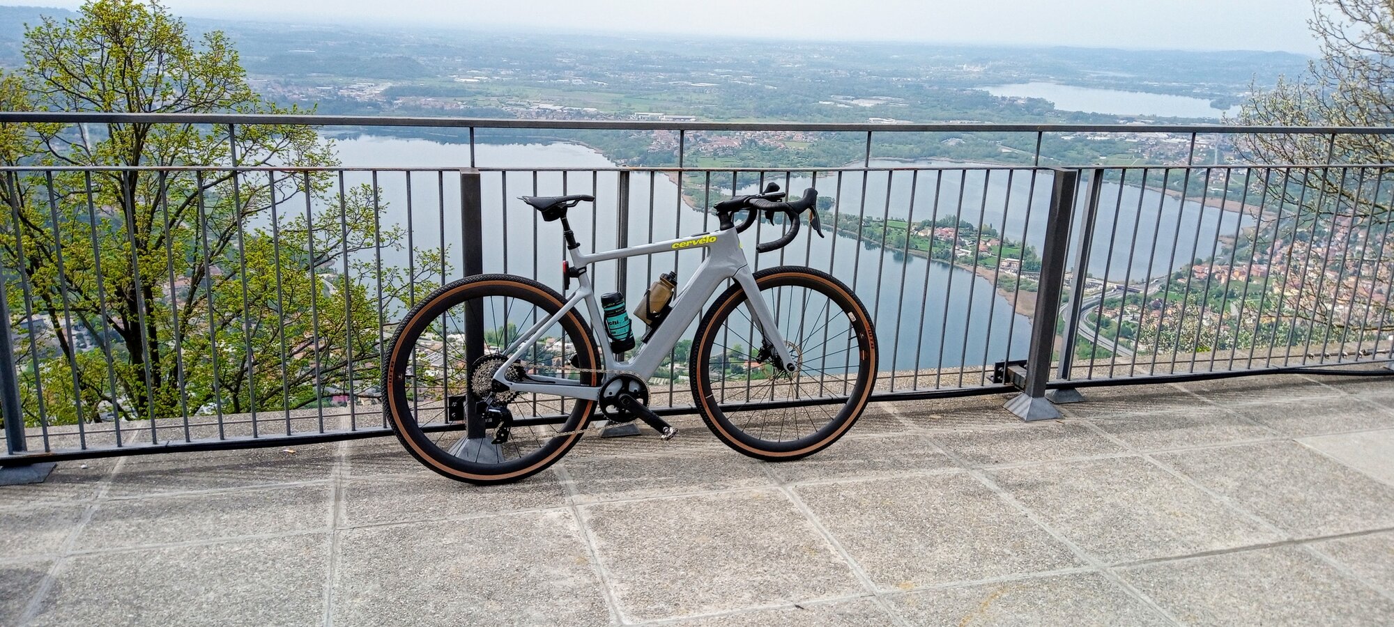

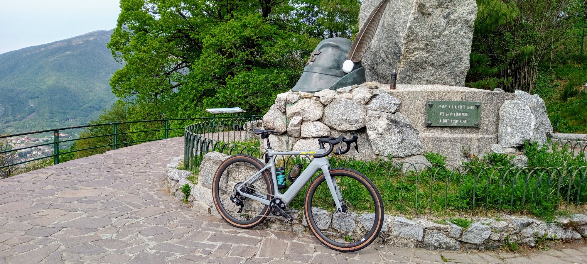

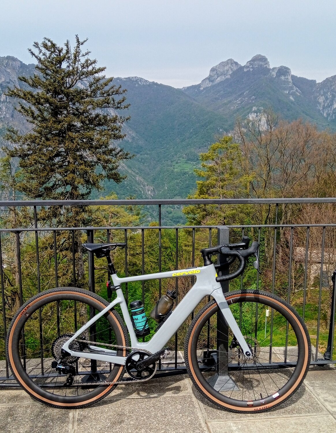

First of all congratulations for Your new Rouvida and I wish You to enjoy at best...
My Rouvida is equipped with Sram Force AXS 12v , 40 Carbon Wheel mounted with 35x700 Vittoria Terreno Zero & 36gr TPU tube,Carbon handlebar, Shimano 9100 XTR pedals for a yotal weight of 12.8kgs [28 lbs].
When riding without motor assistance [ white light] on flat or light gradient [ 2-3%] the bike it's very smooth without resistance and much much better than previous BMC Roadmachine Amp 01 with Mahle X20.....My rides are mainly in hilly &mountain area [ I leave in the Alps region] for distance in between 80-120 km and 1500-2000 mts elevation gain at 90% in Breeze mod [ till gradient 10-12%] and River [ for gradient above 12%]...Rocket never used.My personal setup are: Breeze 100w/120w rider- River 180w/180w rider- Rocket 300w/150w rider.
For the change from road to gravel setup it's necessary a part/ component to properly center the brake calipers being the length different.
