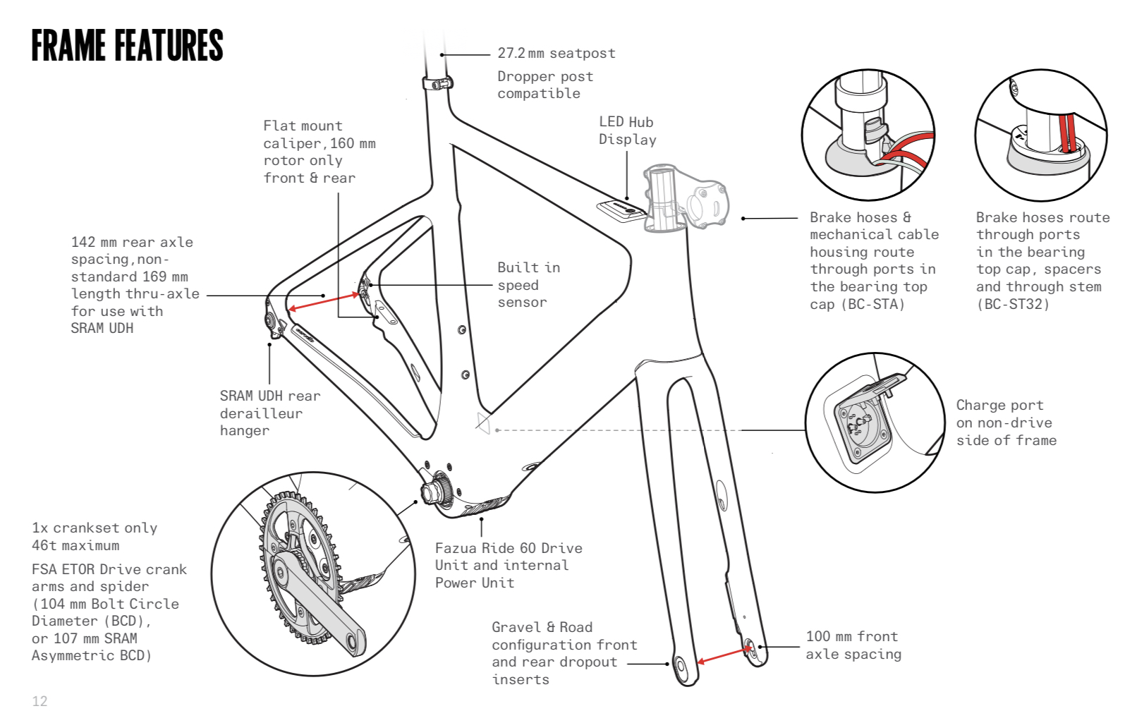

Can the Fuzua battery be charged while still in the frame and can the power be turned on/off without taking the battery out?
The fact you have to go to a dealer for a firmware update to take advantage of the flip chip is ridiculous - and it’s limited to a far smaller tire size. The Creo 2 takes up to a 2.2”.

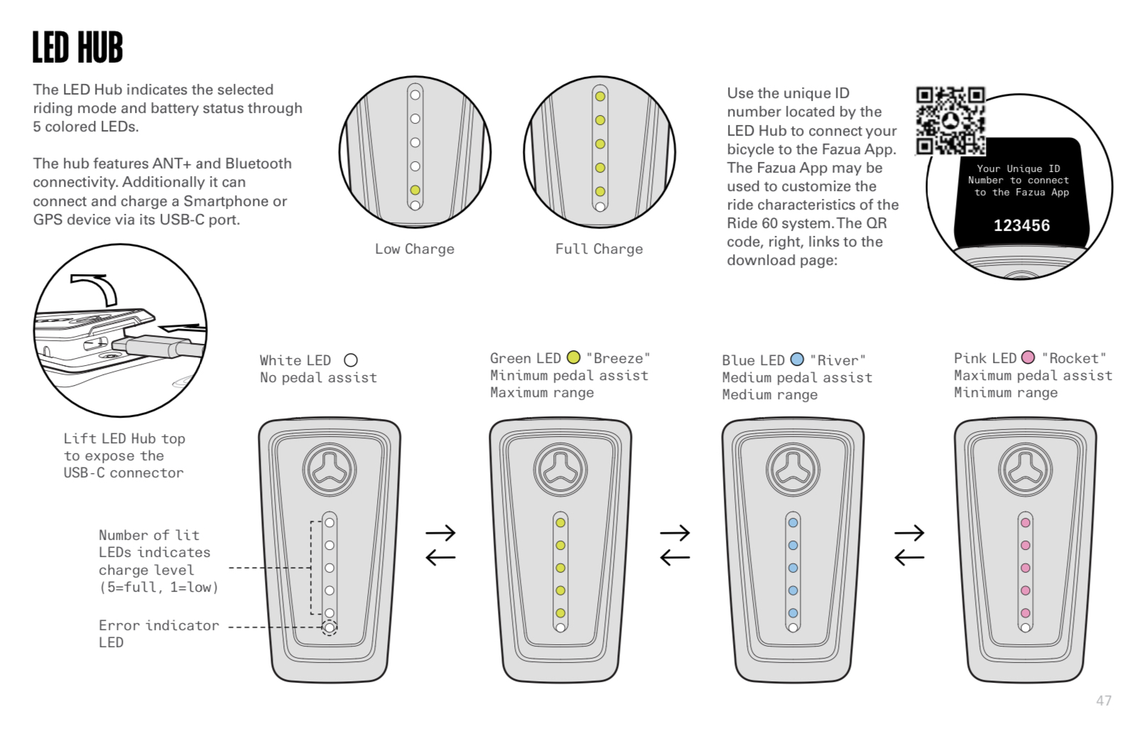

fazua makes versions with removable and permanently enclosed battery, the Rouvida version doesn’t have a removable battery, so it has a charge port like a specialized SL bike. obviously you can charge it and turn on/off :)

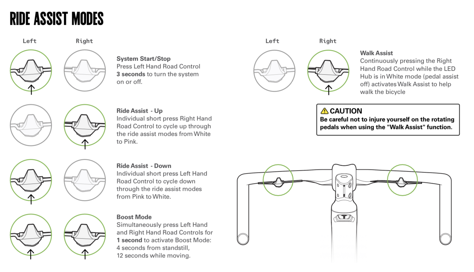

what strikes me about all these systems - specialized SL 1.1, 1.2, fazua, tq, mahle x20 is that they all operate in very, very similar ways. fazua appears to have a few more features, like the flip up USB C port on the top tube controller, and walk and boost modes, which most other lightweight systems don’t include.
the mastermind top tube controller/display of the 1.2 system is a plus for specialized, although one can debate the wisdom of important information being presented in that location.

you can choose what you see on the top tube - and that includes seeing almost nothing at all. The app lets you decide on which screens you can cycle through by clicking both blips at the same time, and you can use “stealth” mode which dims the display significantly. I barely look at it as I prefer my Garmin, but it can be interesting as a cross-check for speed, power etc.

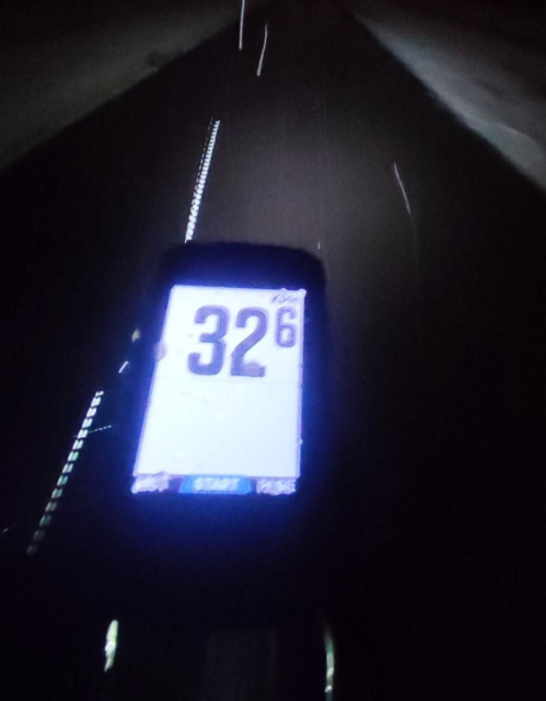

This is what a friend chose to see on his Wahoo, a gravel bike. As you say, he could absolutely do the same on the TCU 2 of the Creo 2.
And it absolutely doesn’t need one.

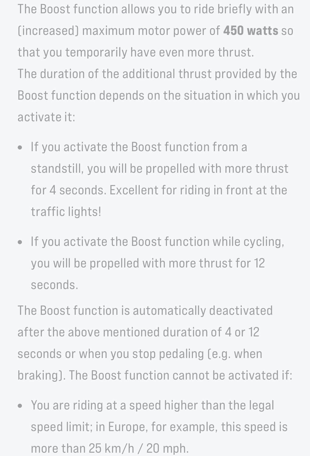

I’m guessing both boost and walk modes are standard on the Fazua system for the lightweight emtbs?
The SL 1.2 motor has the Walk mode capability (see the new Kenevo SL) but it is not implemented in the Creo 2 road remote.
