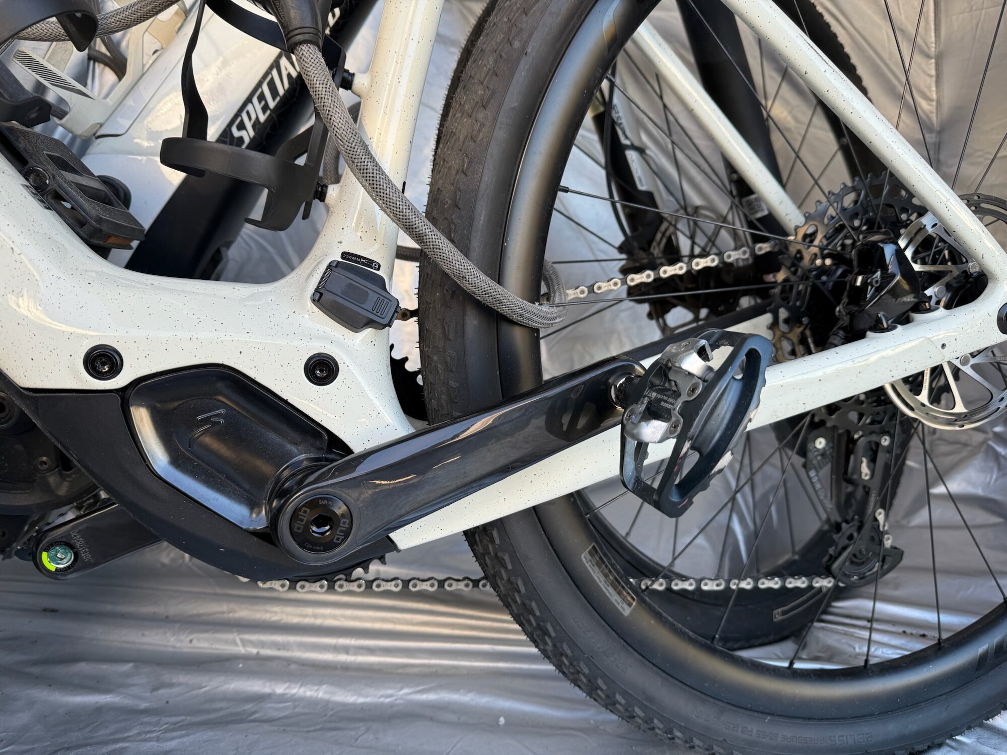

Had my LBS order a set from Specialized. They were $370 USD. Not sure how much of a difference they make but look great on my bike.

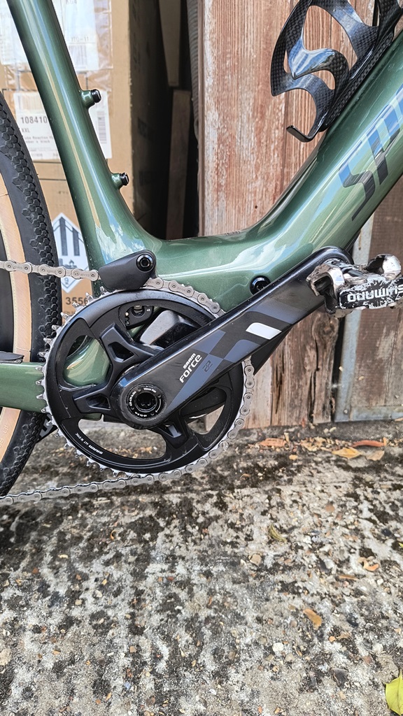

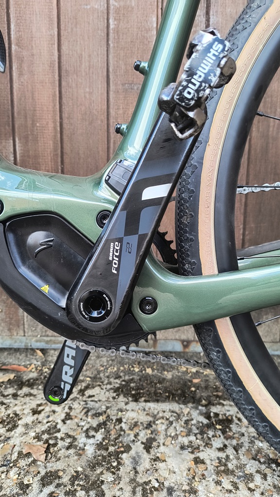

A bit late to the party, but just wanted to say a massive thank you to the OP as I followed their advice and did exactly this mod/hack/upgrade to my recently purchased Creo 2. See attached pics. I calculated the weight saving at 164g.
In reply to the previous poster, I worked with an engineer friend to do this modification and before committing, we checked that it should be possible to use his crank-puller to remove the non-drive side crank if needed.
