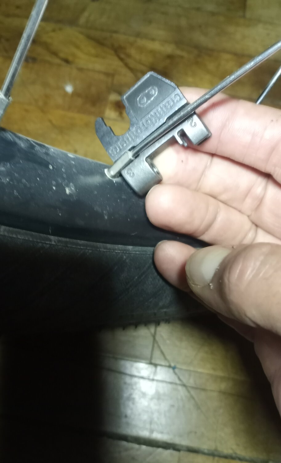

Anyone know what the tension should be? I have a Park Tool TM-1. Getting readings from 25-35. I believe these are 12 gauge/2.54mm aluminum spokes, correct?
I believe tension tools came along for very light road-bike spokes and rims, and even then, many mechanics go by feel.

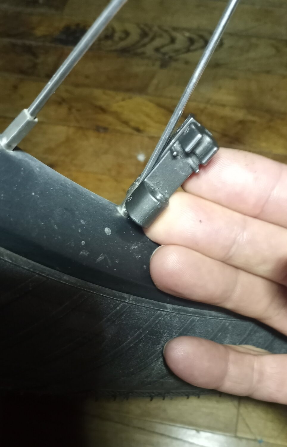

I had to replace maybe 4 spokes on the rear wheel of my Radrunner. In the photo, the heads had popped off where the holes are. I read that most breaks are near the threads or at the elbow. The broken heads were a mystery until I noted the sunken head between the holes. The head was too small, letting it sink too deep, giving the elbow leverage to stretch and put uneven pressure around the head. When that third spoke broke, the bike would have been unrideable. I walked a lot during the month it took spokes to arrive from China.

I just received a Spoke tension Tool. Unfortunately it wont work on my eBike because the Pins are to far apart (or the available space on the Spokes on my eBike) is to short.
Any suggestions by the Experts other then going by sound.

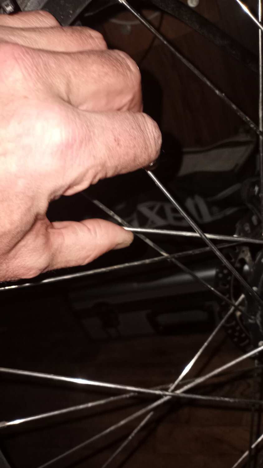

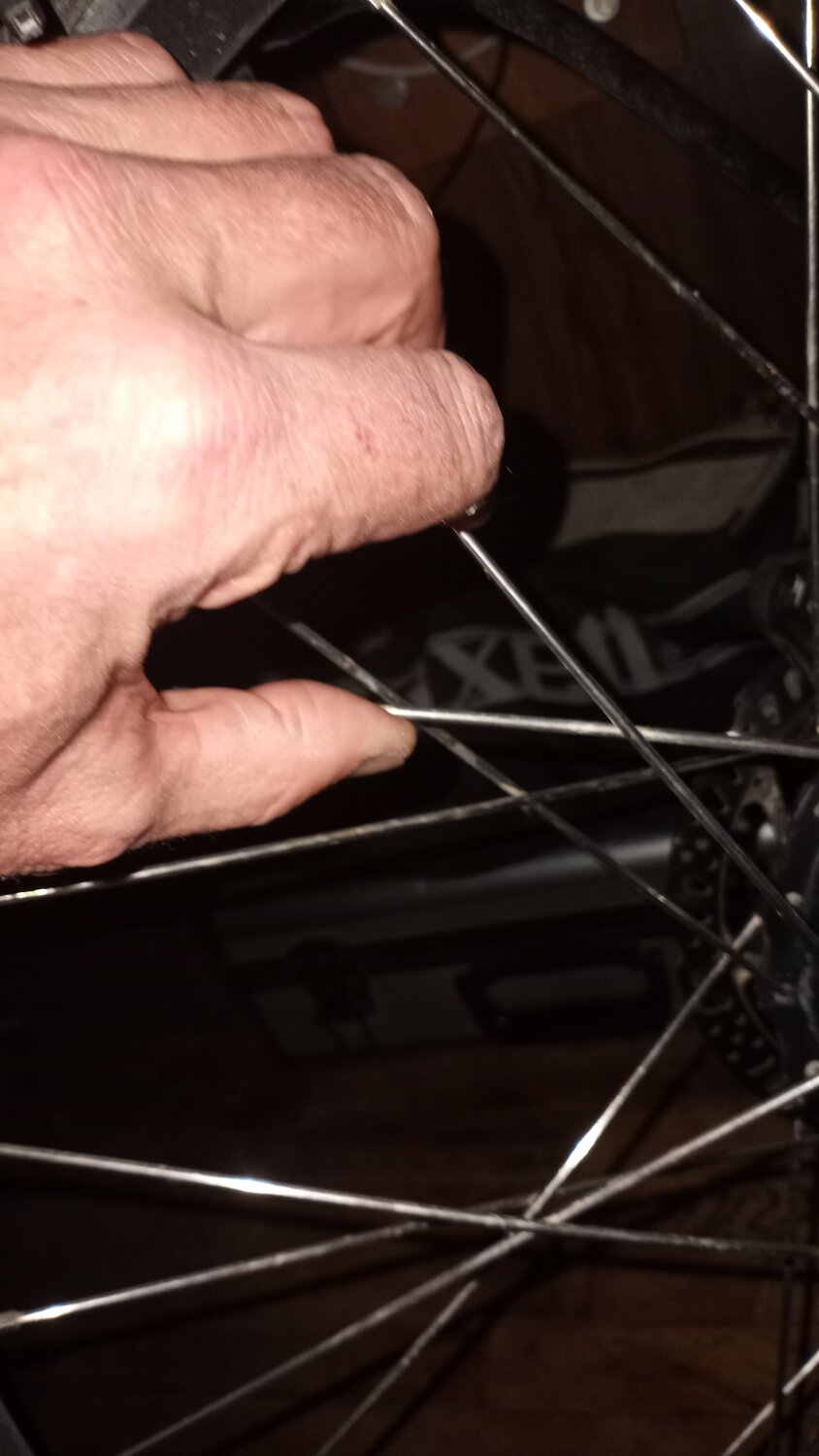

Grab the spokes where they cross, and squeeze,..
You'll feel it, see it, And hear it.
Don't go too crazy tightening anything, or you'll warp your wheel.
Mark the ones you mess with so you can undo what you did if you have to.
A loose spoke should be easy to identify.
Properly tensioned ones are difficult.
Don't try to make them all sound the same, just focus on the ones that rattle and snug them up till they stop rattling. (or you'll warp the wheel)
PS. I'm not an expert, but I've been warping and unwarping wheels since I was 12 years old. 😂

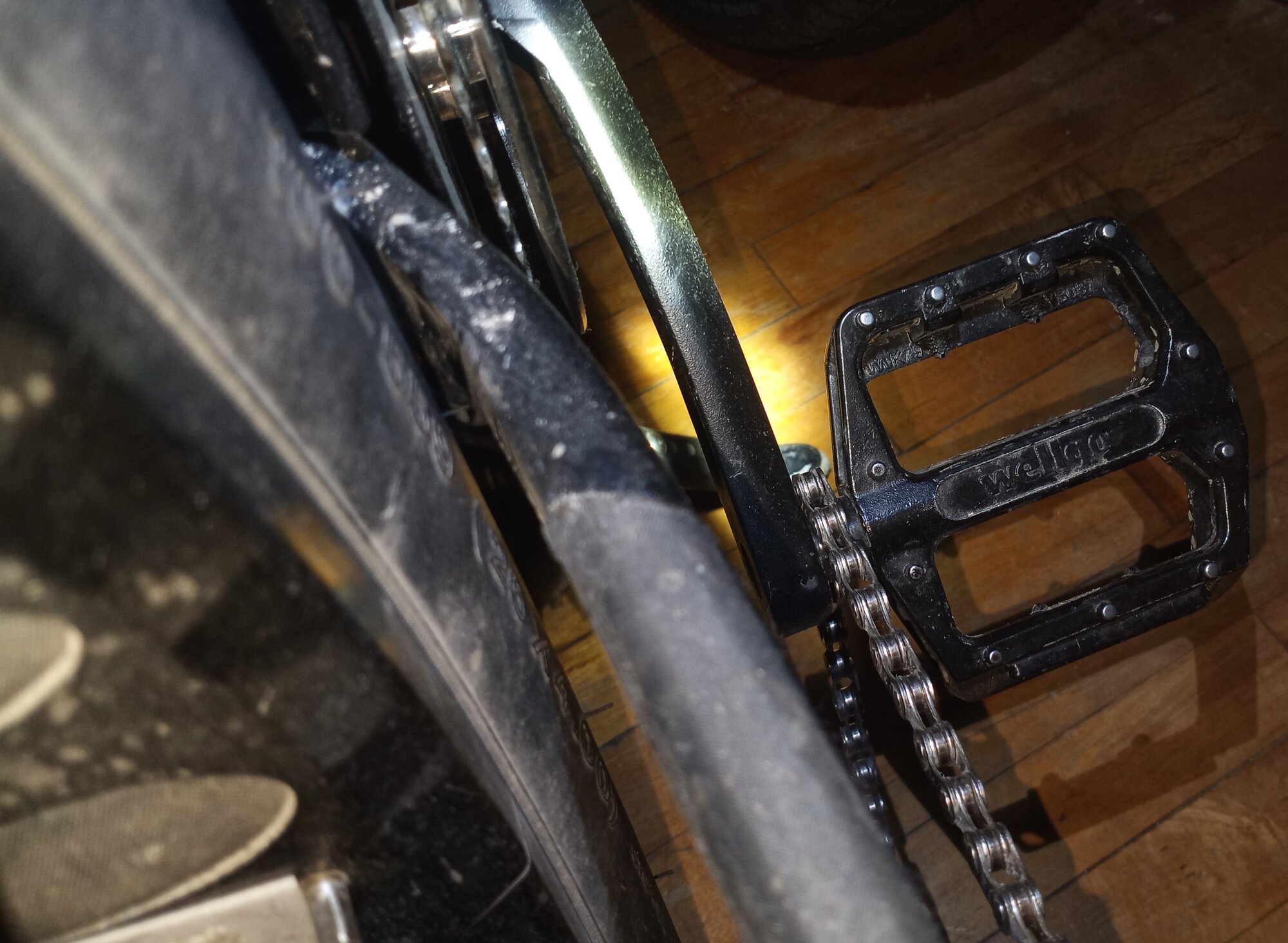

I actually bought a spoke tension gauge and used it to tension every spoke exactly to spec.
My wheel was so warped it hit the chain stay. 😂
I had to undo everything I did to straighten the wheel. Then bring the tightest spokes down into the upper tension range, and bring the loosest spokes up into lower tension range.
What a PITA. 😂
Turns out my 26" fat rim is a warped piece of crap and wasn't joined together squarely when it was made.

Self taught spoke guy. The sound that matters is when you hear the wheels tinkle when a loose spoke pops in and out as the wheels roll, Those are easy to find by squeezing the spokes, .and I'll just tighten the spoke til it feels like others,

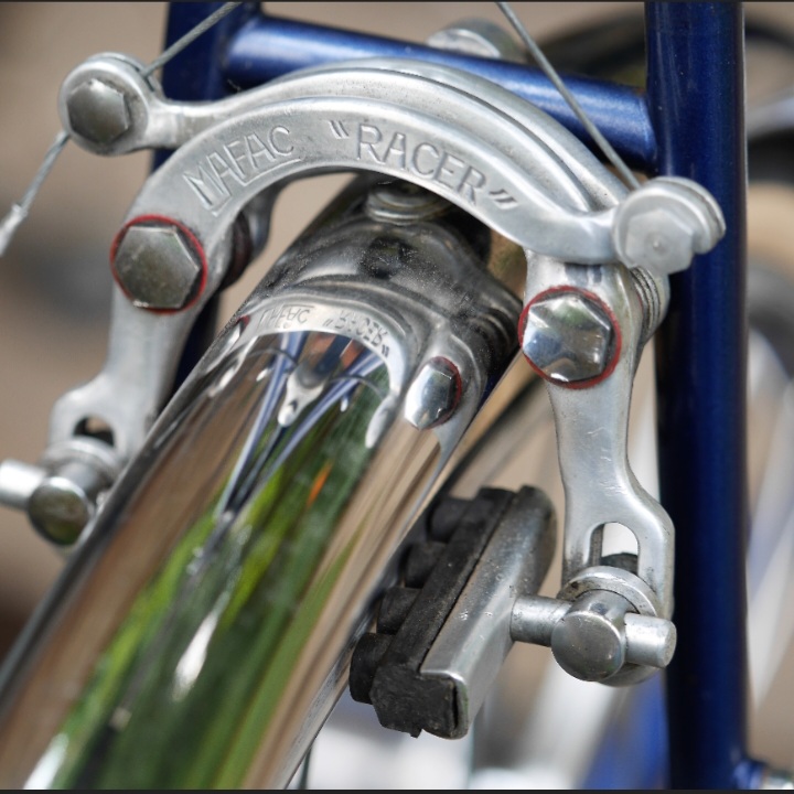

I remember a center pull brake I had like this, where the hole in the frame where you bolt on the caliper wasn't centered.
I figured they kinda dished the frame instead of wheel ?
I'm pretty sure that the dishing takes care of itself if you align wheel with the brakes ?
Though we have gone to disk brakes. But just the same, you center the wheel.

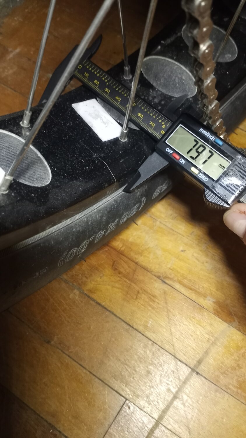

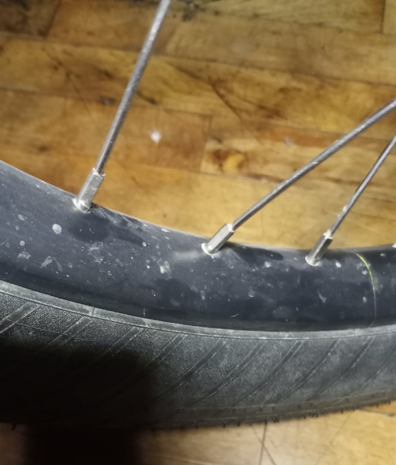

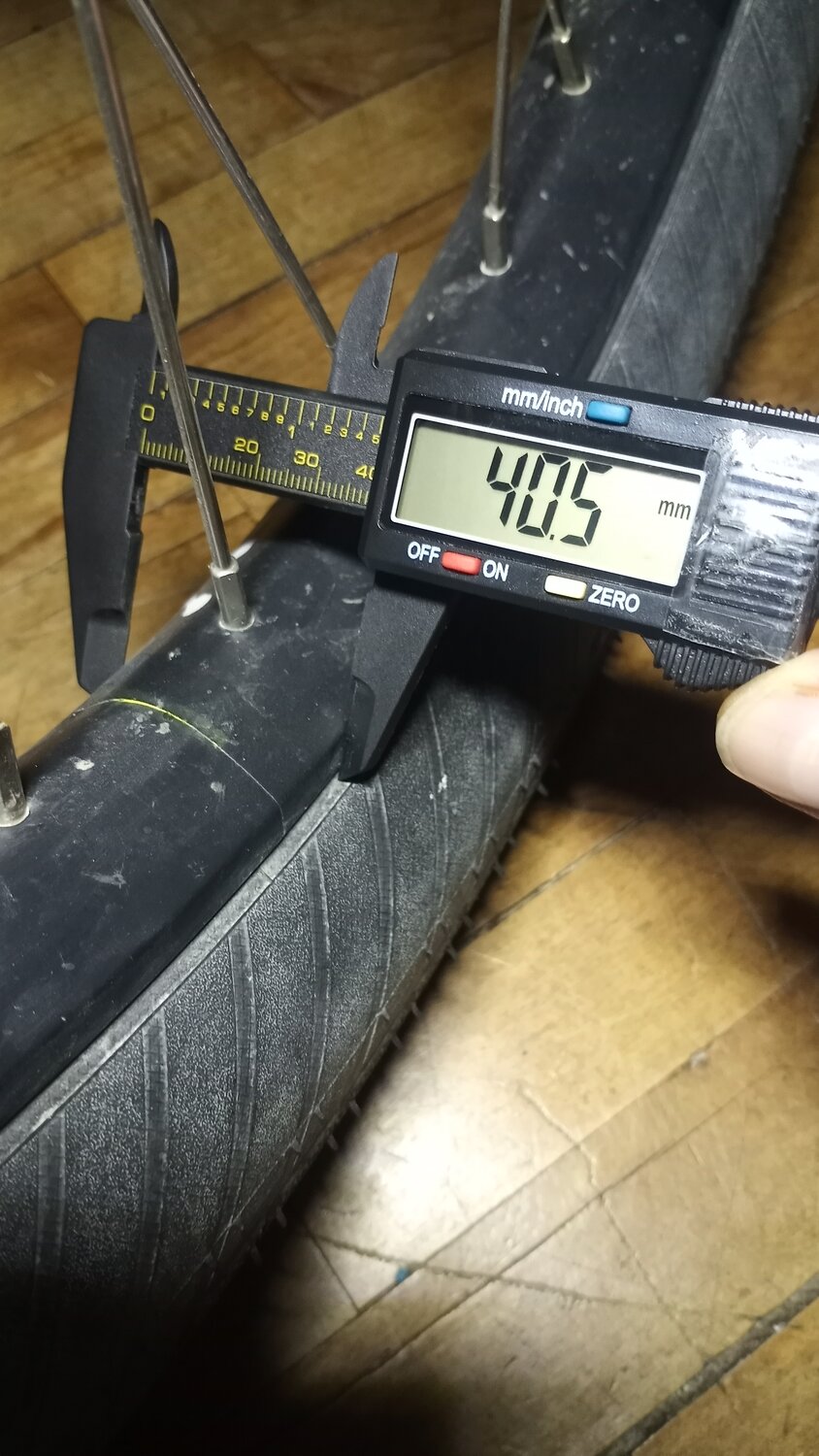

I've never laced a wheel but I'm thinking about lacing in a 27.5" rim to replace my 26" fat rim, then I can install my 27.5" X 2.8" Super Moto-X tires on that ebike.
My new ebike came with a 27.5" rim installed on a fat motor, but the spokes are pulling at a huge angle at the nipples, and it seems Really Wrong to me ??
They are heavy 12 gauge spokes, but still ??
My spoke wrench only fits the nipple for ¼ turn, then I have to reseat it.
Is there a 27.5" X 40 mm rim that is designed to fit a fat motor properly?
Maybe with offset spoke holes or angled spoke holes?
I don't want to build a crappy wheel. 😂
What a PITA. 😂

Currently I have a single speed e-bike and a derailleur e-bike. Of the 4 wheels, the only one that doesn’t offset the rim from the hub is the one with the cassette. The hub is centered on that one because the cassette on the right balances the brake disk on the left.

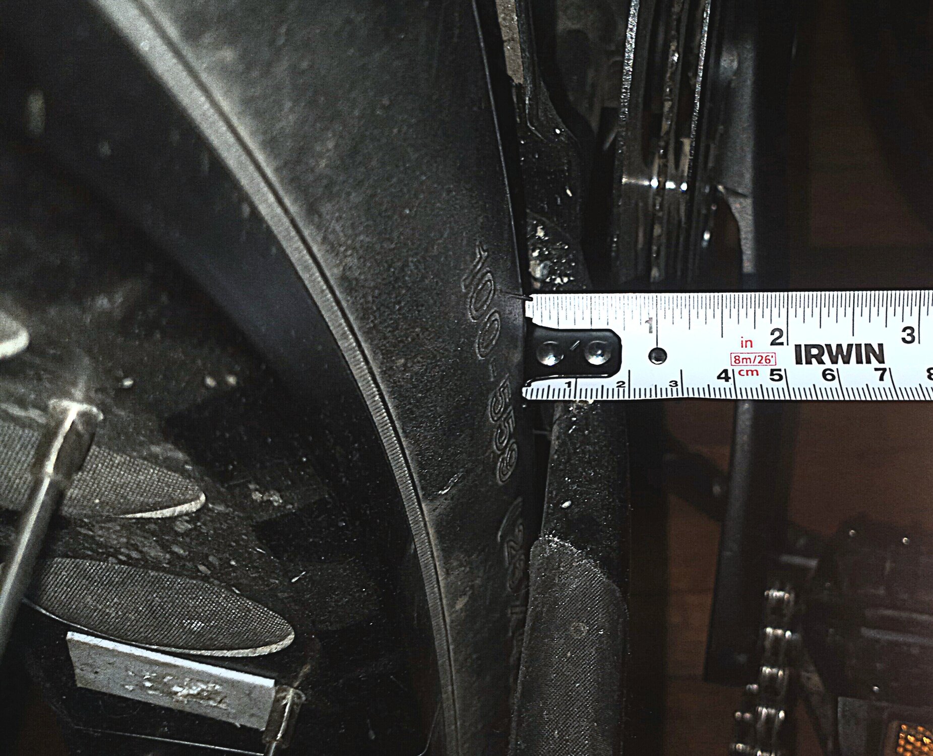

For safety and handling, the front contact patch should be centered on the steering axis with the bike straight and level. One bike came from the factory with the front tire offset 5mm. The rim was centered on the hub, but the hub was offset.
The spokes were 250mm, going to nipples 25mm from each hub flange. Pythagoras said that meant the radial distance was 248.7mm.
Pythagoras also said that to change the axial spacing to 20 and 30mm, I needed to extend the spokes on one side 500 microns to 250.5mm and shorten the opposing spokes 500 microns to 249.5mm. One turn on a bicycle nipple is 454 microns. What a coincidence!
My spoke wrench is a 4” spanner that will catch a nipple on 3 corners. The length made it easy to loosen each spoke on one side exactly 1 turn, then tighten exacty 1 turn on the other side. When I finished, I didn’t need further adjustment. The rim had moved 5mm, it ran true, and the spokes sounded good.
For the lateral tensions to balance, spokes on one side would have needed 50% more tension than those on the other. The would be about 4 notes on a music scale, but they rang the same, as do the spokes on 3 other wheels with offset rims.
I grabbed the rim and tried to force it laterally toward the sides of the fork. It wouldn’t budge. If the tire was centered and true and had no lateral play, I considered the task complete.
I think that balancing lateral tension doesn’t matter with 13 and 12 gauge spokes because as long as they aren’t loose, they don’t have enough elastic stretch to let the rim move. An 18-gauge road bike spoke has about 25% of the cross section of a 12-gauge spoke. With greater elastic movement, they may require preloading (tensioning).
Sound tells me no spoke is loose, which could allow lateral rim movement, and none is much tighter than the others, which on a bump could lead to permanent deformation, I suppose.
