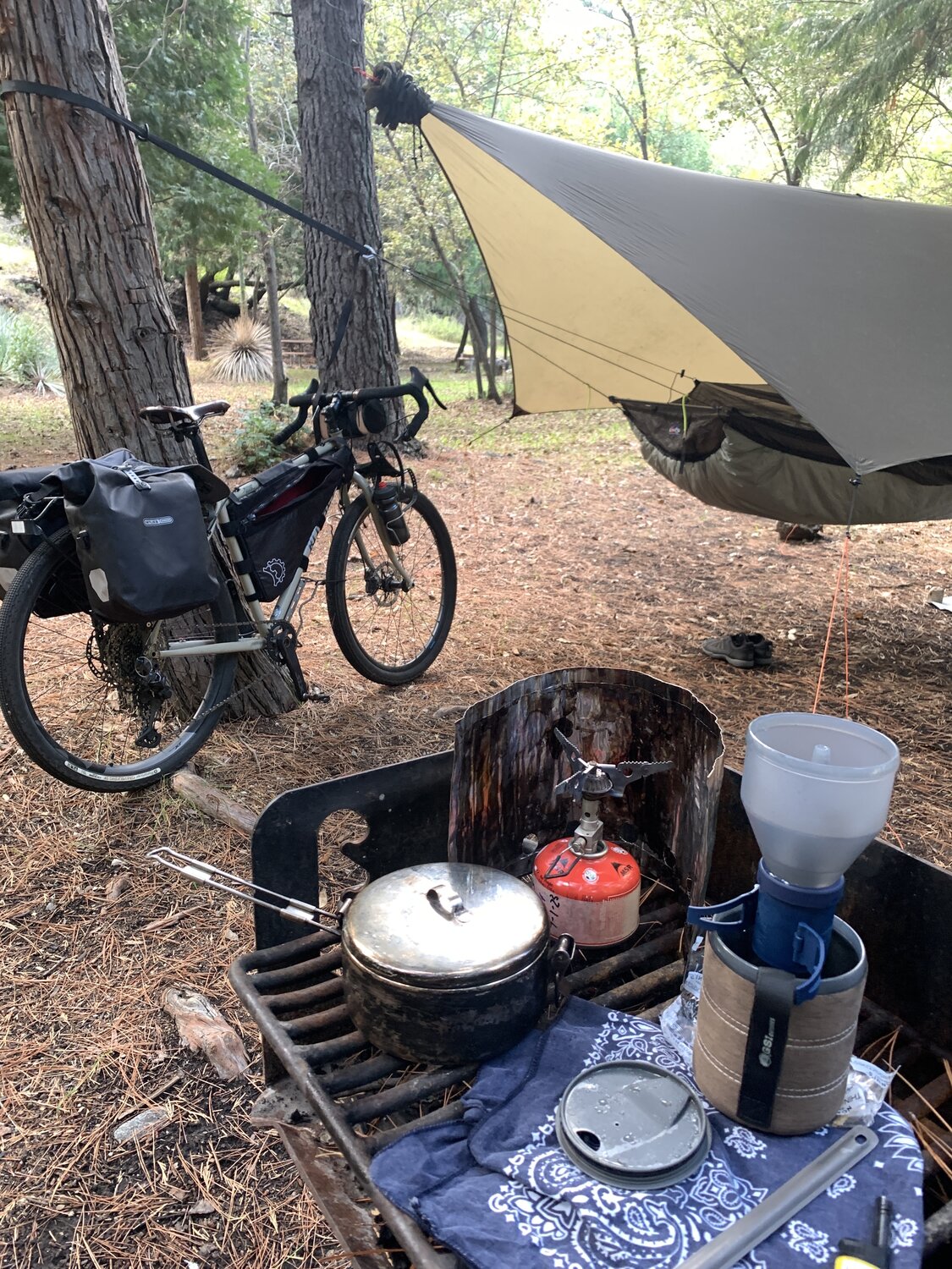

2023 Camp Kitchen:

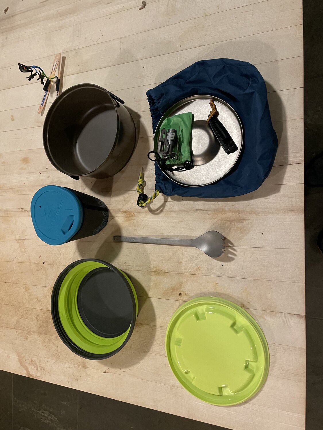

Clockwise from the skier dude: Evernew Ti Nonstick cookpot, 500ml. BRS3000T stove, Columbia River Knife Technology locking blade knife, Sea to Summit Deltalight insulated mug, Snow Peak long-handled Ti spork, Sea to Summit X-Seal and Go Container, Large. Not shown: lighter.
My personal feeling is that this kit is kind of overkill, and while I like a few things I will likely change it up a bit.
The Ti Nonstick cookpot is justified because on tour I tend to reheat a lot of stuff out of cans or retort pouches rather than rehydrate meals. I like the stove but also have a Snow Peak stove that is still going strong after 25 years (but the igniter isn't). The mug is cute but kind of a single-use item. I like the spork but it doesn't play well with the nonstick coating on the cookpot. I like the bowl ("container") because (1) it folds flat when empty, and (2) has a tight-fitting screw-on lid for when it isn't. So I can plausibly make tabouli and carry it to camp in my handlebar bag.

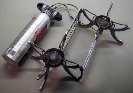

I used a folding Coleman Xpedition Powermax stove for several years on paddling trips for its ease of setup and quick boiling times. The dual burner was especially convenient. But as you mentioned, its performance does tend to lag in colder temps. The cannisters are no longer produced but I hear that you can purchase an adapter to use with the Coleman one pound propane cylinders.
That is a very heavy stove. At least by my standards, a BSR-3000T weighs 24 grams.
The standard screw-on propane/butane canisters are widely available (often even at Wal-Mart) and can in any event can be surface shipped so you can order them online and have them held at a post office or motel for you. The 220g canisters easily last three nights for one person, and the 445g canisters should cover a 1-week trip for one person. Depending on conditions and what you're cooking those numbers might be low or high.
True, it’s a relic and compared to modern lightweight stoves it wouldn’t be a considered good choice for bike packing trips. Its proprietary valve fitting was the stove’s downfall but boy, was it ever handy being able to utilize two burners on multi-day group kayaking trips.

Well, I'm starting to evaluate the 2023 camp kitchen and figure out what will be new for 2024.
The sea to summit bowl and sippy cup worked fine. In particular the bowl with a tight-fitting screw-on lid is a Big Deal. I got one of the new Pocket Rocket Deluxe pressure regulating stoves and won't be going back. The pressure regulator is a game changer as it lets you get more boils (and in less time) out of one canister. And those last boils take far less time than before. Right now only MSR and Fire Maple sell such stoves, but I suspect that will be the thing going forward.
Speaking of canisters, I'll probably pick up one of these gadgets from Flipfuel so I don't have a pile of nearly empty canisters in my garage:
Now for the thing that didn't work so well. The Evernew Nonstick Ti pot didn't cut it. I'm looking for a nonstick cookpot that I can use to reheat a can of refried beans or chili on that little canister stove burner without it burning very much on the bottom. That didn't happen and the burning also destroyed the nonstick coating, making the whole problem worse. At the moment it is challenging to find an appropriately small nonstick cookpot, and with the pannier rethink I don't have as much volume to play with so a bigger pot is kind of a problem...
