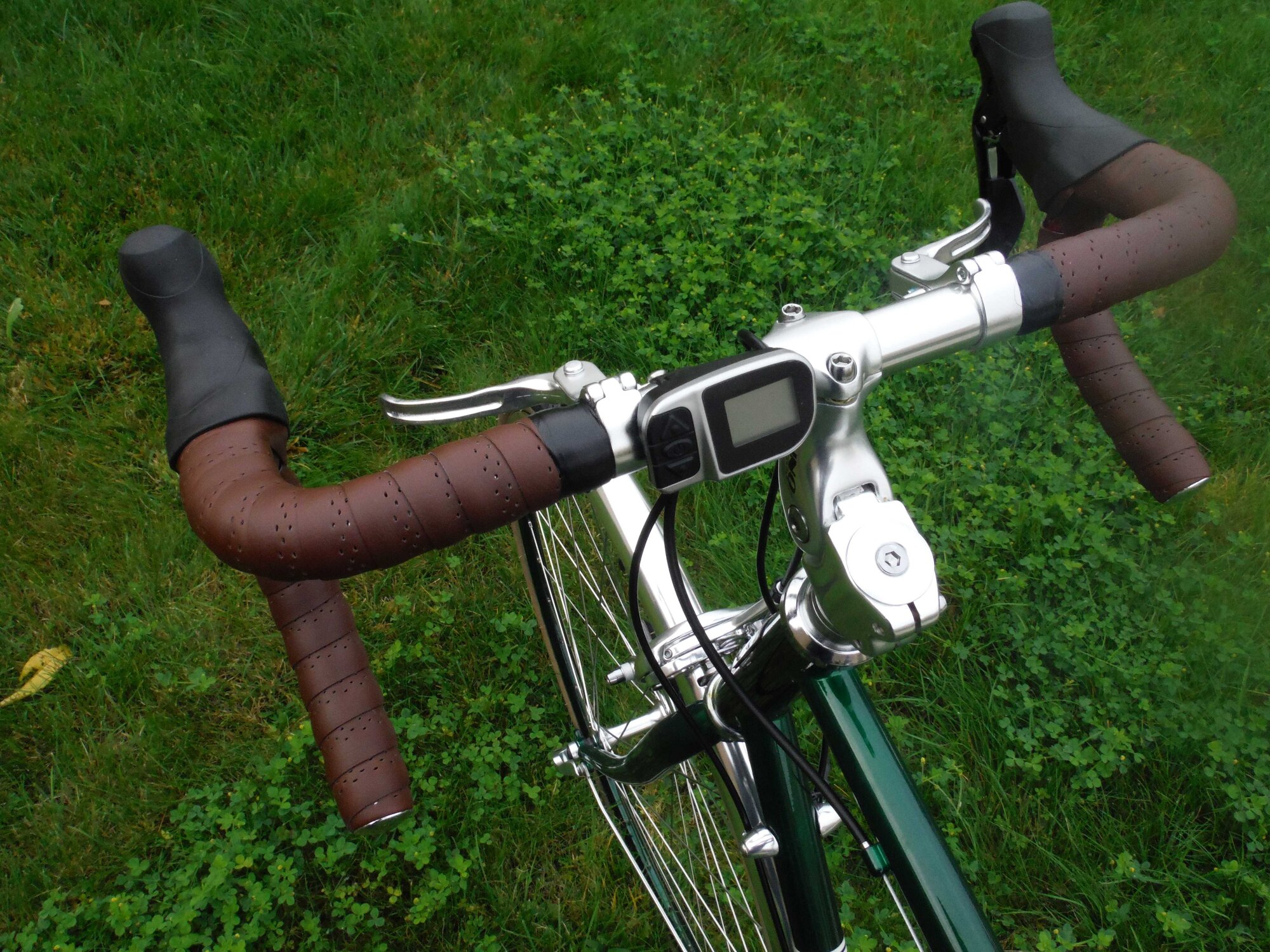

This one checks all the boxes. It has British racing green rims, a curvy 25Kg rack, and polished fenders. This is a preview because it is in the process. By the end of today it will be ready. 350W, torque sensor, 80Nm, 41 pounds with the fenders and rack. And it will not look electric.
That's lovely, and I'm looking forward to seeing the final "after" pics.
Too bad about the caliper brakes, but at least they're dual caliper.
I never got those secondary brake levers. Yes maybe if you have smaller hands or compromised hand strength that makes braking from the hoods a bit iffy, but I always felt that if you spent an inordinate amount of time with your hands in the center of the bars and weren't comfortable just reaching for the levers from the hoods that you might as well just go with a flat bar setup.

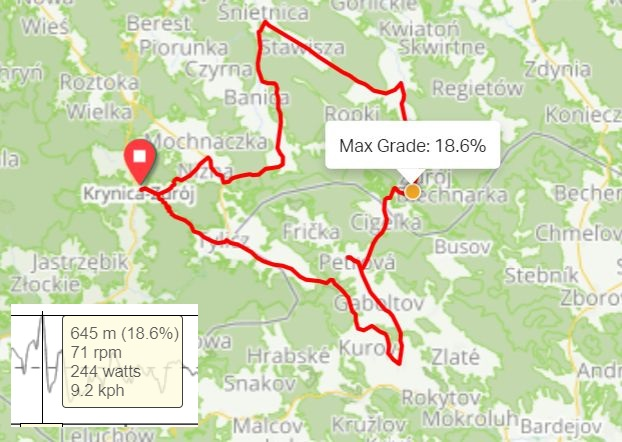

To complete the story, I'm sixty with multiple ailments including leg arteriosclerisis and inadequate blood supply. Yet the full power Vado with mountain gearing made such adventures doable for me. And you know what? Vado SL wouldn't make it, lightweight or not 🙂
At the hiking trail with my full-power Vado.
Actually, two heavy panniers. See the 38T chainring (the stock one was 48T).
The hardest climb. The trip was 43.5 mi with 4100 ft elevation climb. I was on far longer rides with more elevation gain on last vacation but that day was the hardest.

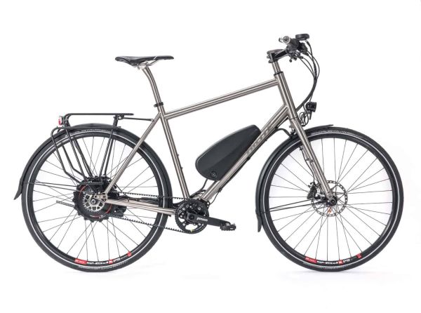

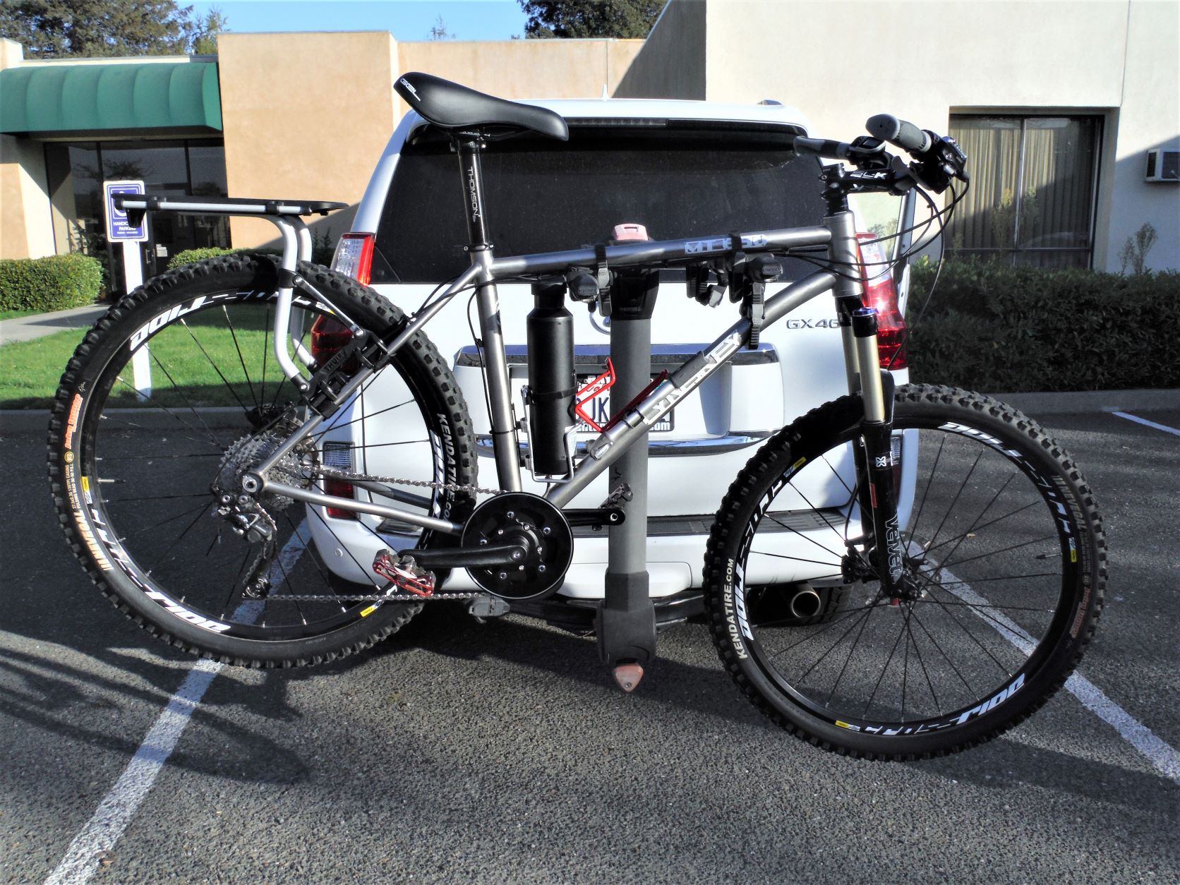

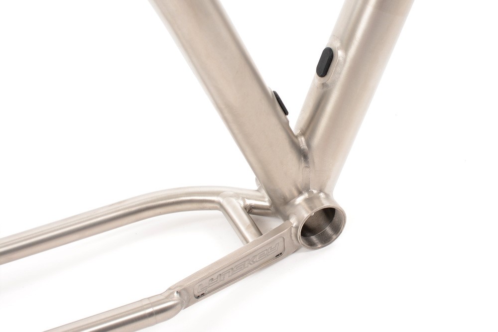

I like titanium bikes a lot. Here is one I did with a small mid-drive last month. The owner wanted large battery. I like the smaller ones. This rack is not for a child but what is nice is that it can go on a bike without frame bosses for a rack. He is not going to break this Ti bike.
