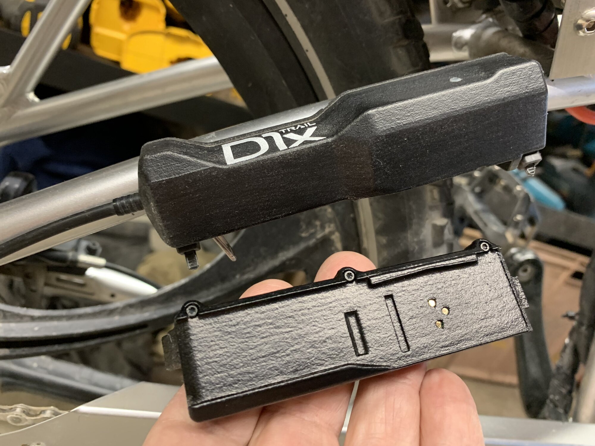

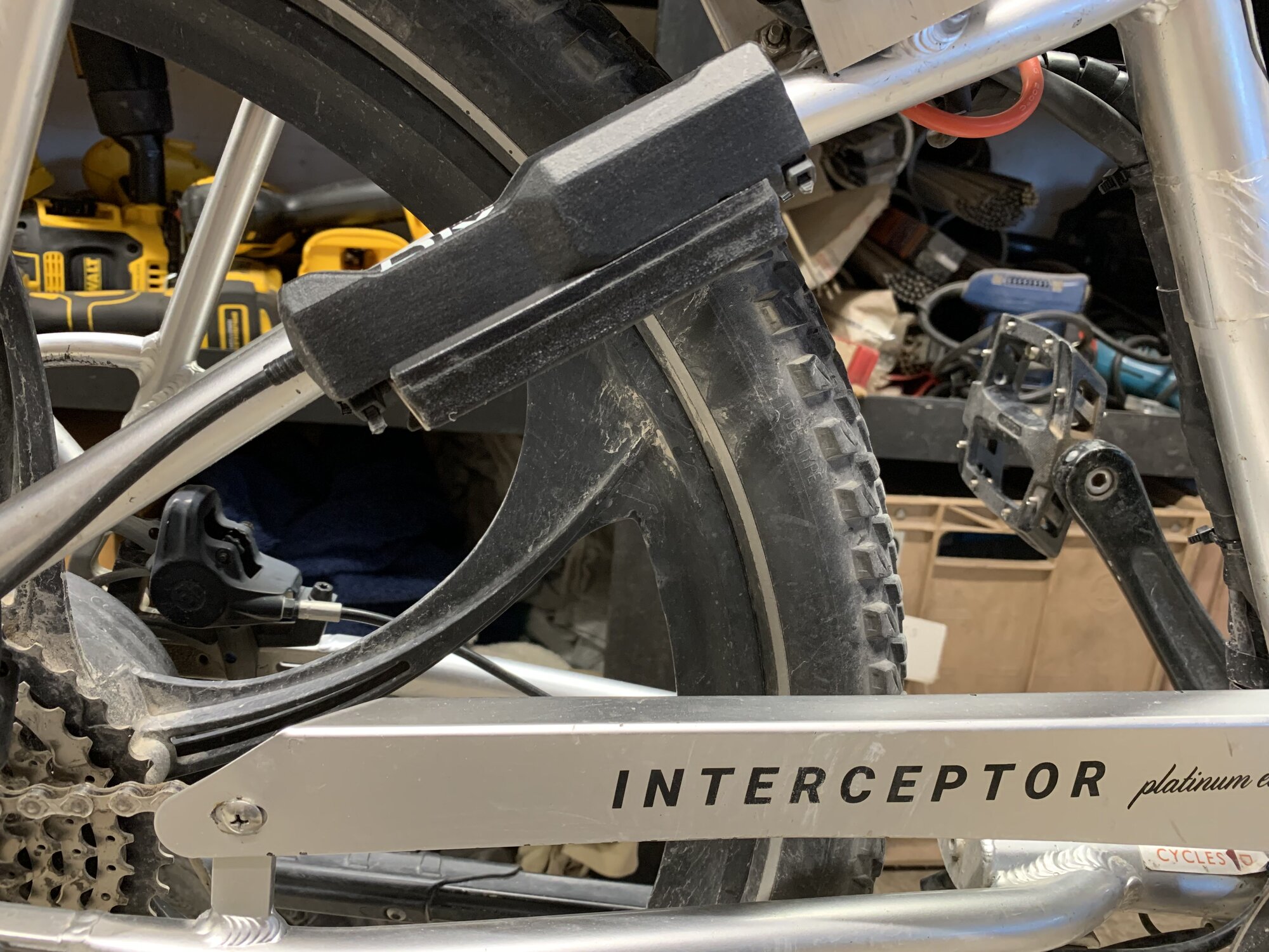

I was going to add electronic shifting to one of my other bikes and discovered Archer has a new model, the D1X Trail (Gen 2). I have almost 400 miles on it now and so far, I like the improvements.
The awkward to replace individual cell batteries have been replaced with an integrated battery pack that clips to the bottom of the shifter body. It's easily removed and snaps into an included USB charger base. The advertised battery life is 30 hrs. run time or 3 months of standby.
The problematic power button has also been replaced with a shock sensitive on/off system. In my case, just unloading the bike from the rack provides enough shock to turn it on. Both the sensitivity and timeout duration can be adjusted via an app. On a recent bike trip, I used it for 5 full days of riding and didn't have to touch the shifter at all. I just let it time out. Afterward, the app battery gauge showed more than half a charge remaining.

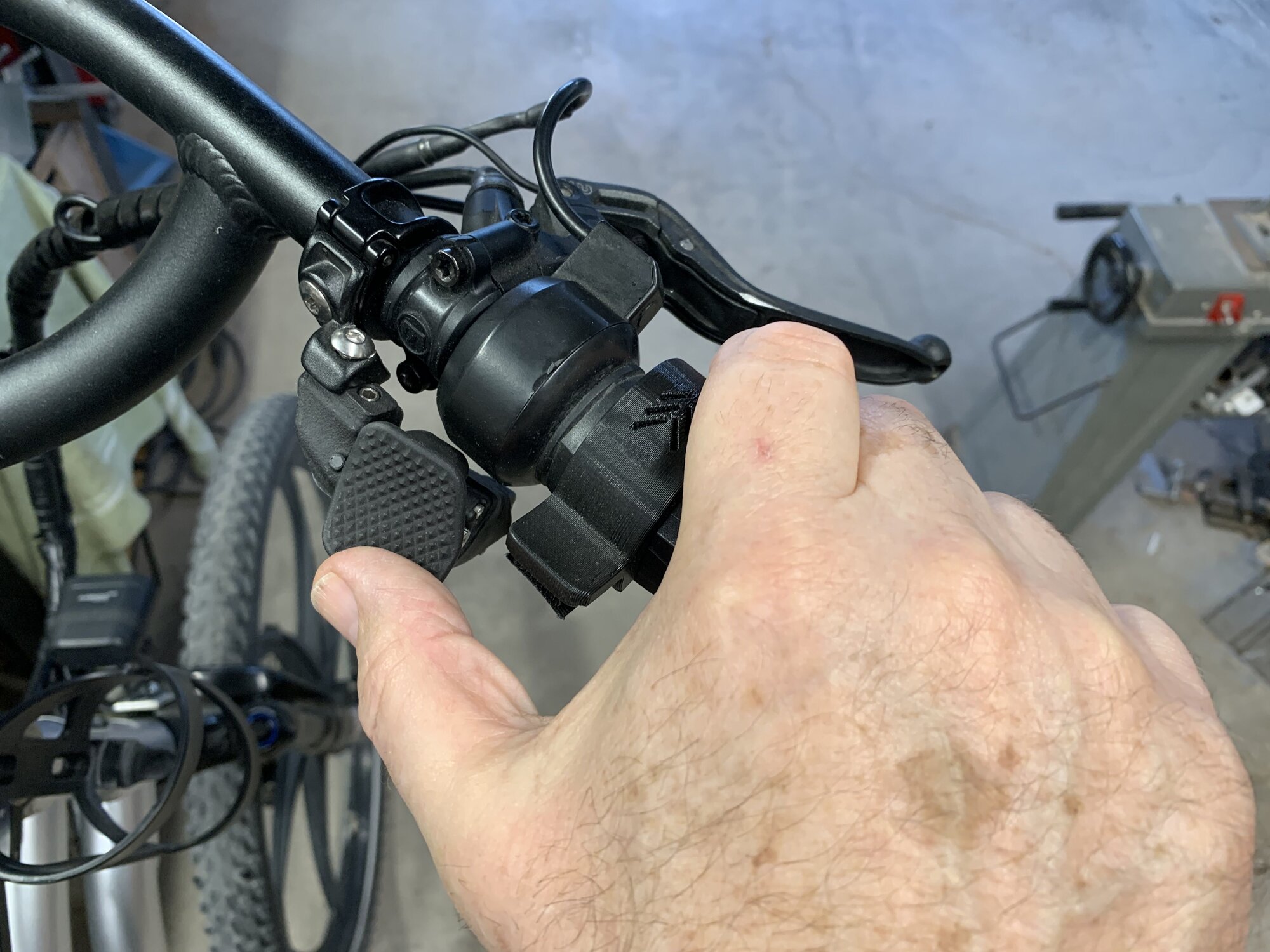

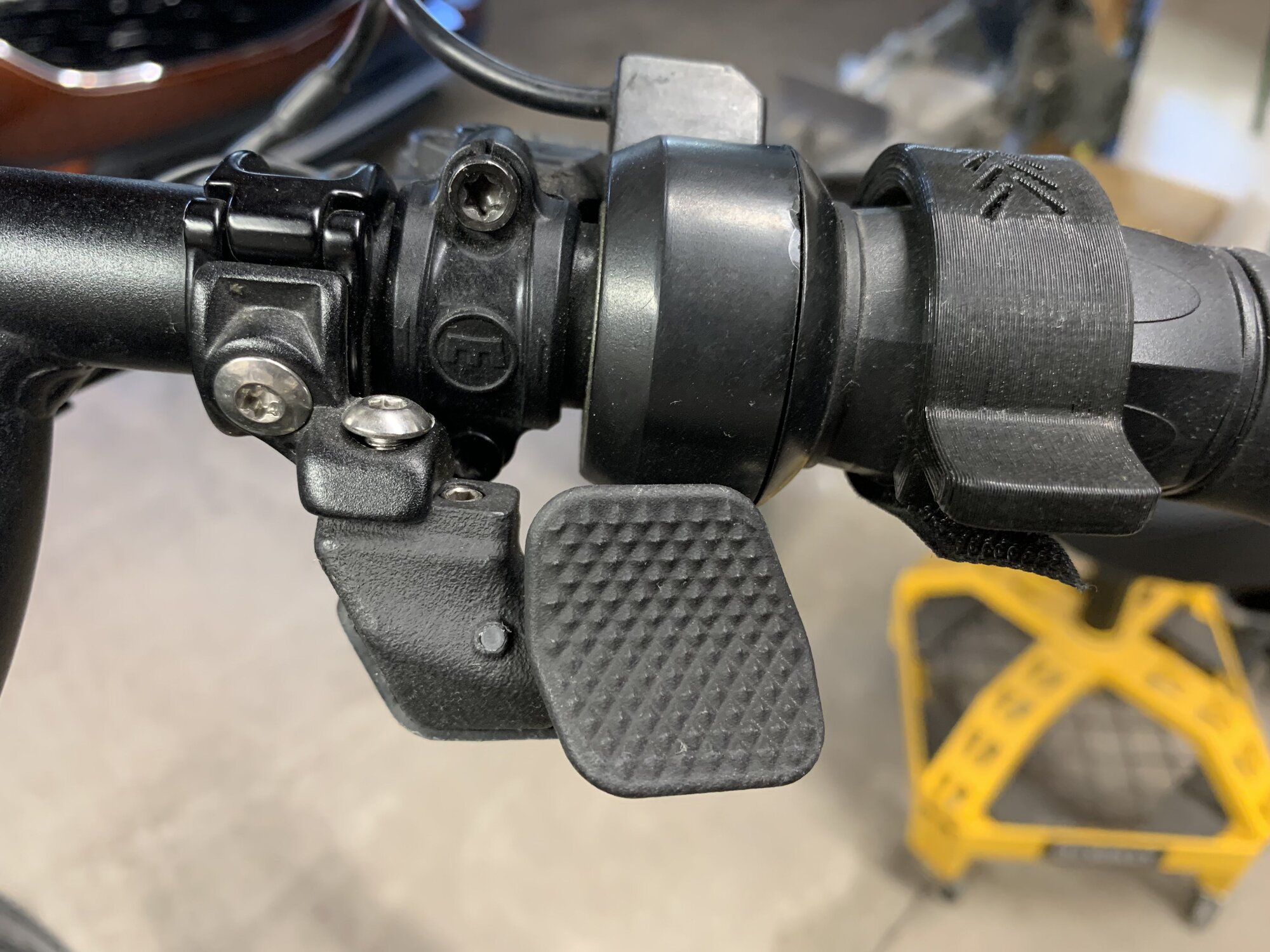

I also replaced the push button handlebar remote with the paddle shifter. The push button model was a stretch to reach with my thumb. The paddle is easily reached without loosening my grip on the bars. The remote's internal battery can be recharged while riding if necessary via the bike's USB port.
Installation with my Shimano 10 speed derailleur took around 20 minutes including the app setup time.
