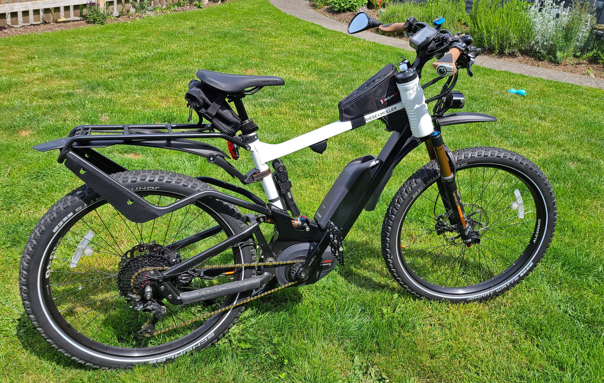

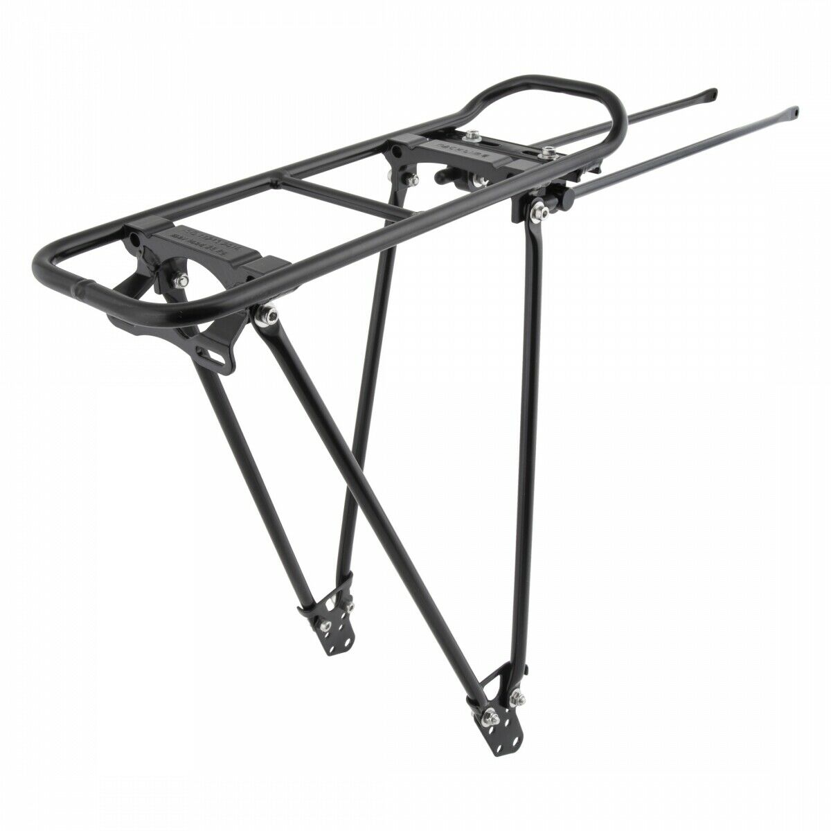

I am looking to convert an integrated Riese & Muller Delite Mountain rack with no racktime fittings, to be able to accept the Racktime bag and basket that I used on my Homage, which is being sold soon.

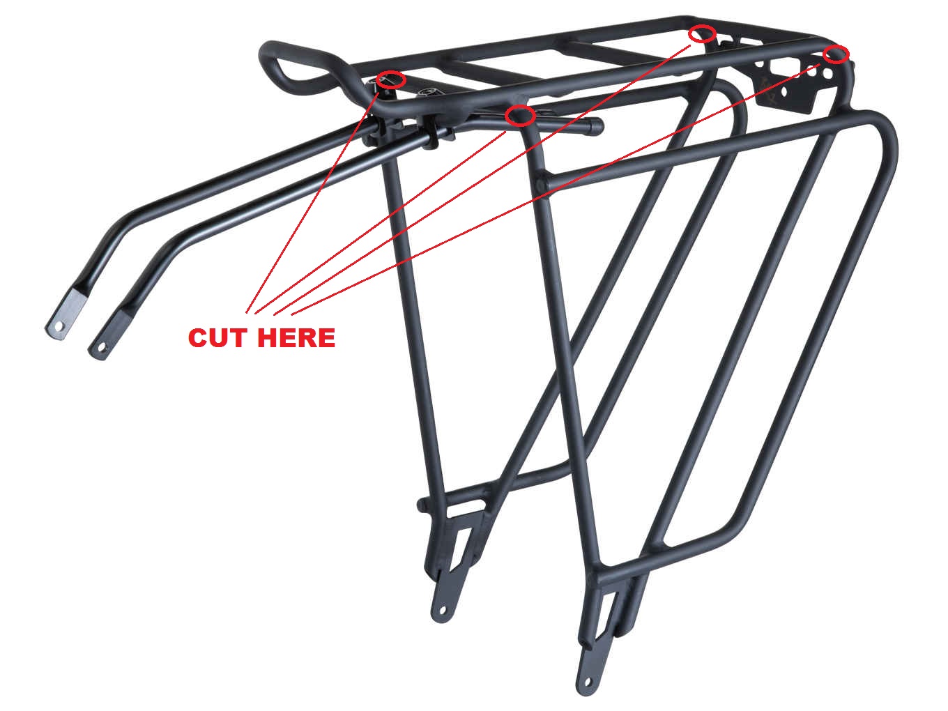

I am thinking of picking up one of these, scrapping the mounting legs and license holder and working our a hardware system to securely fasten it to the top deck of my existing rack.

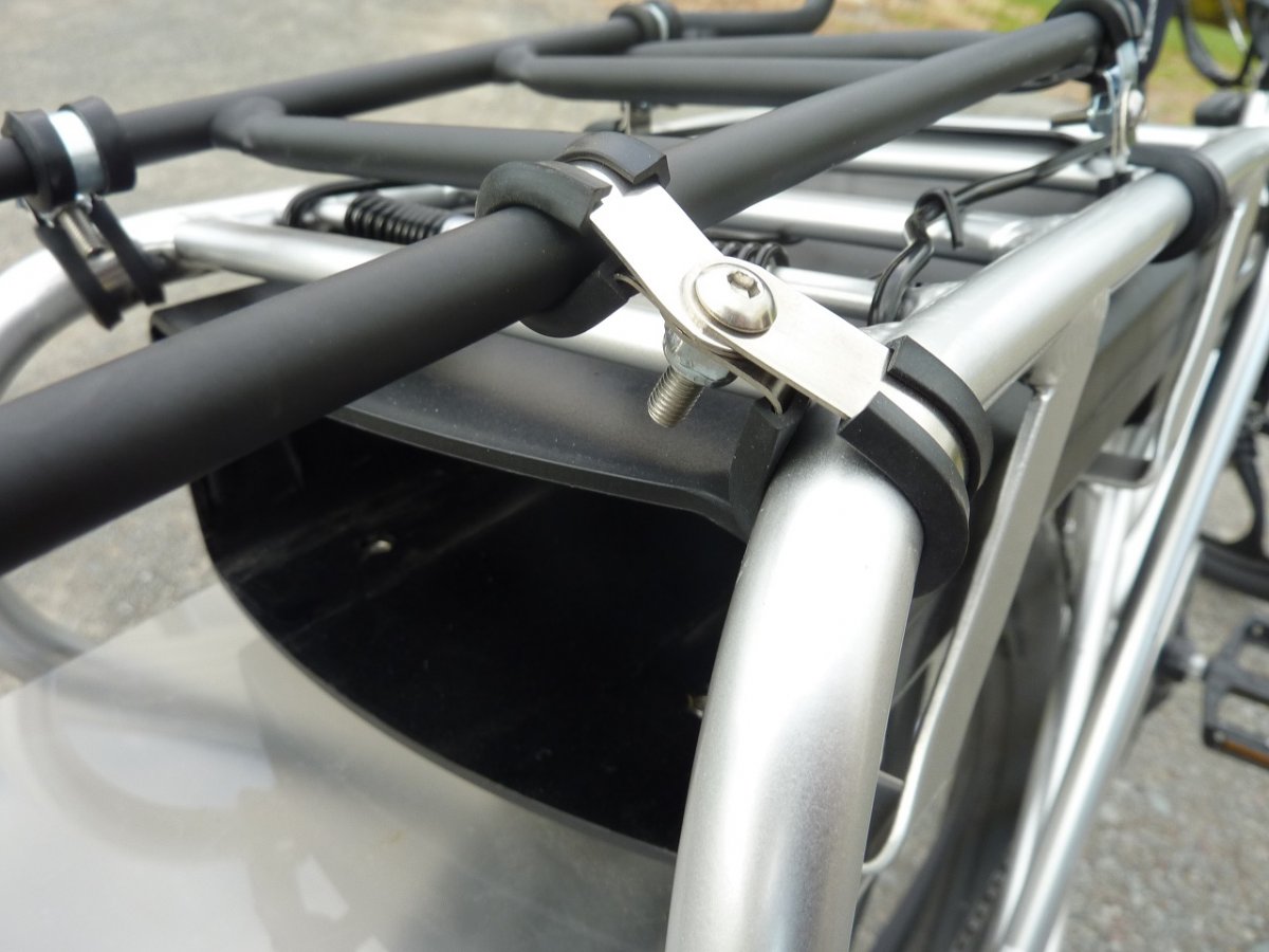

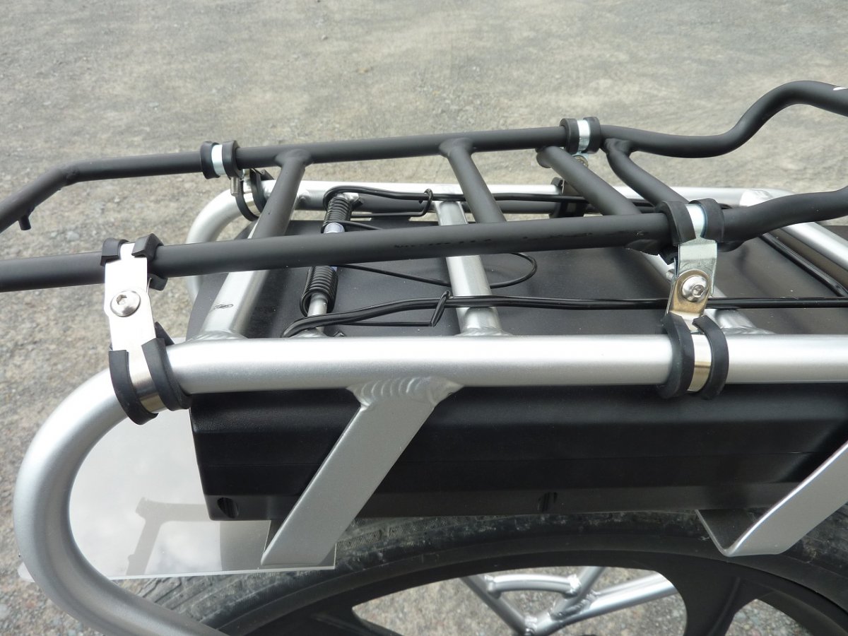

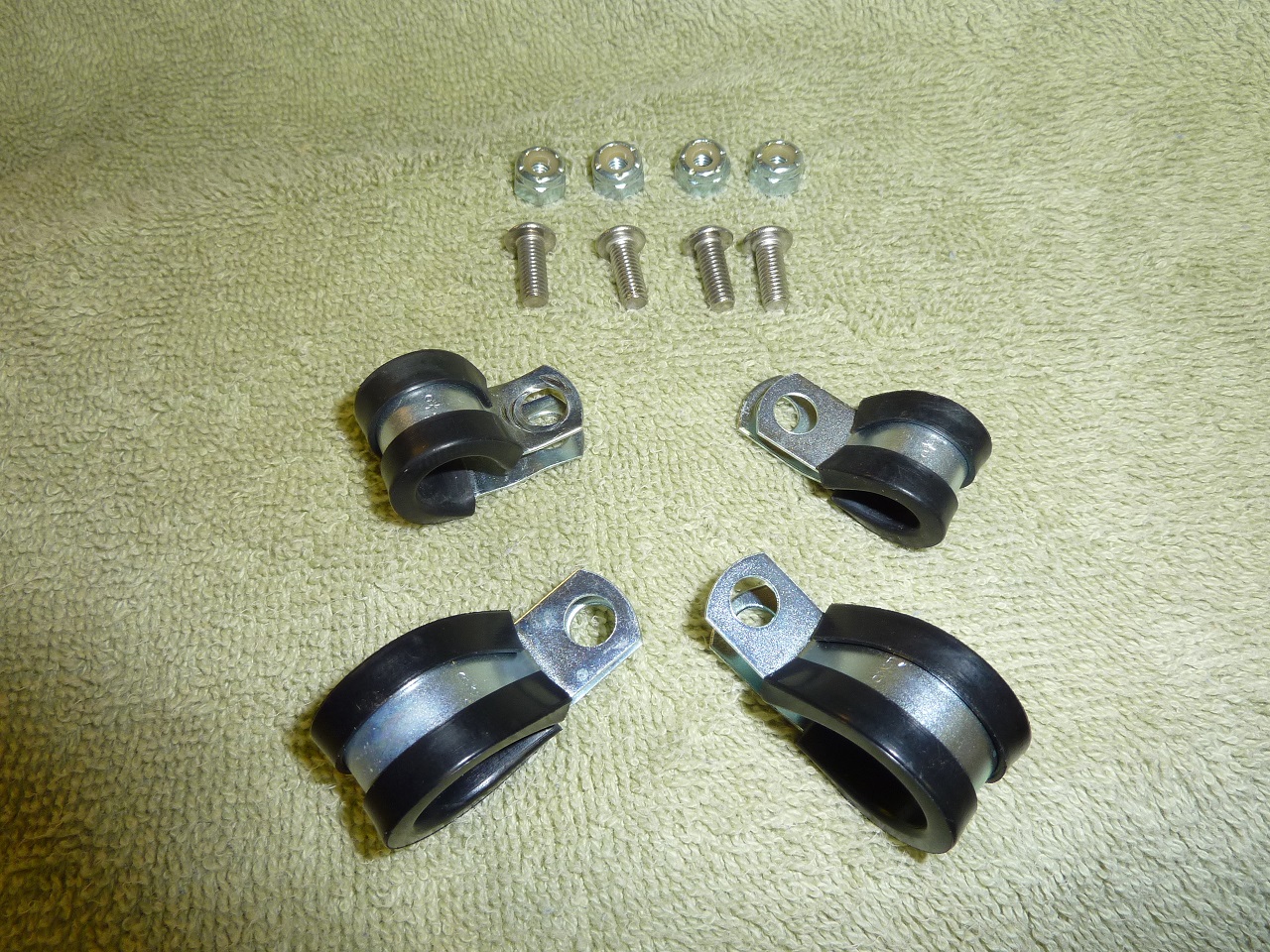

I used a similar approach to attach my collection of Bontrager Interchange bags to my e-bike rear rack. These insulated cable clamps work very well. They are sturdy and don't mar the bike finish:
View attachment 88716 View attachment 88717 View attachment 88718 View attachment 88719
WiMas 50pcs Pipe Clamp Rubber Cushioned Stainless Steel Cable Clamp Mounting Pipe Clamp Insulated Cable Clamp 1/4'', 5/16'', 3/8'', 1/2'',5/8'' for Tube, Wiring, Cables, Pipe, Rack, Line Restoration - - Amazon.com
WiMas 50pcs Pipe Clamp Rubber Cushioned Stainless Steel Cable Clamp Mounting Pipe Clamp Insulated Cable Clamp 1/4'', 5/16'', 3/8'', 1/2'',5/8'' for Tube, Wiring, Cables, Pipe, Rack, Line Restoration - - Amazon.comwww.amazon.com
It isn't pretty but the scheme has worked for 3 seasons and over 3000 miles without any issues.
