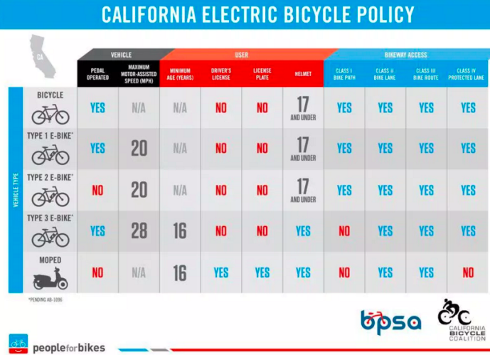

There is no difference in permitted use between Class I and Class II bikes in any of the states that have adopted that law configuration. Only Class III with throttle have no recognized access.
While true, Philly needs to be aware of certain locales (such as New York City) where we’ve seen the authorities crack down on certain bikes that have throttle assist.
