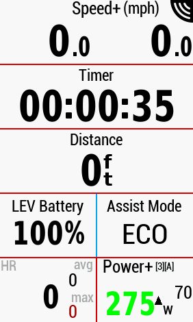

I have used a 3rd party app with my Garmin 1030 on the initial data screen.
The field is easily configurable and I pared it down to the only 2 fields in which I have interest (remaining battery and assist). Basically, this is the only data I would get from the TCU but in a more easily readable and precise format. With remote buttons installed I do not need to remove my hands from the bars or eyes from the cockpit, both of which occurred when I previously changed the assist level. For me, the new TCU would not add much.

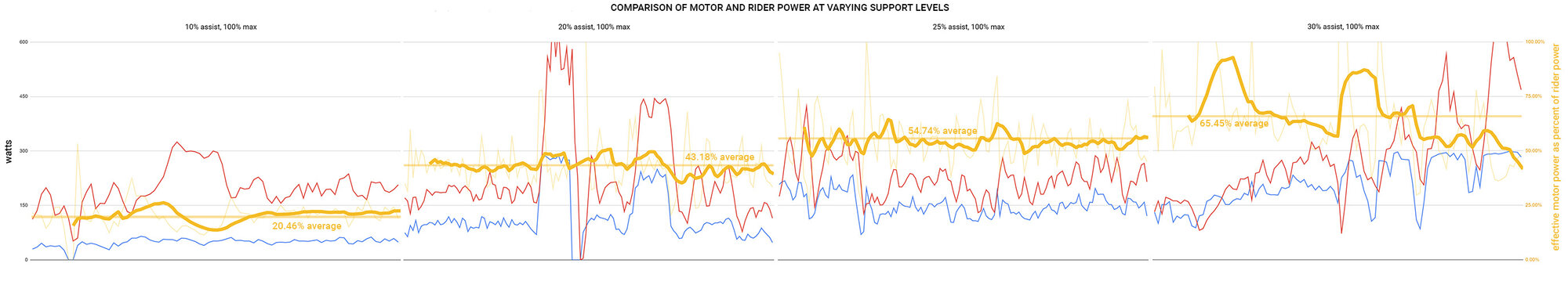

this image shows measured power values on my creo compared to assist settings - it’s pretty clear the assist ratio is at least twice what the percentage implies. on a levo it would be more like four times…

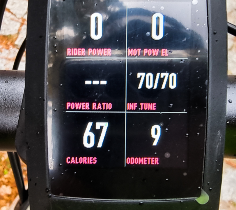

@mschwett has explained that very well. There is still some misconception because of Specialized "2x" which is purely a marketing thing.
  • The Boost Factor of the SL1.1 motor is 1.8x. "It's 1.8x You!" but that wouldn't sell, would it.
  • The efficiency of the SL1.1 motor is 0.79. The electrical motor power as reported by either MC or BLEvo has to be multiplied by 0.79 to get the mechanical motor power.
The proof. See the Biker Power of 132 and 134 W. The rider's power than makes the motor maxed out is -- as I said -- 133 1/3 W. (The data come from BLEvo. Can Mission Control produce historical data sets?)
Specialized are very explicit about what the measured Motor Power figure is in their latest Mastermind TCD-w. It reads "Motor Power Electrical" in the Power data page.
Mastermind TCD-w can even display the Boost Factor (Power Ratio), only that's referring to the Electrical Motor Power, and the maximum boost related to the battery power draw is 2.2x. However, the Electrical/Rider power ratio is not what the rider gets in the chainring (it is the mechanical power).
