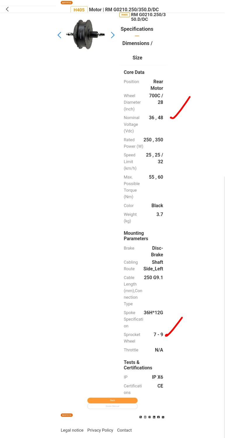

Where are you reading the voltage description?
On the motor? Controller? Or the Bafang website?
Your motor's voltage rating should be printed on it.
If you are only reading it on the Bafang website... It's two different motors.
Take a look at the punctuation.
Comma denotes a different motor.
If it were a range in the same motor it would be written with a hyphen or a forward_slash ... Like the sproket size and speed limit.
